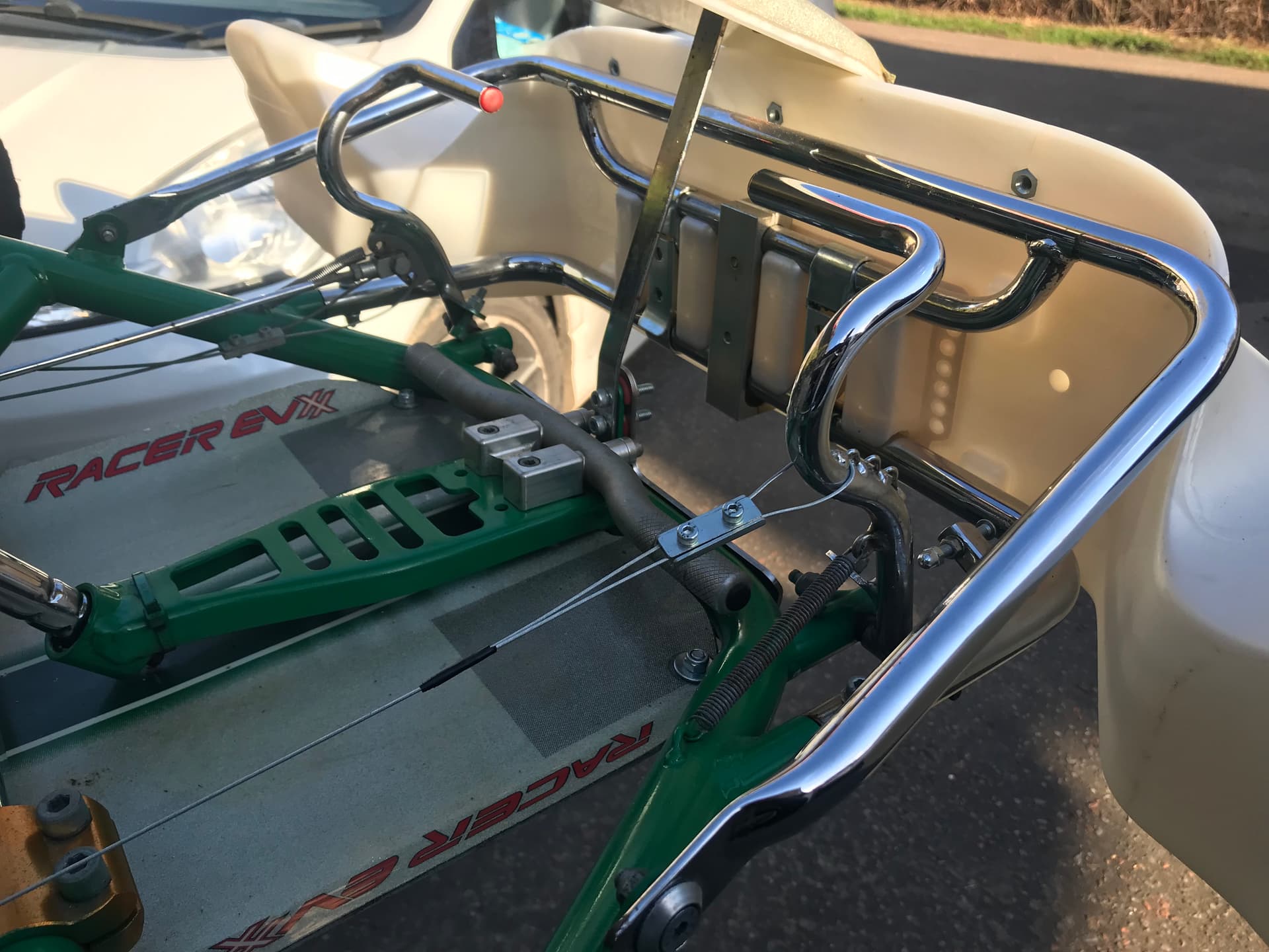

Hiya, I am looking for some much needed advice before I take my kart to the track. I am 6 foot tall (closer to 6 foot 1) and slim build, I have a 2009 tony kart evx running an old style tkm bt82. My problem is that I don’t seem to sit comfortably in the kart, my legs are bent and too close to the steering wheel and my arms look out of place compared to others, I have tried moving the seat back but this is what I feel to be the furthest I can seem to get it without effecting the kart. I don’t exactly want to have to buy a new seat but I have heard that jecko seats are better for tall people, I am also looking into getting a longer steering column as the one I have is 470mm and ones like a 510 or 550 might be better, but I was not sure on if this would be a good idea as it would move the steering wheel higher but it might effect my arm positioning as you can see they are already close to the engine, hence why I came here for advice. The pedals are as far forward as they go and I am not keen on getting a front porch for the kart! Advice and setup tips would be much appreciated, if anymore info is needed then feel free to ask. Photos attached!

Thanks for the response, I will look into these, by move the pedals forward did you mean the angle of them? As they don’t seem to go any further forward, I am new so it might be something I’m missing!
Yes, Lindsay means angling them more forward. You can use this bolt/stop to change the angle of their fully returned location. Then just change your throttle cable length or adjust your brake rod. I like mine so far forward that they almost hit the front bumper when fully pressed.

Edit. Noticed in your photo you have your heels back. Toes forward. You will drop your knee height quite a bit but pushing your heels up to the heel bar. Which will make you want to move the pedals forward to be more natural position of foot.

I am 6’2” , all legs, and drive a OTK. You can move the heel stop forward by swapping the spacers that are currently in front of the bar to be behind the bar. That will move it towards the front of the kart. I wouldn’t recommend taking it out completely. I tried that and I had zero way to brace myself in the kart. My feet would bounce around over bumps and curbs often too. I just have the rest as far forward as I could get it which puts it even with the front frame tubing.
Definitely use the pedal stop adjustment bolt to push the pedals forward. You may need to adjust the throttle cable afterwards. Also, you might need a longer brake rod.

Like the others said. Flip the heel stop bar so it bends away from you and swap the spacers from in front of the stop bar to between the stop bar and the mounting block.

Once you have your knees down below the wheel, you can start making adjustments to the pedals to fit comfortably. Because your knees will still be bent, you will want to have the resting position of the pedal ahead of your heel stop. This willl allow a more natural angle for you foot to rest without putting pressure on the pedals when not depressed (i.e. dragging brake or accidently blipping the throttle when cornering). Throttle side is fairly easy, just adjust the cable length. Brake side may require a different brake rod or adding an extension.
