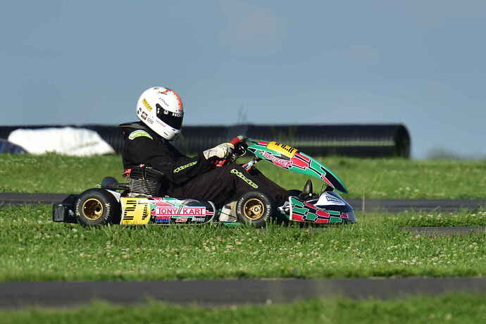

193cm is very doable! Thats 6’ 4" in American units.
I’m a few cm shorter than you but I haven’t found a kart I can’t fit in yet. My legs are always the highest and most bent but I’m used to it by now.
Another from many years ago
Derek is one of my favorites .
Don’t know why . But it sure is
Epic!

What chassis was that? Wheelbase?
Did you have the seat pushed right back and pedals right forward? (totally get it wasnt your kart - just curious).
If I fit in my kart like that, I’ll be stoked!
I believe the chassis is OTK. Not sure about wheelbase. I didn’t make any adjustments, though I’m sure the owner is not as tall as me. Most of my height is from my torso. So pedals are OK.

The first picture is a Comet Eagle. The second is a Margay ignite.
