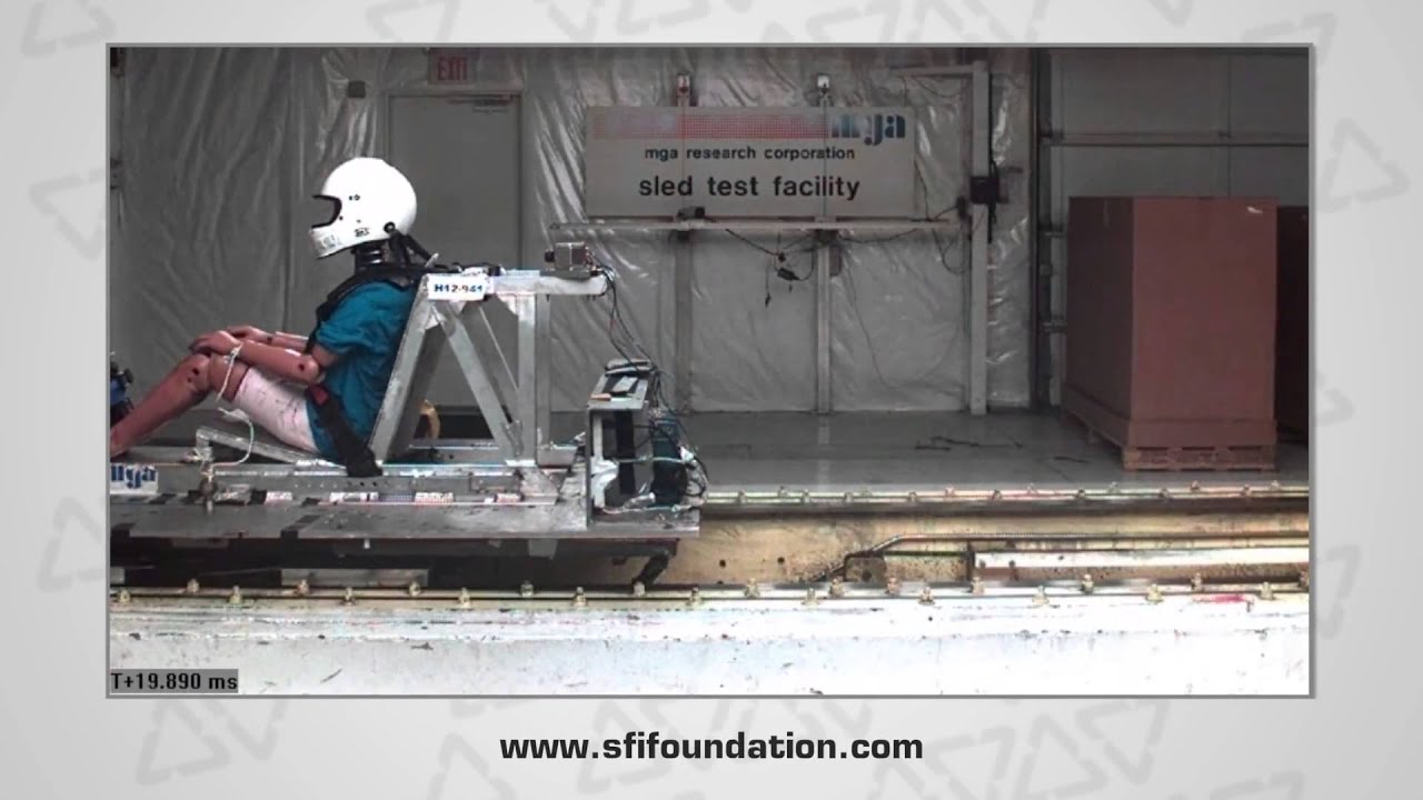

I have focused on the Leatt KART neck brace because it makes the most sense to me and because I was wearing one in my 50 mph barrel roll flip (more on the relevance of that later). The only other brace I would personally consider is Valhalla’s 360 Plus, also designed for karting
I believe the Great Lakes EMS study on neck braces in motocross is valuable. I assume (but do not know) that all neck braces they referenced were rigid. Sorting out accidents with or without a neck brace, they used 2 filters: (1) Injuries to the cervical spine or to the clavicle ONLY. Then, (2) injuries requiring, as a minimum, medical evacuation. With those filters in place, I believe their numbers are significant.
I do not understand the reference to whether or not motocross riders or kart drivers chose to wear or not to wear a neck brace. Are there many, many riders/drivers who were not wearing neck braces and who walked away from accidents? Absolutely. The EMS paper simply covers the ones who did not.
I do not understand the reference to a fulcrum when wearing the Leatt brace; it is specifically designed to eliminate that risk.
From their User Manual:
“The design rational behind the Leatt-Brace is to bring the head to a controlled stop. This is achieved by providing a padded rigid structure that acts as an alternative load path for neck forces. Helmet impacts otherwise transmitted from the helmet to skull and then to the neck are re-directed from the helmet to the brace to other body structures in a safe way. The design of the Leatt-Brace prevents the helmet/head from projecting over the brace and therefore prevents a fulcrum action, which has been documented in literature pertaining to the use of collar devices.”
From the post by LJ Cordony, The Leatt video documents their approach to testing in detail. I believe that this information, coupled with the Great Lakes EMS study on motocross accidents, and detailed anecdotes on kart accidents will be the best information available until long after I hang up my helmet (and Leatt neck brace).
