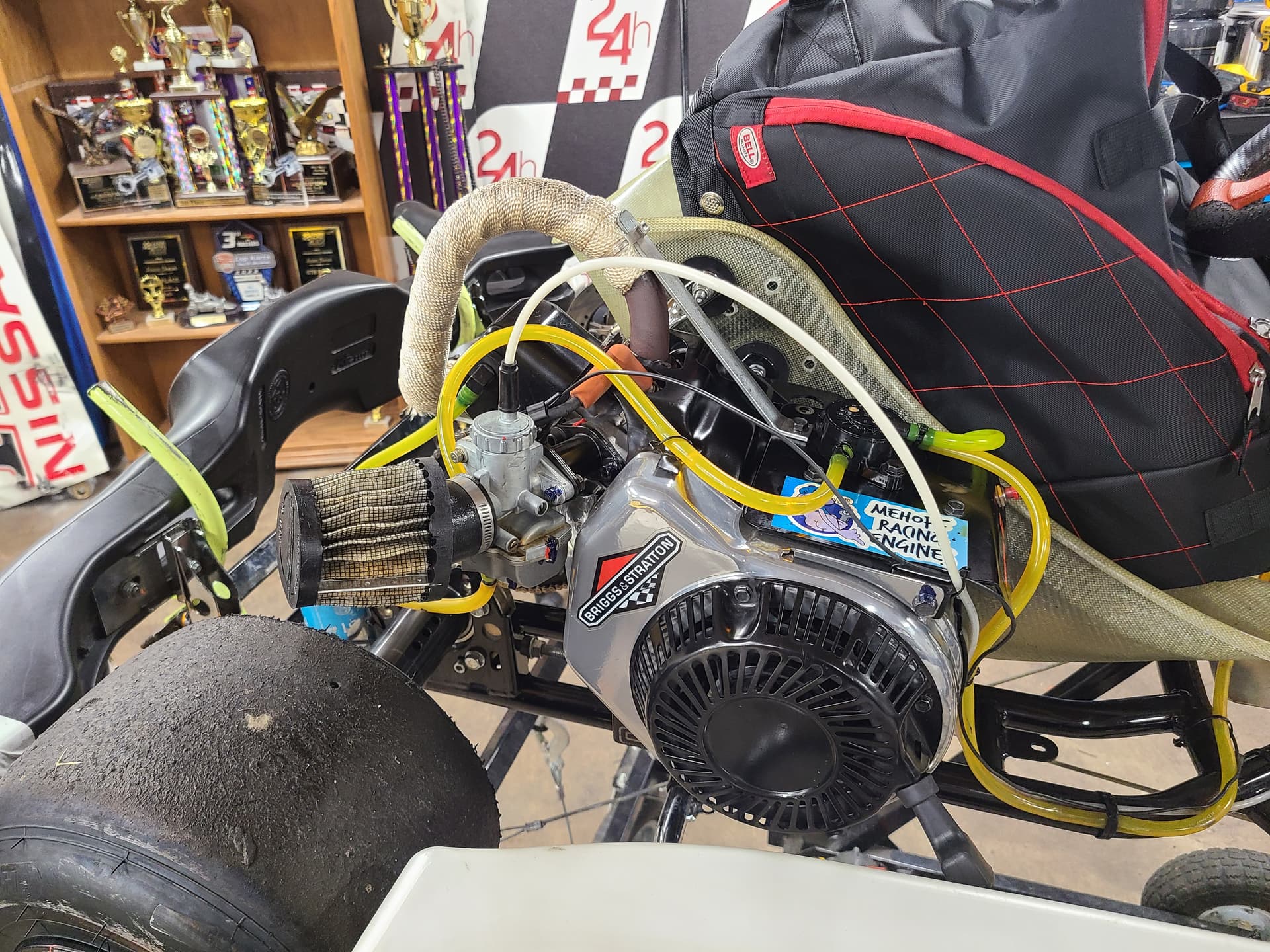

MEHOFF builds my engine because no one beats them.
