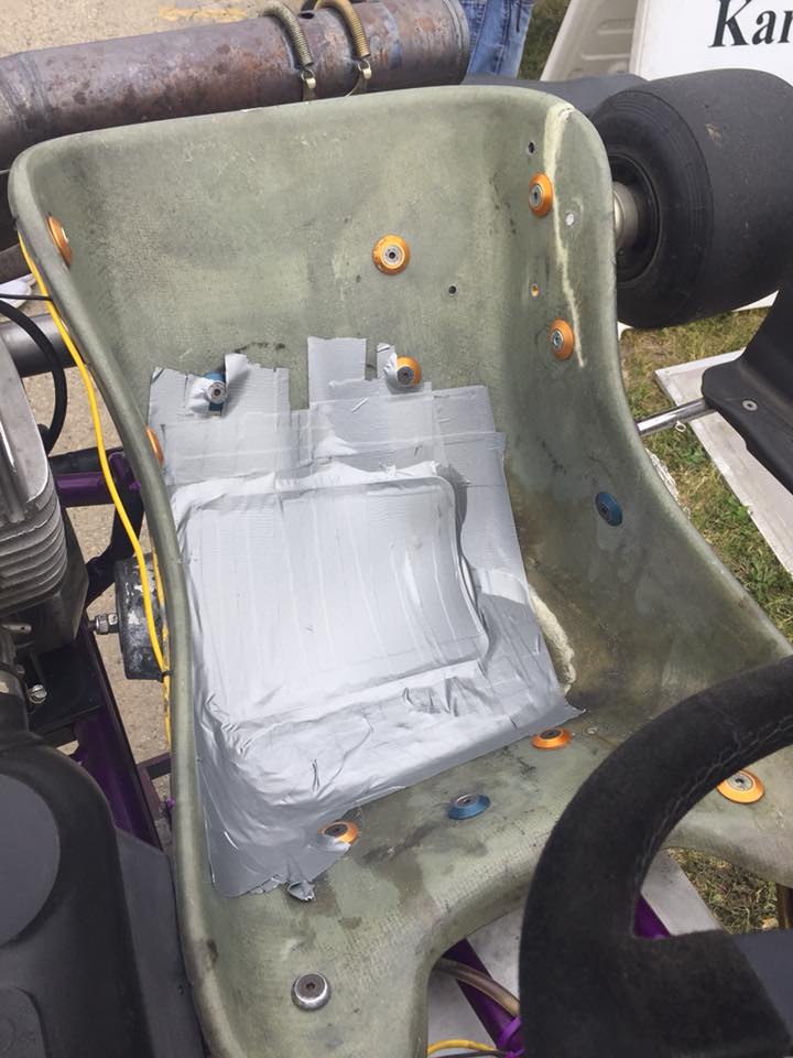

Nothing is as ugly as our quick, but effective, patch job last season to get us through the feature. Surprised how well a number plate and duct tape can do in a pinch LOL

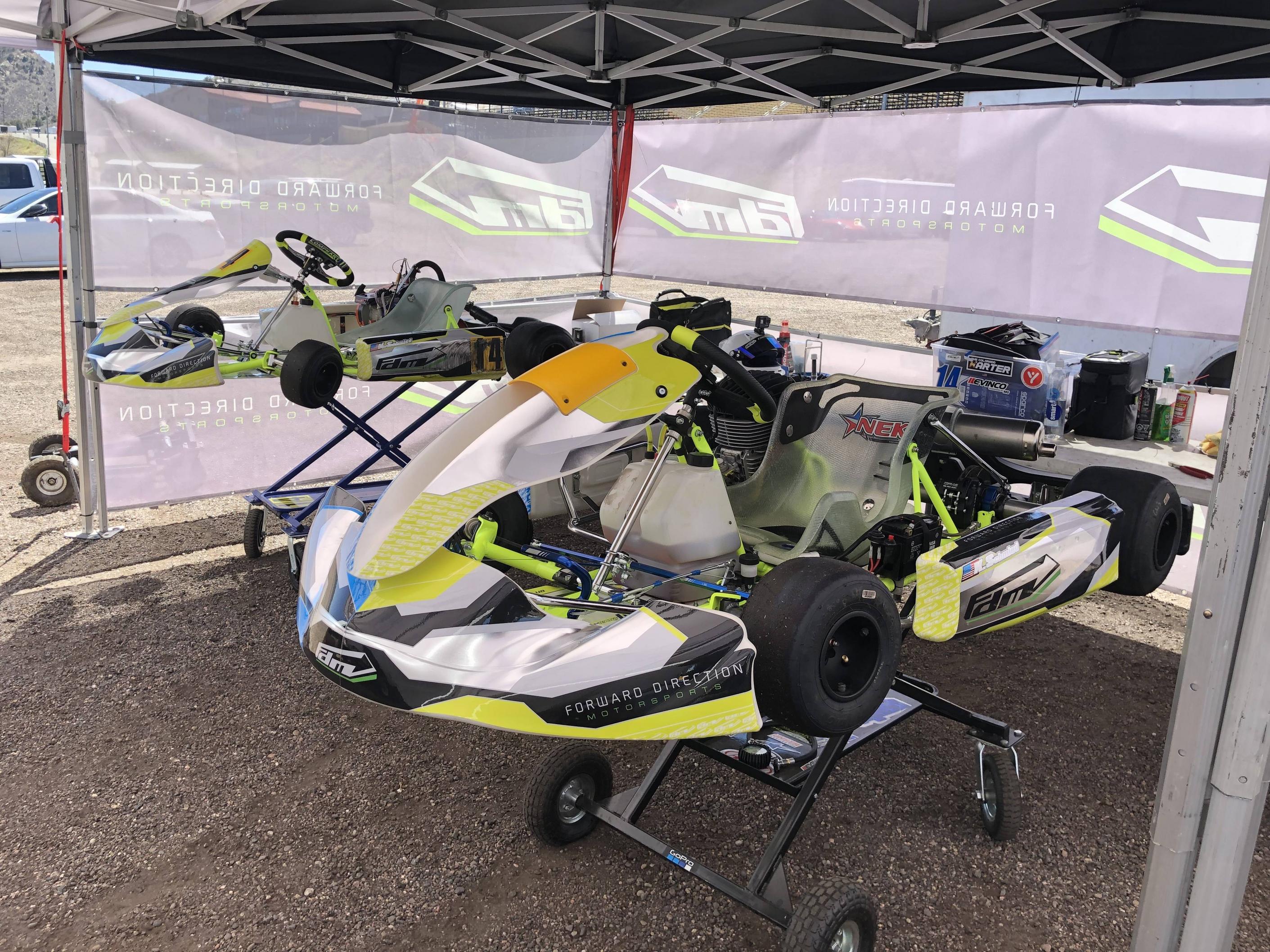

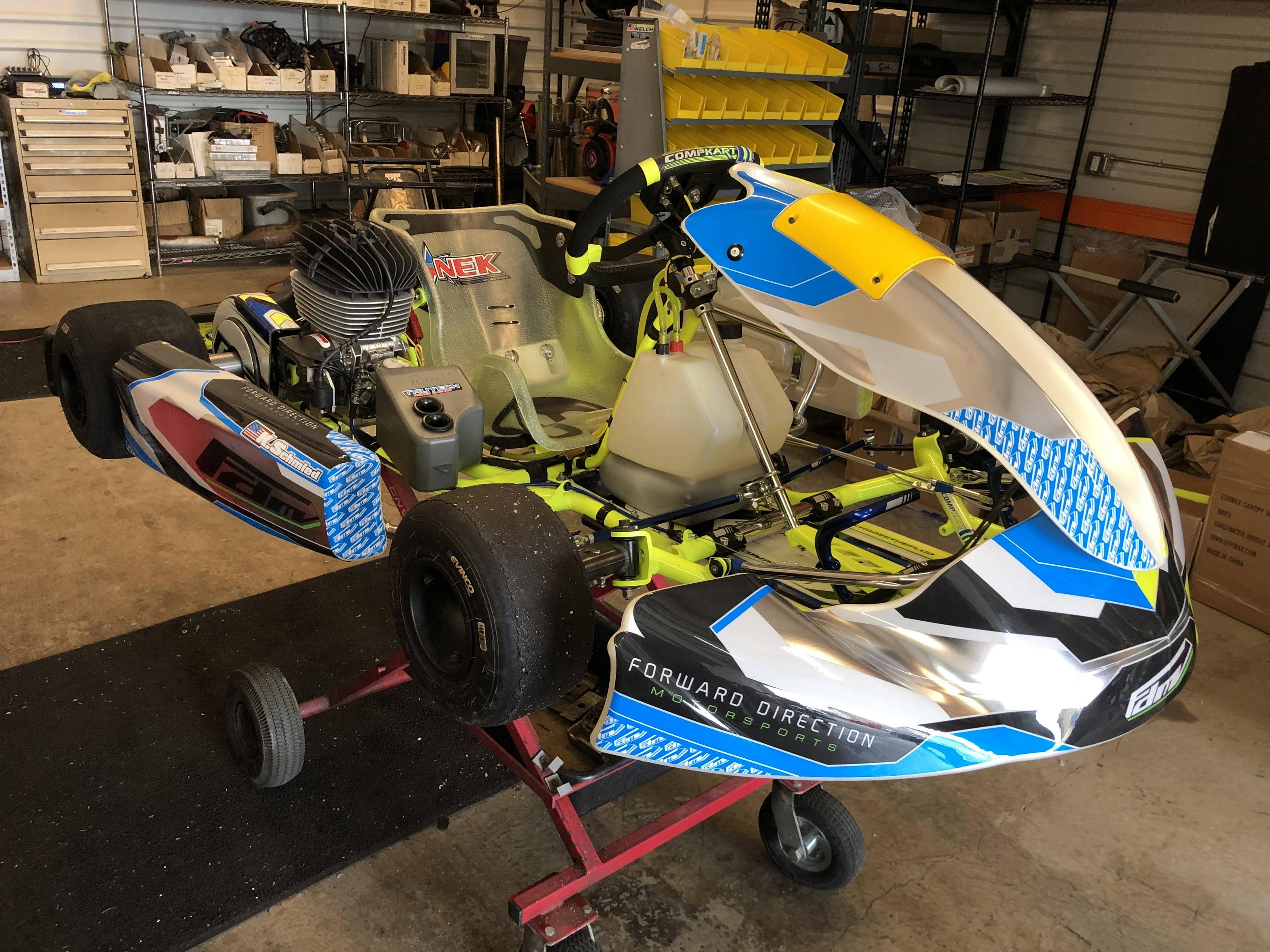

I just got a NEK installed in my KA while refreshing it for the upcoming season. Shaking it down tomorrow and will give my impressions. Sitting in it while sitting still, I like that it’s taller, a bit more deep, and the leg supports feel neat. Not sure if I like how large the flat area is for your ass. It doesn’t “cradle” your bum as much as a typical seat might. I’ve got some thin rubber padding to give some grip in the ass if I start sliding around any. I’m hoping this makes my KA a little less brutal on my ribs than it was last year.
I was surprised how much the KA affected my ribs… Stock Flathead briggs, not so much. :slight_smile:
Thought I’d give my impressions since I had about 50 laps in the KA today with the NEK seat.
The leg support doesn’t do as much on-track as I’d hoped. Perhaps because I’m in a size D3 seat so it’s a little larger than normal, but once you’ve got your feet on the gas and brake and properly extended, I rarely noticed my thigh touching the side of the seat. I even tried to use the support on one lap and it felt too far away to make a difference. I’m 5’8 so that could play a role. I have a small-ish waist but a broad chest that requires a little more rib room. Seat felt nice from a handling standpoint. I like that it’s deeper and a little taller, but I don’t like how big the flat section for the ass is. I have a pilonidal cyst and today was the first time I’ve irritated it in quite a while. The flat bottom area is just so large that there’s no way a normal person’s (I weigh 155 lbs) ass would be cradled by it, meaning lots of room for movement. Not only did my cyst get irritated, but my hip bones got destroyed as well. I think the seat is just a HAIR too big for me, but the next step down is about 1.5cm smaller which seems like a big jump. I was able to solve the ass issue by putting some 1/4" foam padding in the seat basin, slightly behind it, and a bunch in front (to effectively create more of a cavity for my ass), but the damage to my cyst and hips had already been done.
I’m going to pad the area by my hips and add a SLIGHT amount of padding to the rib area to make the seat fit a bit more snug. Unfortunately after how badly I irritated things today, I think I’ll only be driving the LO tomorrow in practice. I’d say, it’s not a bad seat… but man that ass area is WAY too fucking big. I’d love to follow up after the race this coming weekend, since I am hoping I’ve resolved the couple of issues I faced with it today.
Ribs are fine. But a lot of that is probably due to me losing 20 lbs over the winter and getting much more in shape for this season than I was for last season. It seems I’ve traded rib pain for hip and ass pain :confused:
