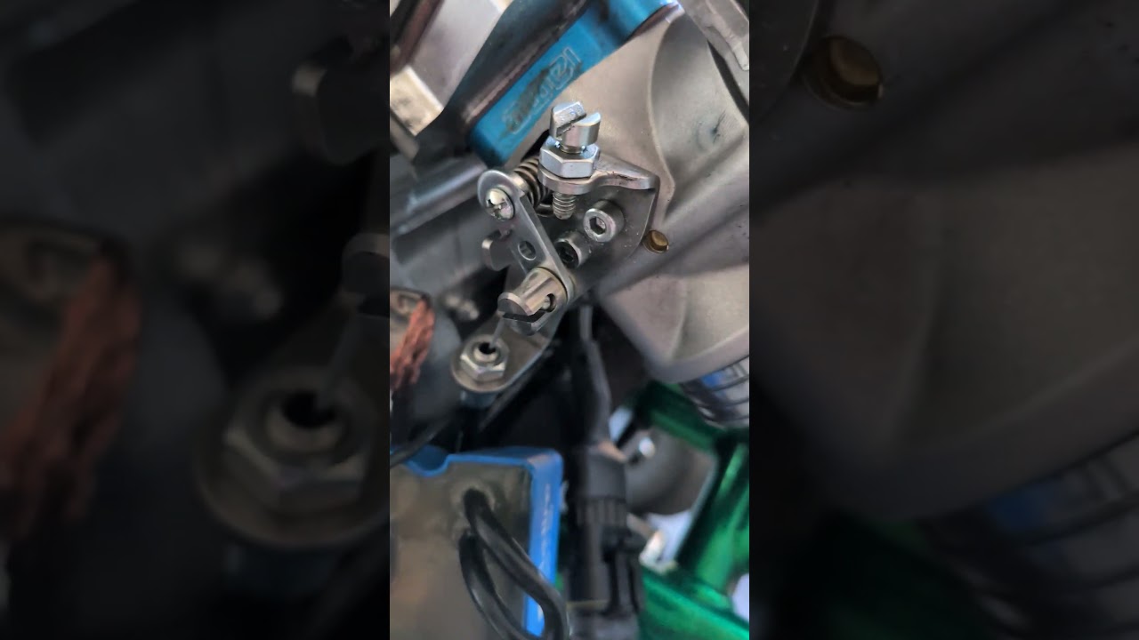

I just got a Super x30 with the Tillotson HB 10A carb. I’ve snapped 3 cables with it now and replaced the arm on the carb 3 times. I thought the first two might be faulty, but now the third is the same. Basically the part that holds the cable won’t spin like it’s supposed to.
Any idea how to fix this? Someone that the track had a kit that held the cable in a totally different way. But I didn’t ask where they got it and I couldn’t find it anywhere. Apparently they had the same issue.
Mobil Centaur 462 grease on the pivot and not cranking the screw holding it on until the Phillips head cries uncle.
