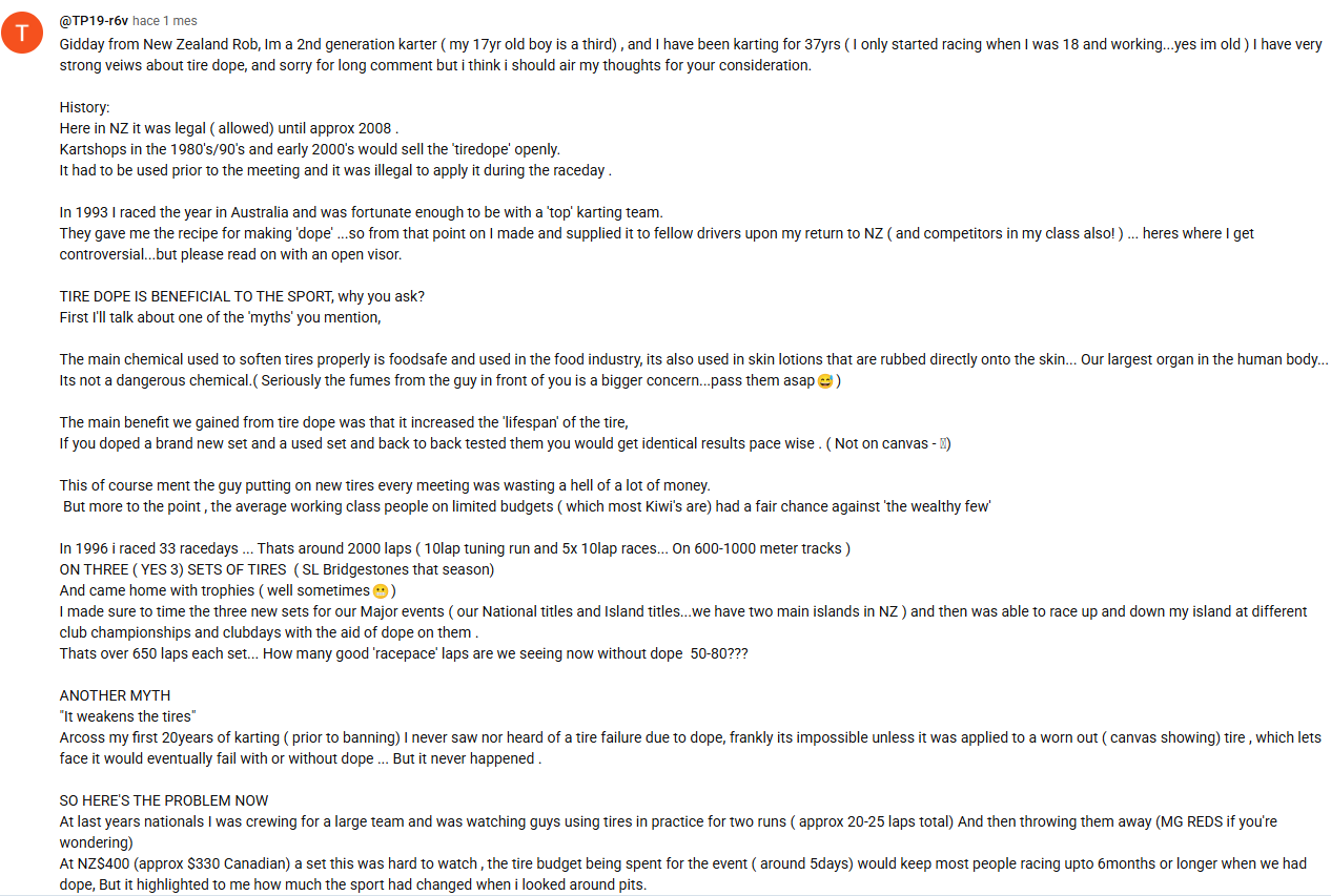

Then I stumbled across one post on a youtube vid, a guy from New Zealand, who claims to have doped the tires to maintain the grip level as it was used, etc. ANYONE has a clue who he is? or what does the “dope” consists of? He goes by the name TP19. Please if anyone knows the “recipe” or this guy, or has a lead to him, let me know. Thanks.
I know of no asphalt series that allow doping. It would be impossible for tech to determine between doping that is to make tires softer than original and doping that is attempting to extend life of tires.

Since you’re not wanting to soften, just extend the of the rubber you really need a “conditioner”. Something to add oils to the tire that have been cooked out. There are purpose made preps that do this, but the old school dirt racers often made their own. I’ve heard of diesel being used, ATF diluted in a solvent like acyrsol, even wd40. I use prep on the dirt, but have never on asphalt and I use pre made prep so I don’t have experience with the old ways.
