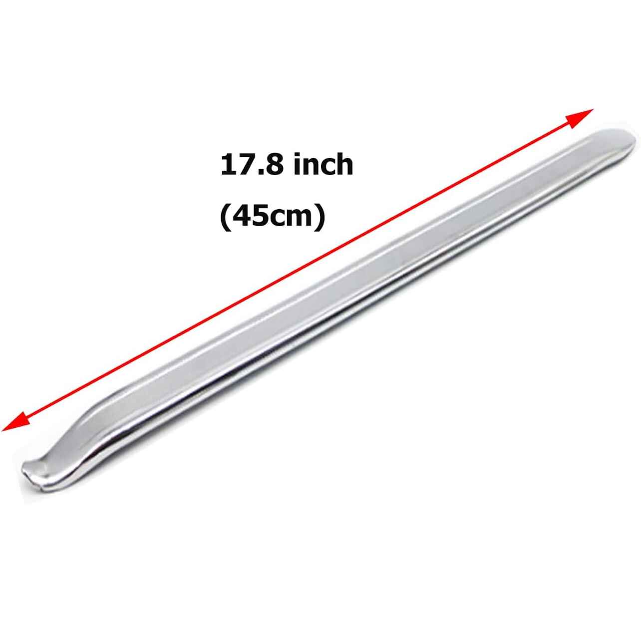

I use a bead breaker, the scissors, and 1 small tire tong (tong photo below). The bead breaker for popping the bead down, scissors to push the first bead off when breaking down and the second bead back on when mounting. I use the single tire tong to insert and pry the rim through when pulling off the second bead. I can do it by hand, but the tong gives my a bit more leverage to help roll the rim through that bead. For mounting the first bead I try to roll the rim bead through the tire, if the tire starts to collapse too much before the rim goes through, I flip it over and grab the tire and push down and walk it on the partially inserted rim.
