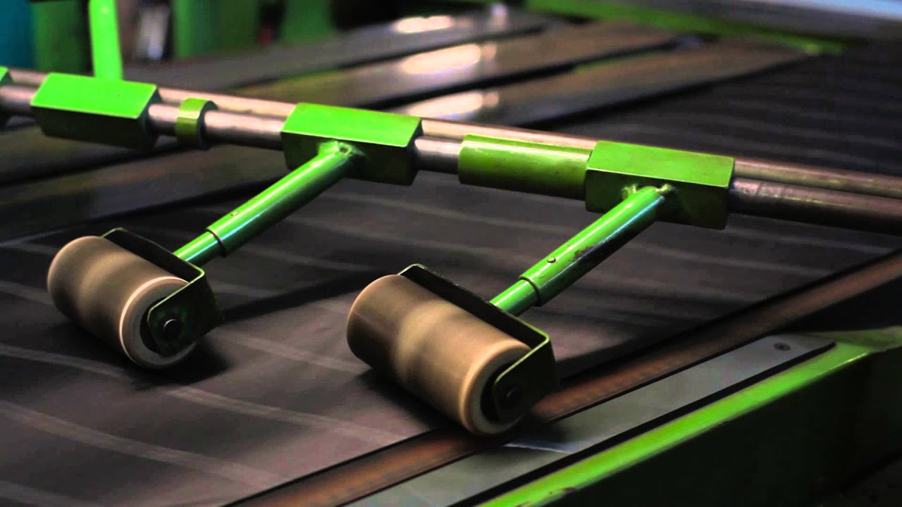

My understanding is that the direction is determined by how the tire is constructed, the direction of the belts. Here’s a video of how Mojos are made:
