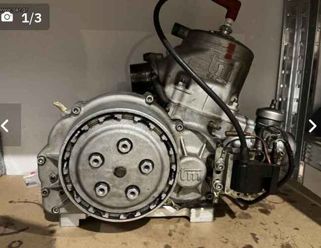

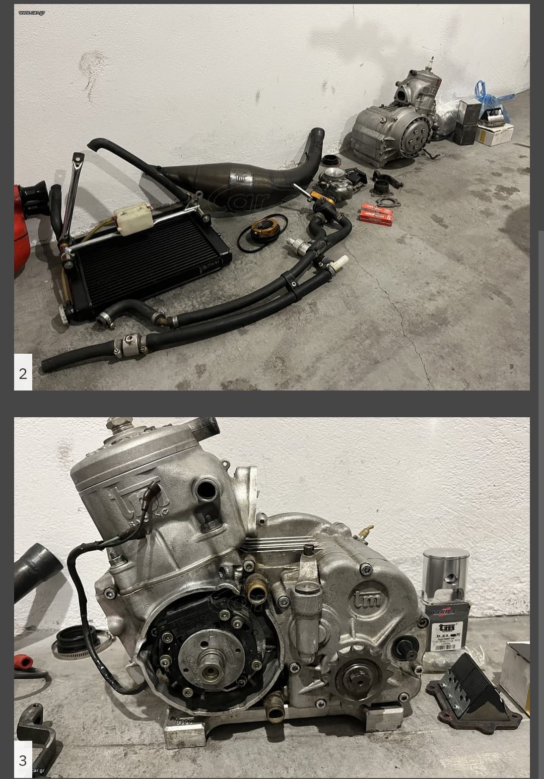

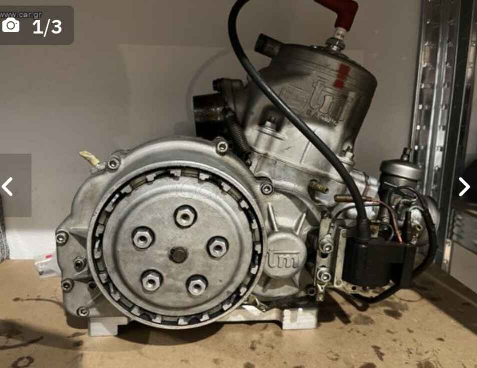

Tm k8 with k9 barrel oppinions as a first kz step
I have found an engine on our used ads here and it seems like a decent package for our first step in the kz category .
The owner said that this is a k8 engine with k9 cylinder and crankshaft in it . And the price at 1000 dollars seems honnest .
Is anyone has one of those or had one in the past and can write down some oppinion about it ??
Is the k9 a nicasil type barrel ?
If it is this is the first thing i need to check before buy something like that .
I will run a full service if i got my hands on it but i wanna hear what you have to say about the engine .
I believe it was popular when it was on its prime .
Thanks guys !
Nikasil bore yes.
That said, my 2c would be to pass on a K9 “A” unless engine your options are very limited. It’s almost a 20 year old model now. Yes they were great at their time, but definitely would be at a disadvantage to the newer models. I’d go as far to say as 0.4s, all other things being equal of course.
Thank you sir !!! Greetings from Greece!
Looking at cylinder it is a 9c may not be to bad for what you are paying newer of course can be better but we all start somewhere
Thank you glenn . I had put my engine on sale now to see what can i do .
