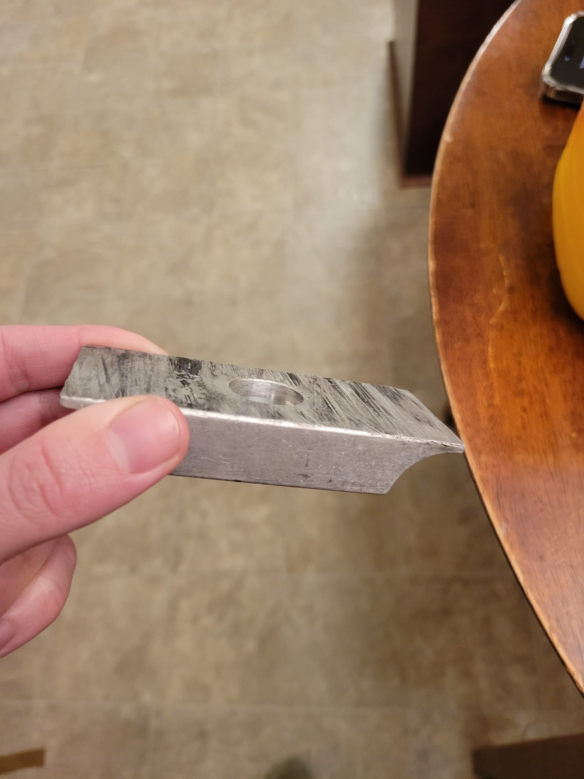

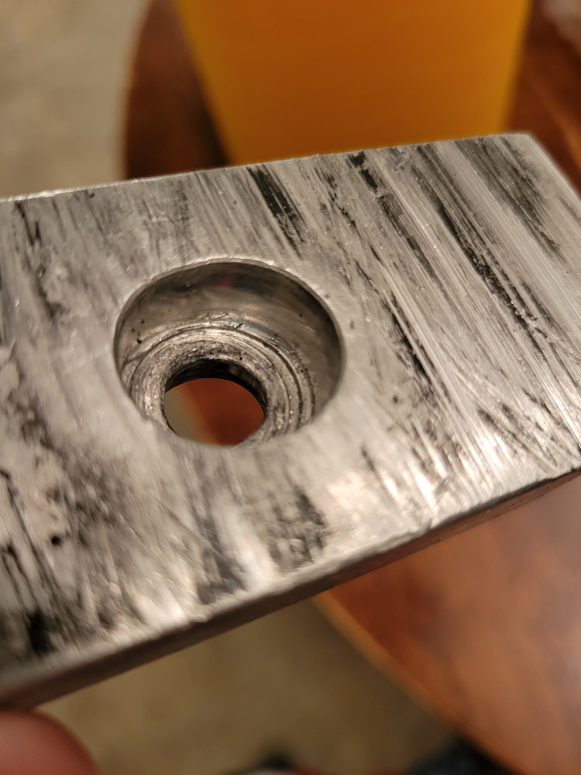

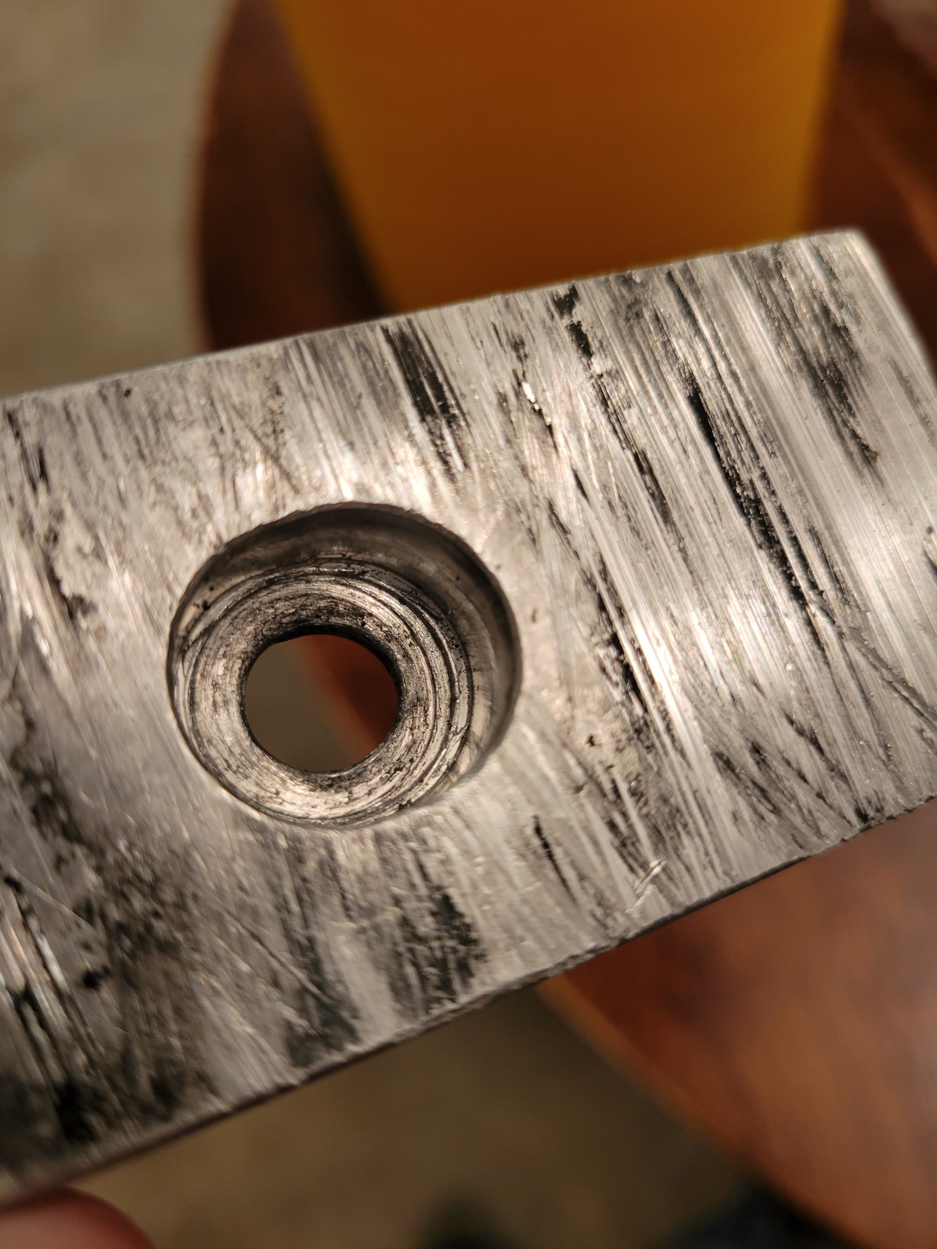

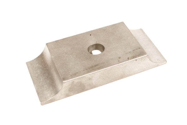

I could NOT figure out why my chain kept getting loose after just 20 laps. Upon inspection, it would appear that I overtightened my motor mount clamps and warped them. The hole is an oval, not a circle, and it shows ridges where the bolt displaced some of the bracket. I’m still not sure how the motor could move since I tightened the nut on the red ball adjuster screw as hard as I could with a 17mm open end wrench.
Which motor mount clamp should I order from Comet Kart Sales? I can’t tell which one I have and I am not too keen to order an aluminium clamp because aluminium is a softer metal (I think).

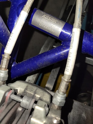

Based on this website, my frame should be 30mm:
So I could buy this and it would probably be the exact same clamp I have:
But is there an upgrade made of harder metal?
Birel make some steel ones, ive been using them for a while and the only wear on them is some road rash on the bottom
I always use Odenthal clamps if it’s a center bolt clamp mount.
Be careful with over tightening these clamps. You can start squeezing/deforming the tubes.

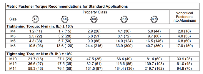

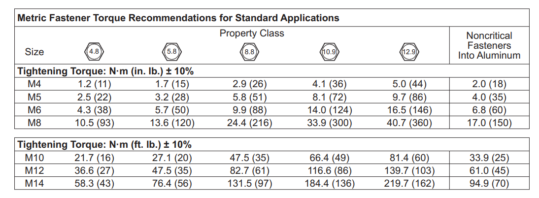

If you have no idea where to start, then use this table.
Most motor mounts are aluminum, so use the last column. Its not as tight as you think.
Search for metric bolt torque.
IIRC:
M8 is 19ft lbs
M10 is 37ft lbs
I use an Odenthal mount which has M10 bolts. So, I torque them to 37ft lbs.

@Chuck_Goodson did you strip the actual motor mount or just the clamps? I just ordered the Odenthal clamps, but I still have the stock mount.
I have flattened the chassis tubes over-tightening. I have damaged butterflies from over tightening and from coming loose. On the OTK stock motor mount in particular I stripped the holes out of the mounts 3 times last season. They just didn’t hold and came loose on track unless you tightened the :poop: out of em…but then you start to damage tubes, butterflies, or motor mount threads. With the JTP 206 mount that came with our first kart we had some issues, but nothing like with the OTK sock mount for the KA.

Butterfly is term often used for the lower clamp. The part you posted.
