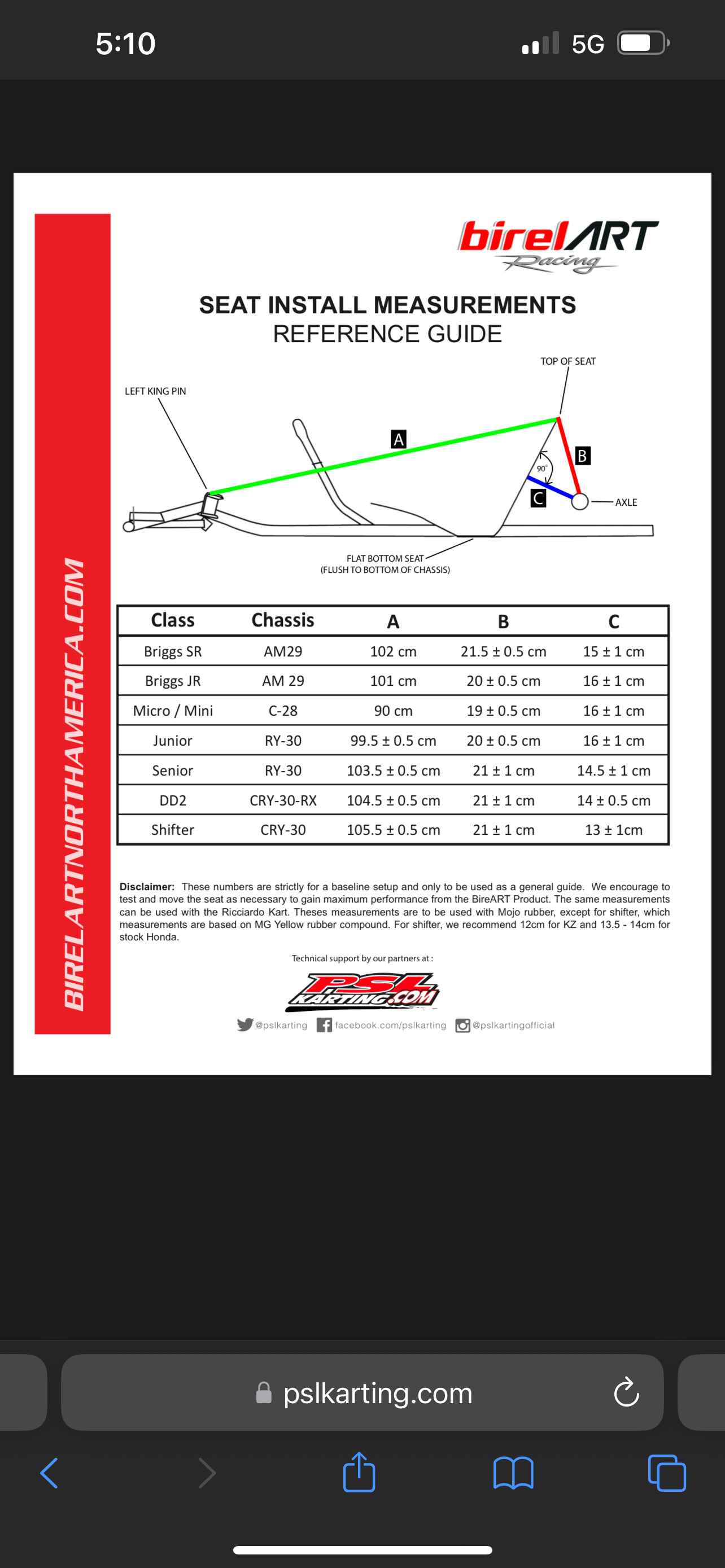

Float the seat? best method?
Seat placement? ā We moved it back (from where it was mounted when we bought it new) 4cm late last year(2023) per a fellow racers recommendation after he drove our chassis. We kept the weight bias the same (42% front) by moving lead however it helped tremendously in freeing up the chassis. It is extremely close to birel spec now.

I ran out to the track today and took exact measurement on the seat.
Our IMAF (F6) standard seat is set at A:102cm. B:21cm. C:14.5cm. (A little back and down it seems from factory spec).
My next question would be what seat and where should my measurements move to? I have in my possession the stock free line (F6) standard seat that has been patched along the bottom. A standard IMAF (stock free line replacement F6) And a Tillet T11 (standard, feels stiffer than the other two). Or do I need a t11vg?
If we were to move the seat first what should the next tuning steps look like? Or is there some tuning I can do to prove that the seat needs to be moved?
