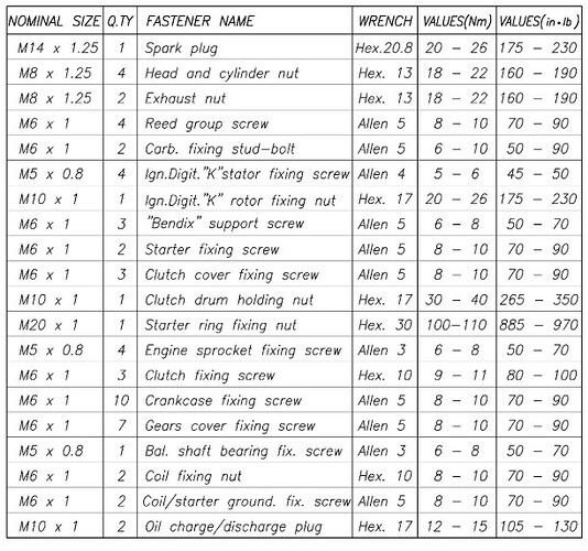

I just had some issues with my clutch on my IAME X30, so I had to troubleshoot and with that I disassembled also the flying wheel. I have a lock for the flying wheel and removed the locking nut with a socket wrench, and now it’s time to reassemble. The locking nut requires atleast 100nm (see image).
I’ve been thinking to get a nut driver, impact driver or a torque wrench, to be more sure that it apply the least right amount of torque. I wonder though how precise it must be with the recommendations for the X30? Of course minimum recommendation is a must, but if it exceeds “max”? Feels like impact/nut drivers has usually limited settings of torque and a pretty high minimum torque.

What sort of torque specs do you guys use for various size bolts, m6, m8 etc?
I use the values in the thread above
