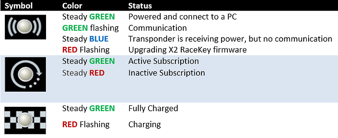

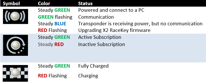

I have the X2 with direct power.
Yes it’s a two wire affair, kind of. The power wires go to the dongle cradle which has to be mounted somewhere on the kart, then a lead runs from that to the transponder. The dongle tells the transponder you have an active subscription, no active subscription no functionality. You have to periodically connect the dongle to the inter web to keep the subscription data valid.
It does direct power and also charges it, by that I mean if you arrive at the track with a completely dead transponder, you don’t have to charge it up initially before it will work, soon as you fire up the kart it will start to transmit whilst it’s charging.
