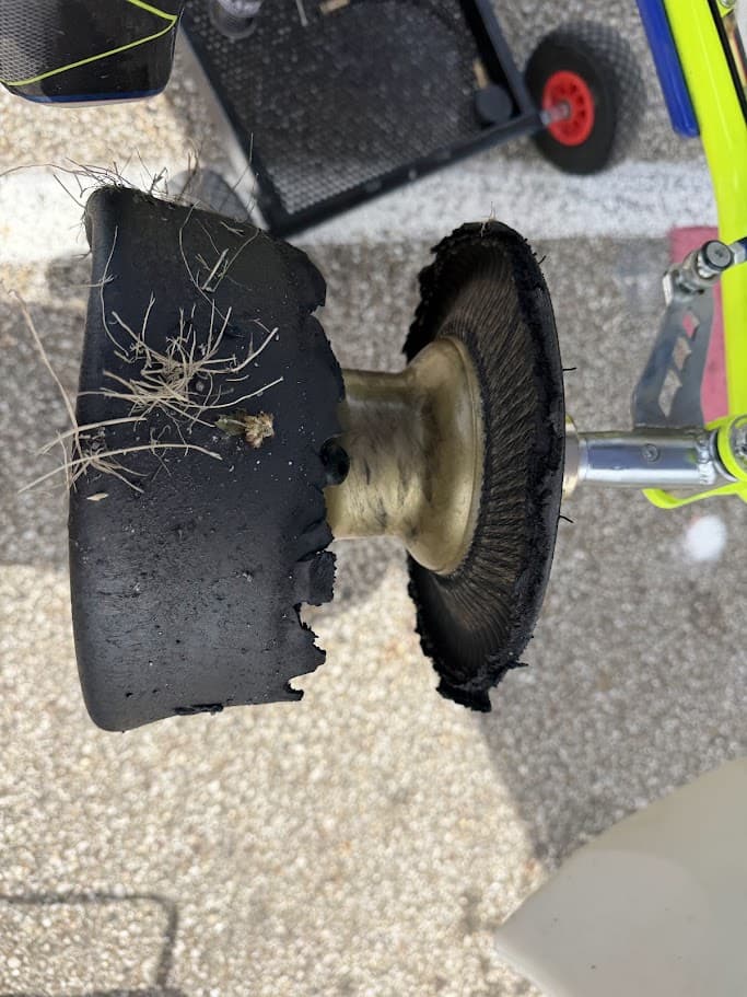

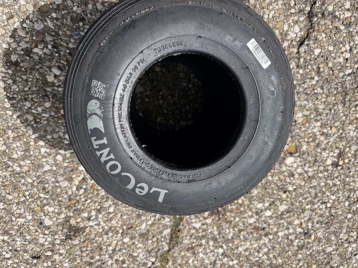

This past weekend I was a racing at Mid-Ohio and had 2 different tires issues. The first set were brand new LeCont White SVC Prime mounted last week, purchased them less then a year ago they were stored indoors. In the picture below you can see the sidewalls exploded and went flat after 2 laps. The pressures I was running was 12 in the front 13 in the rear, it was early in the morning it was only the right rear.
I didn’t have a back up so I purchased new set of MG SH2 tires. Next race, I completed it however the front tires felt low in pressure so after the race I checked and they were down 3-4 PSI, so I replaced all the beadlocks with Pro Dr1ver Beadlock, day 1 was over. Day 2 I checked the pressures and all 4 tires held air no change. Next I checked my tire gauge against others near me and my tire gauge seemed to be close to everyone else’s, First two practice sessions I just took 1 -2 laps nothing unusual. Tire pressures were set at 12 in the front 13 in the rear mild summer day. 1st race everything felt fine until after lap 6 something felt strange in the front, one corner later I could see something was wrong with the front right tire, tire instantly exploded and pulled off. I checked the other tires and there wasn’t a spike in pressure. I spent a lot of money on new things that broke, I can’t imagine that it could be anything but the tires themselves, but as I prepare for the next race next month, is there anything else that I should be looking at? The rims were OTK Mags, no bends or issues, they are excellent condition. I think the first issues could have been bad beadlocks?, but I am stumped why the MG’s exploded. I was thinking of contacting the manufacturer.

I don’t think so because the rear tire looks just like the others, but the sidewall corded, then the front tire it’s hard to tell but no weird tire wear on any of the others.
The front is a sidewall failure from running the tire almost flat the day before. The rear looks like the start of a side wall failure as well, sure there wasn’t a leak on that wheel? How soon before the session was the psi set/checked?
