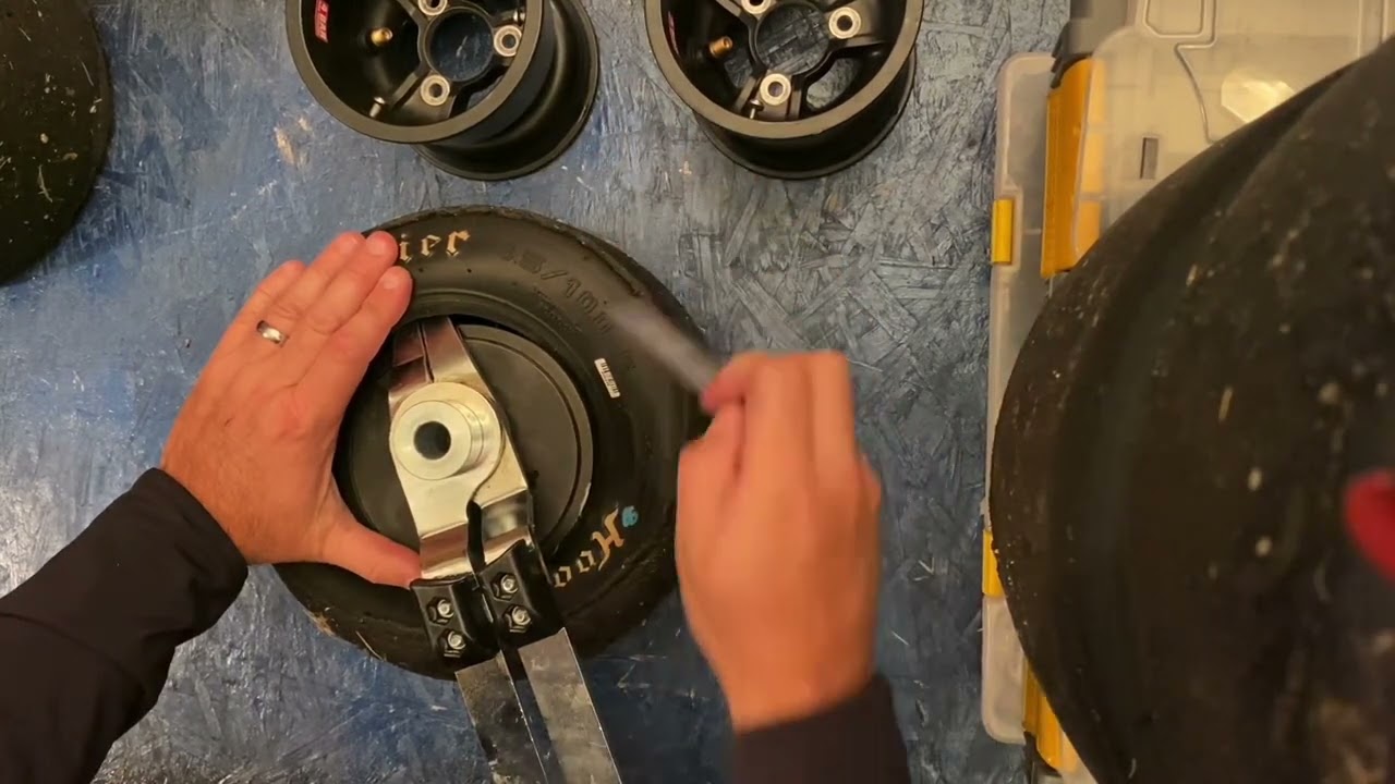

The tire/tyre scissor thing is stupid IMHO. I have these and have zero issues swapping tires with these 3 items which are worth their weight in gold IMHO:
https://www.tsracing.com/Tire-Mounting-Band-Fixture-P711.aspxhttps://
Bet I can change mine faster with the scissors.
I can mount them even faster by hand.
Mechanic battle. Initiate!
The scissors work awesome!
I’ve tried the trailer hitch tire mount and it’s great to get the tire on the rim. But in my experience unless the tires are warm it’s much easier and efficient to use the tire tongs. I found it almost impossible to mount them completely on the rim when ambient (even with a soft compound) not to mention taking them off. It took me about 20 sets of tires to master taking them on and off with the tongs, however I’ve tried countless other tools in the past and nothing is quicker than a bead breaker, some tire tongs, and soapy water. A big deal for me is physical exertion, it’s not easy to mount tires in the first place and trying to do it quickly is even tougher. The Guys/Girls who can do it by hand are superhuman and I am always in awe when I see someone do it that way.
The scissor make tire changing so easy, that I was flipping tires between sessions. I wouldn’t when I was doing by hand.
Changing tires by hand is mostly technique but it does take some strength or weight. I Easier if one weighs 190 lbs rather than 150.
There can be only 1: Turbo Tire Changer.
Learned this the hard way🤣
When using scissors be wary of ripping the bead of the tire. Use plenty of lube and do not force them open if they are bound up. I have ripped a few tires up that way by mistake. Use plenty of lube!
