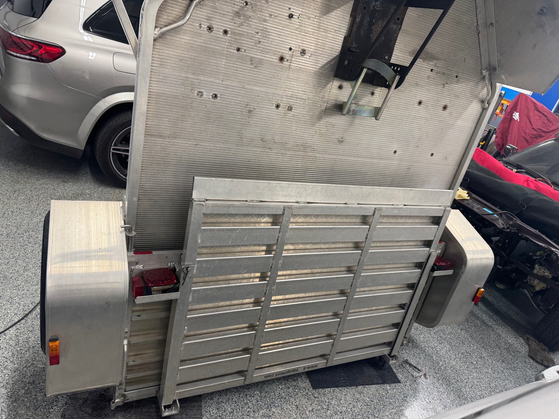

So I ended up buying aluma motorcycle trailer MC2F model. Its folding and very light yet it’s pretty big.
Now need to figure out how to transport karts on it. I like idea of double stacker stand, are they all the same or there is brand that’s stronger better? Is it suitable to transport 2 karts on it? Would it work as single kart stand when on track? Trailer got wide enough ramp that I can simply roll stand onto it. Is strapping by bottom stand part good enough?

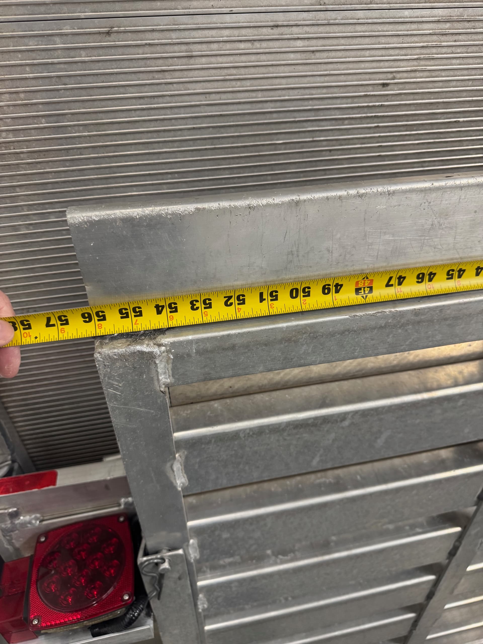

Wow what a cool trailer! But with the stock ramp, no way you could get a double stacker stand up it. First because the ramp is too narrow (you need 31” wide) and second because 5’ is too short so the angle is too steep for this much weight.
I know of only two double stacker stands (Streeter and Kart Lift) and they seem pretty much the same. Yes you can totally transport on that, but you need to secure the karts to it. Total height is 34.5”, so it’s quite a lift to get the second kart up and down. I’m trying to find some way to do that solo, but I don’t think it’s possible. My best idea so far is smaller casters (2.5” saved) and the tallest possible electric lift (Streeter Super Lift??) but that may not even do it. And getting a kart on/off the bottom position also requires two people unless you unscrew the 4 stub posts every time, somewhat of a hassle.
Actually… I got 2018 trailer, maybe it was different back then but ramp is sticking out like 1ft when driving, and it’s much wider(55in). And flat surface (no ribs).
Rolling onto it probably wouldn’t happen, but I am thinking mounting hand winch to pull stand onto the trailer. You see bunch of holes, it is used so no issues with making more holes :slight_smile: Got it pretty cheap, all serviced, greased, wiring, etc. It’s good to go.
