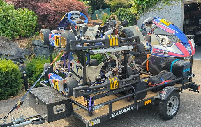

I use a 5x8 utility trailer to carry 3 karts, it’s light enough that I can move around by hand, and it is smaller than a car so easily fits in 1 car garage slot. I don’t try to back it up perfectly, I just roll it around by hand to get into place. It’s easy to hook up to the hitch, takes less than a minute – you’ll have to explain why that’s bothersome because it’s way less work than loading the rest of the karting junk. Main drawback is no rain protection, but if it’s a rain race, well, everything’s going to get wet eventually anyways.

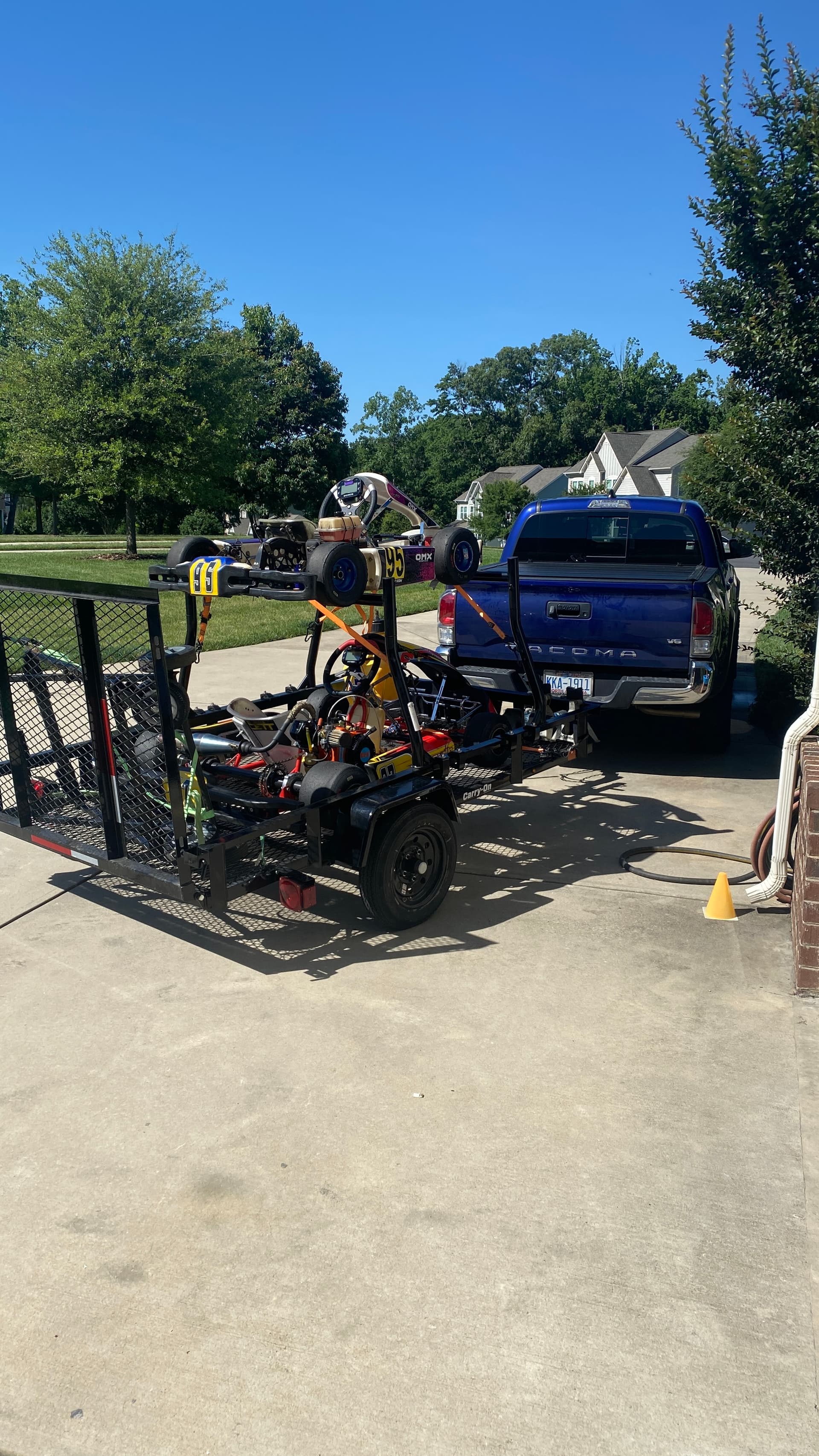

I ran a 5x8 with two karts (one adult, one kid). I just added a generic Amazon truck bed ladder rack, and it worked out great. I never left it overnight, but I planned on just tying a tarp down everything if I had to. For extra security, a couple bike locks could dissuade some opportunists, too, but I never tried that. Before the trailer, I ran my daughter’s kart out of the back of a wagon with minimal tools. It was fine for practices, but it quickly was not enough space for races, hence the trailer.
The 5x8 was great in that it fit in the garage with barely more footprint than the kart itself, and I’d just put the kart on jack stands on the trailer and work on it without having to unload it. The kart on top was even easier to work on in situ. Tools and gear would be packed in the truck bed under a tonneau cover. All in all, it was great, but, man, there’s nothing like having an enclosed trailer. I pay for monthly storage around the corner from me and have 24x7 access with a keypad, so it has cleared up a lot of garage space. It is also great not having to pack all the tools every time. You do have to consider being able to maneuver around parking lots, but I also found myself having to plan around parking the utility trailer if we had to stop since nothing on it was secured from theft. Like said above, I wouldn’t bother trying to back it in and out of tricky places. I’d just unhook it and push it around. The karts were centered such that it was not too tongue-heavy. Same for hooking it up - I’d just get close then set it on the ball by hand.

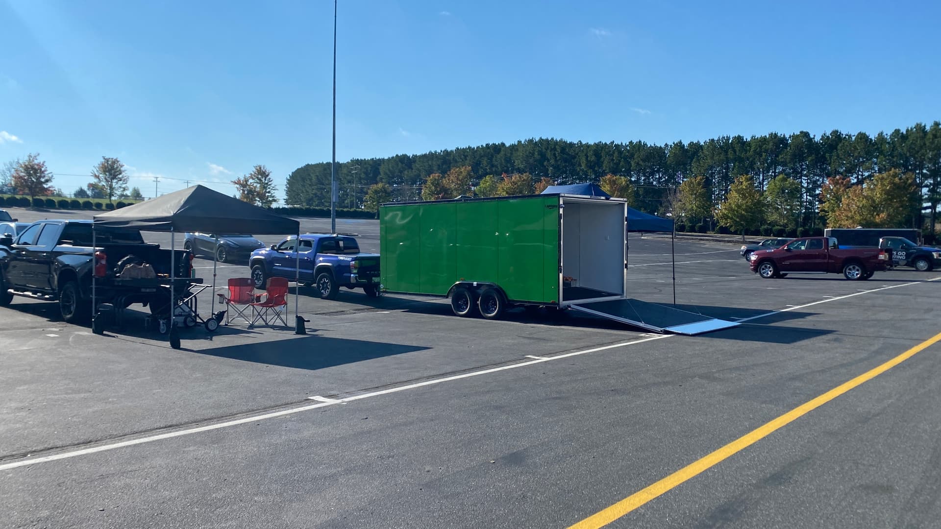

Biggest advantage with an enclosed trailer (and potentially a van if it is done reallllly right) is having a nice, dry place to get out of the weather. Here in NC, rain is frequent, summers are brutal, and winter is cold. My daughter’s first six races were cold and rainy, so the canopy we crowded under wasn’t great. Upgrading trailers made a huge difference in comfort. I’ve also gotten way better at driving the trailer. The awkwardness of learning one goes away pretty quick with practice.

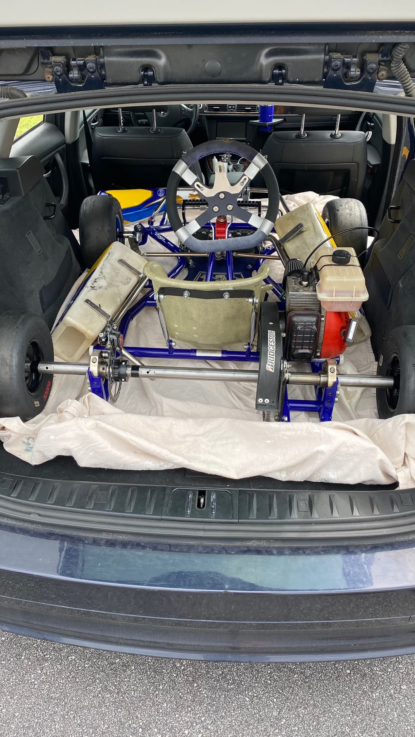

Wagon:

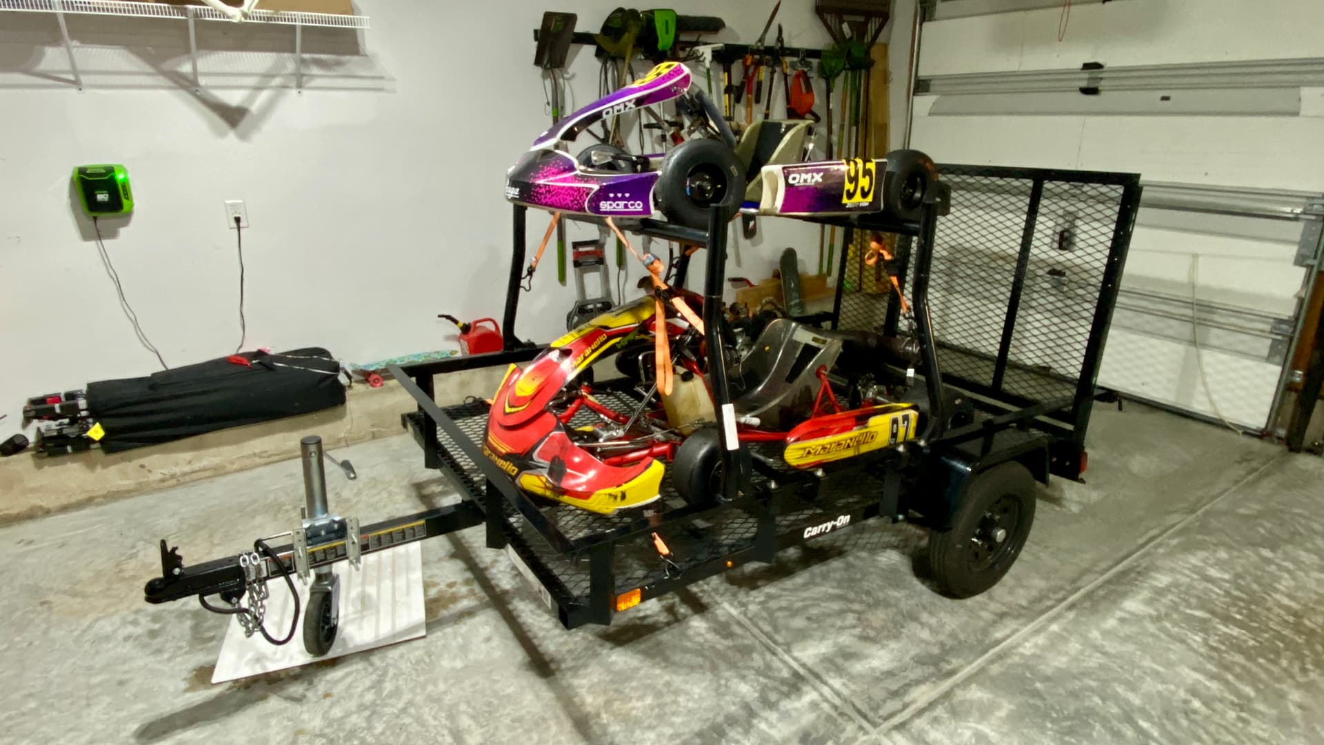

Trailer #1:
Trailer #2 (and why drugs are cheaper than karting):
What stand did you use with 5x8? That looks good as cheap quick solution. Like the idea that basic maintenance to top kart could be done in situ.
Also, I love straight tongue, can add folding hinge and make it’s footprint much smaller in garage.
Is there any space left to carry tools/fuel? I don’t have truck (have SUV) and could carry gear inside but prefer not to mess with fuel/tools.
I used a folding stand, and you can barely make it out in the picture with the truck. It is strapped to the tailgate, so it took up nearly no room. The gas tank was strapped to the front corner of the trailer since it fit perfectly in the gap between the round kart nose and the corner. The canopy, tools, and gear bags went in the truck although you could probably also strap a canopy to the tailgate beside the stand or on the platform beside the kart if the kart was slightly off-center. There was also a lot of space by the tongue for a big box
folding stand
No, I mean how is top kart held? But I see now, you fabricated this mount for top kart?
How many kart stands did you have? Just one? And I assume you didn’t use it for transportation, right?
The top kart is on a generic truck ladder rack. I bought it off Amazon, and it was adjustable enough to fit the side rails perfectly. It also had spots for tie-downs. Getting a kart up there took two people, but it wasn’t bad. Bottom kart just rolled on. I used the folding stand for both karts

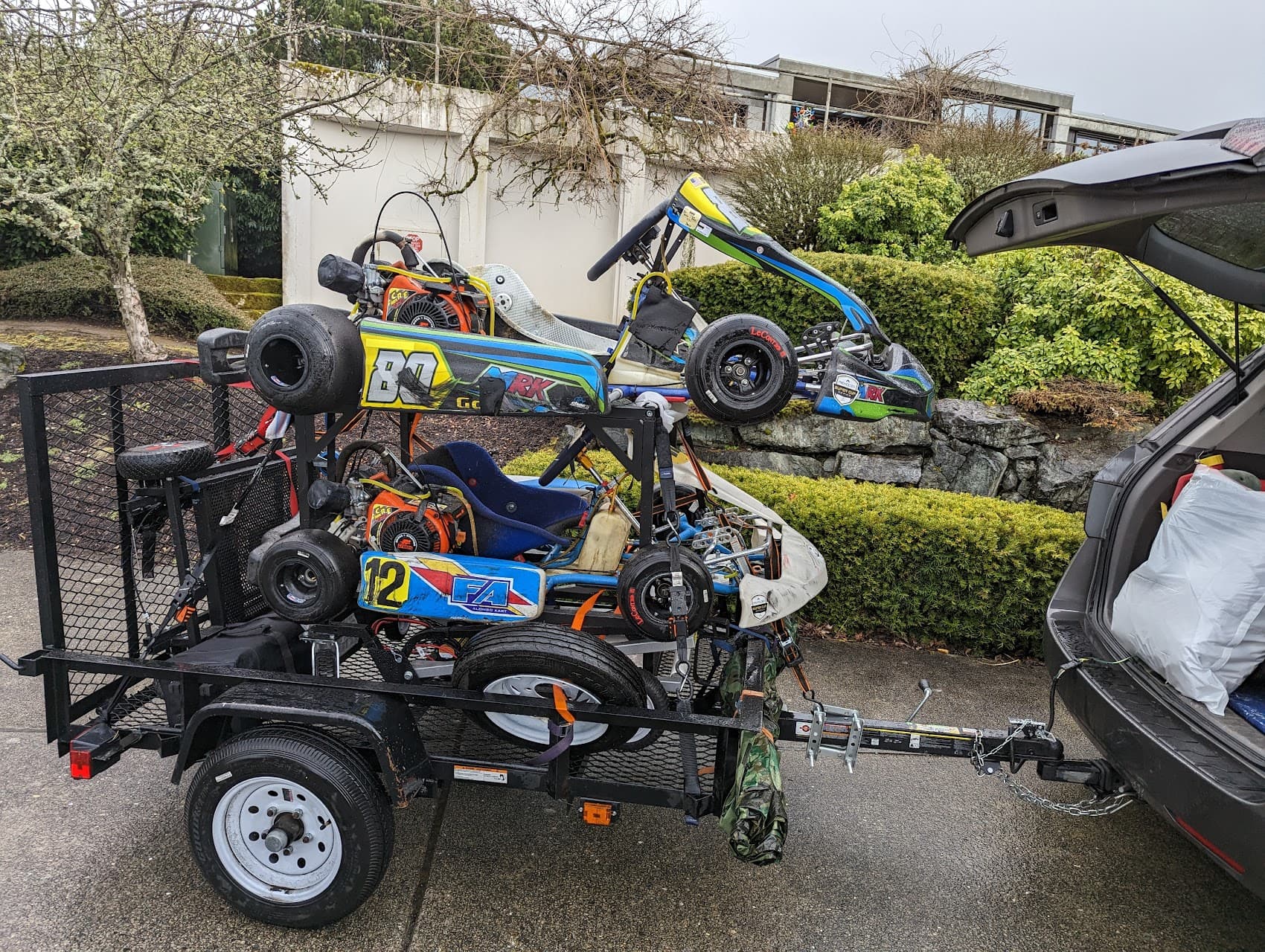

2 karts on a 4x6:
3 karts on a 5x8:
