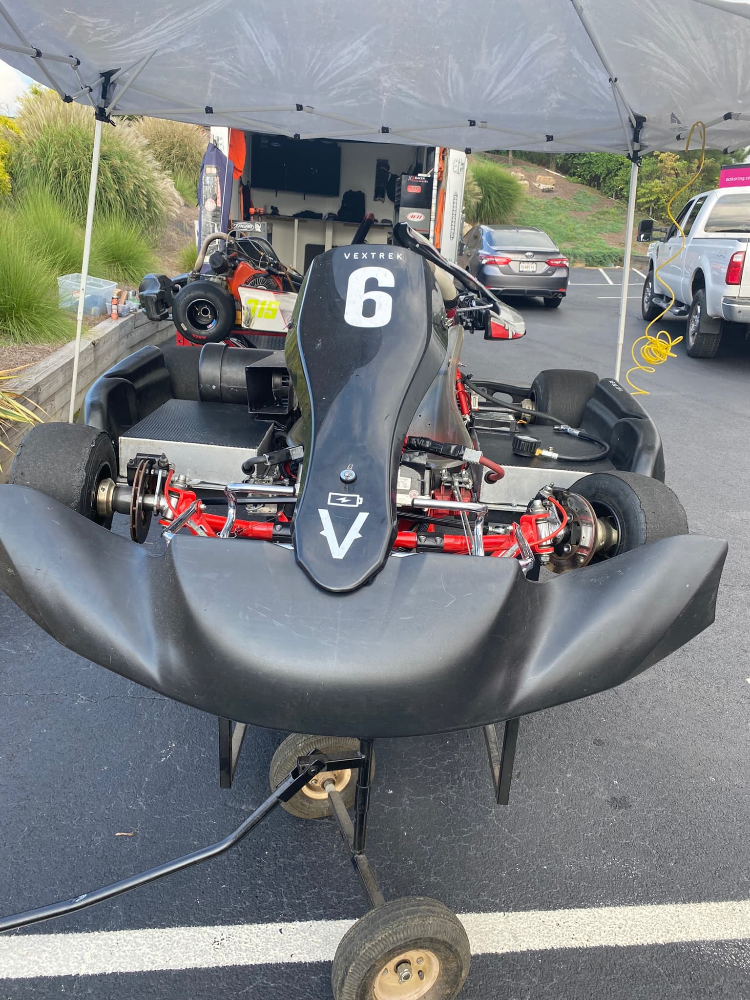

Summary: Electric Go kart using a DR Shifter Kart chassis (M99)
Motor: AC-9 from HPEVS (100V)
Controller: Curtis 1238E (650A max)
Battery: 100V/46aHr pack consisting of Molicel P26A cells connected with .25mm thick pure copper

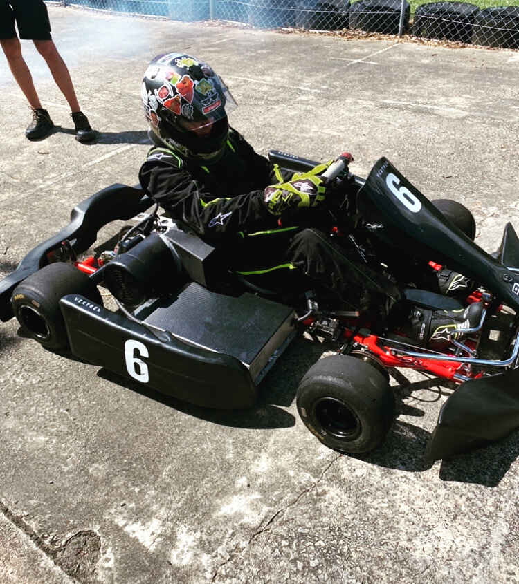

So why post a video of a gas powered kart catching and passing our electric kart? Because this was a test session against a shifter kart at the Atlanta Motorsports Park (Dawsonville, GA). You can not improve unless you race someone faster than you.
As you can see, the electric kart (Black #6) keeps the lead at first because of its speed on the long straight away. The shifter kart eventually passes the electric kart because of its ability to take turns quicker (less weight) and its acceleration up hill. Since we can not “shift gears”, Vextrek will switch to a higher sprocket ratio (probably 3-to-1 versus the 2.7-to-1 ratio used in the video). Also, we are reducing weight where possible. The electric kart is 305lbs (138 kg) without a driver. Our goal is reduce weight by at least 5 lbs (2.2 kg). Finally, we were only using 90% power in this video. Eventually, we will increase it to 100% power but this will likely require motor controller software adjustments regarding “gear softening” and “max throttle voltage”.

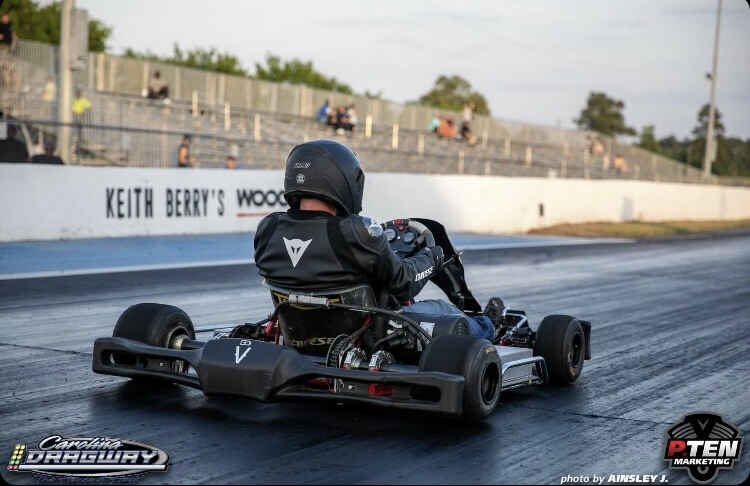

Have been running 1/4 mile just to see what i can get on top speed. 109 mph at 12.77 seconds. I will find the time slip …. It’s around here somewhere
Not really relevant from a “go track” perspective since few straight aways are that long. Lots of fun though

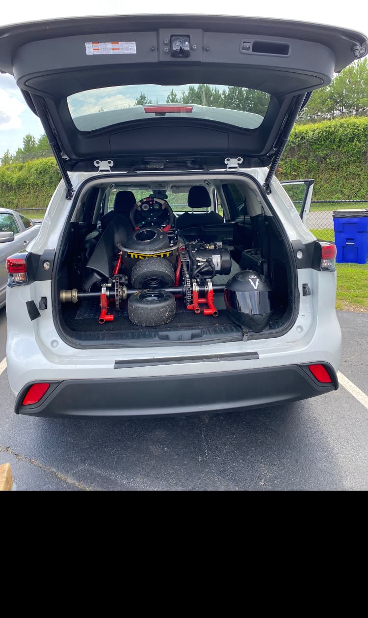

Have not had the kart scaled out but hoping to do so before the next trip to the Atlanta Motorsports Park. Not much room to move components around but probably need some caster/camber adjustments. Will definitely post the weight distribution print out when available Picking it up is most definitely a 2-man job
