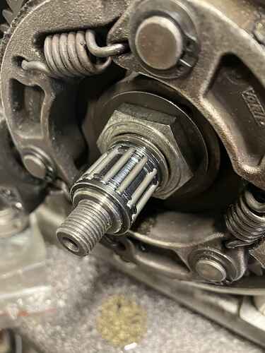

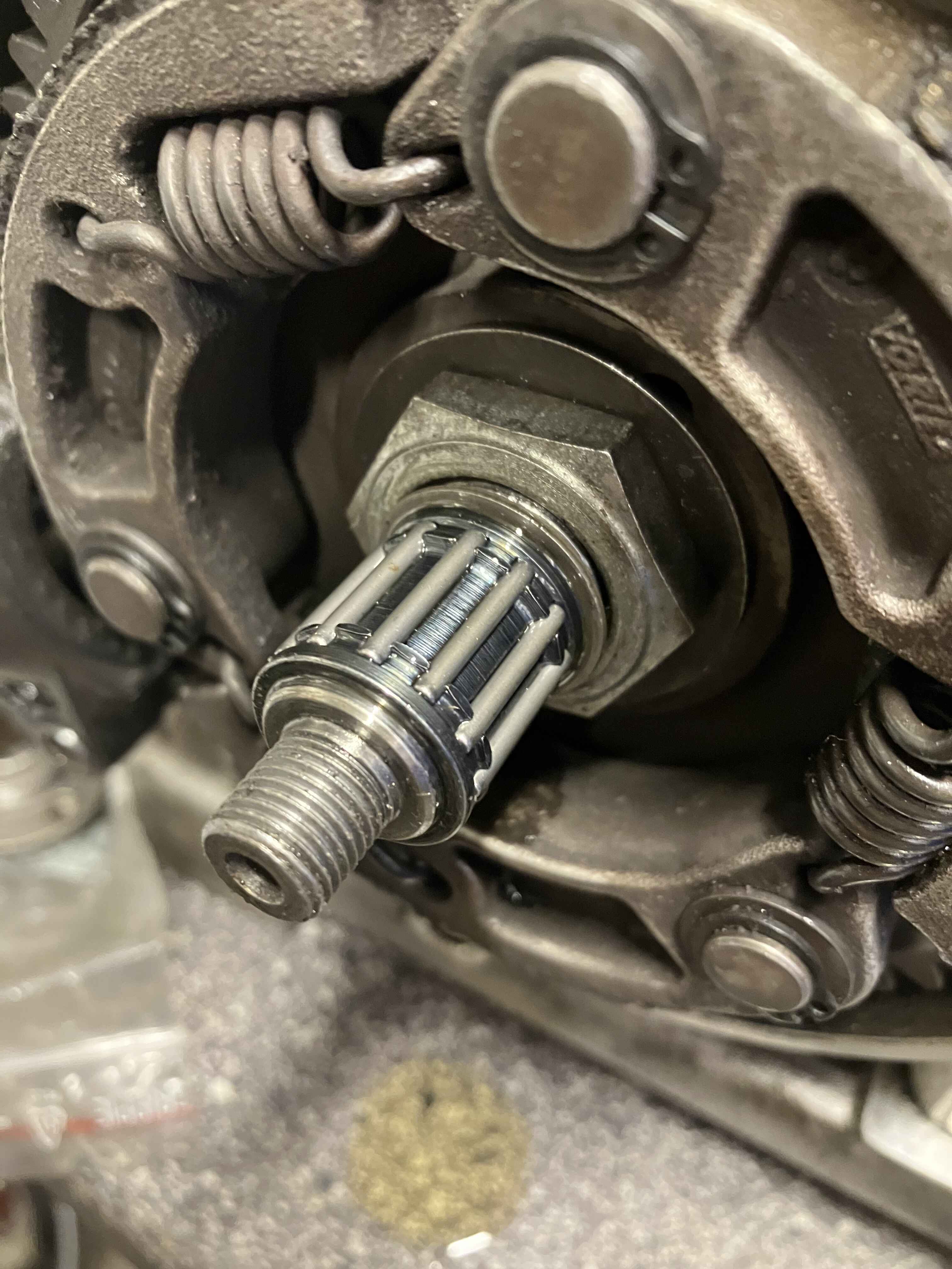

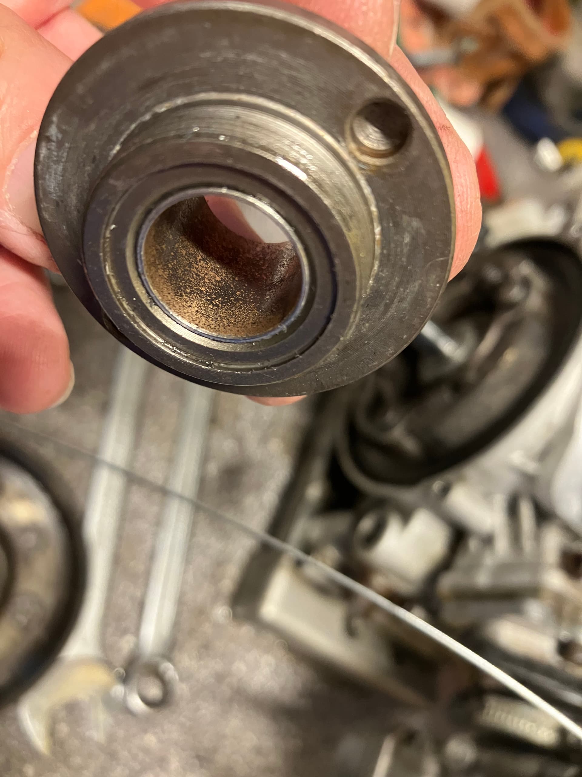

This thread was helpful for me today so I’ll add my experience here, just for the record as we had a problem on track with my son’s Ex Rok yesterday which I traced down today to be caused by the bearing face on the sprocket being worn about 0.1mm:
What we observed was that we could’nt start the engine when the kart was on the ground. I’m pretty sure what happened was that when the cart was put on the ground with driver in, the chassis flexed a bit and increased the tension on the chain pivoting the bell a bit to bring it in contact with the clutch…
New sprocket on order
Went up to a 12 sprocket as it has a roller bearing which I feel intuitively will be better than the bronze bearing on the 11 sprocket.
There’s axial play, but no lateral play so the clutch bell doesn’t twist like it did with the worn down bearing.
Video showing play with the new bearing fitted
Lesson learned: Check your clutch bearing, replace when worn to prevent problems. Also keep it lubricated to extend its life
