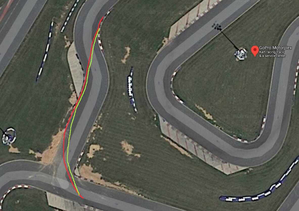

Thanks for the share! Reviewing the rest of my footage over the weekend I notice I do tend to look into the corner early, slowly drift in, and then initiate my turn in. This is tightening the corner, I’m a bit aggressive on the wheel, and I’m a kart width or two off the line when I turn in. Around 1:30 in my footage is a good example of this. Quick technical drawing of my line(green) vs optimal line(red) :grin:
That specifically is a really tough section to nail. It took me a few visits before I understood how far ahead you have to be driving there. It’s such an important rhythm section that leads you into the big passing zone on the track, so it can make or break your lap. You want as little wheel movement as possible, but it’s imperative to be super smooth, precise, and quick with your inputs. The section is quick but the big curbs really penalize you for any misstep.
How I approach it (and how I think most fast guys approach it) is to basically just ignore the second kink (right-hand curb) and start looking for that big apex curb on the 90 degree left as soon as you start coming off the first left-hand kink. The right-hand kink is just peripheral vision, your eyes should be going from your exit of the Monza, to the apex of that 90 degree corner as soon as you can possibly see it.
And then it’s just a matter of nailing the specific rhythm of that complex of corners.
