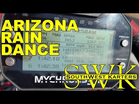

Driver is now well and our handling issue is sorted, but in twenty five years of racing he has only run in the rain two other times. And never in a KZ level machine. Same goes for the crew chief.
