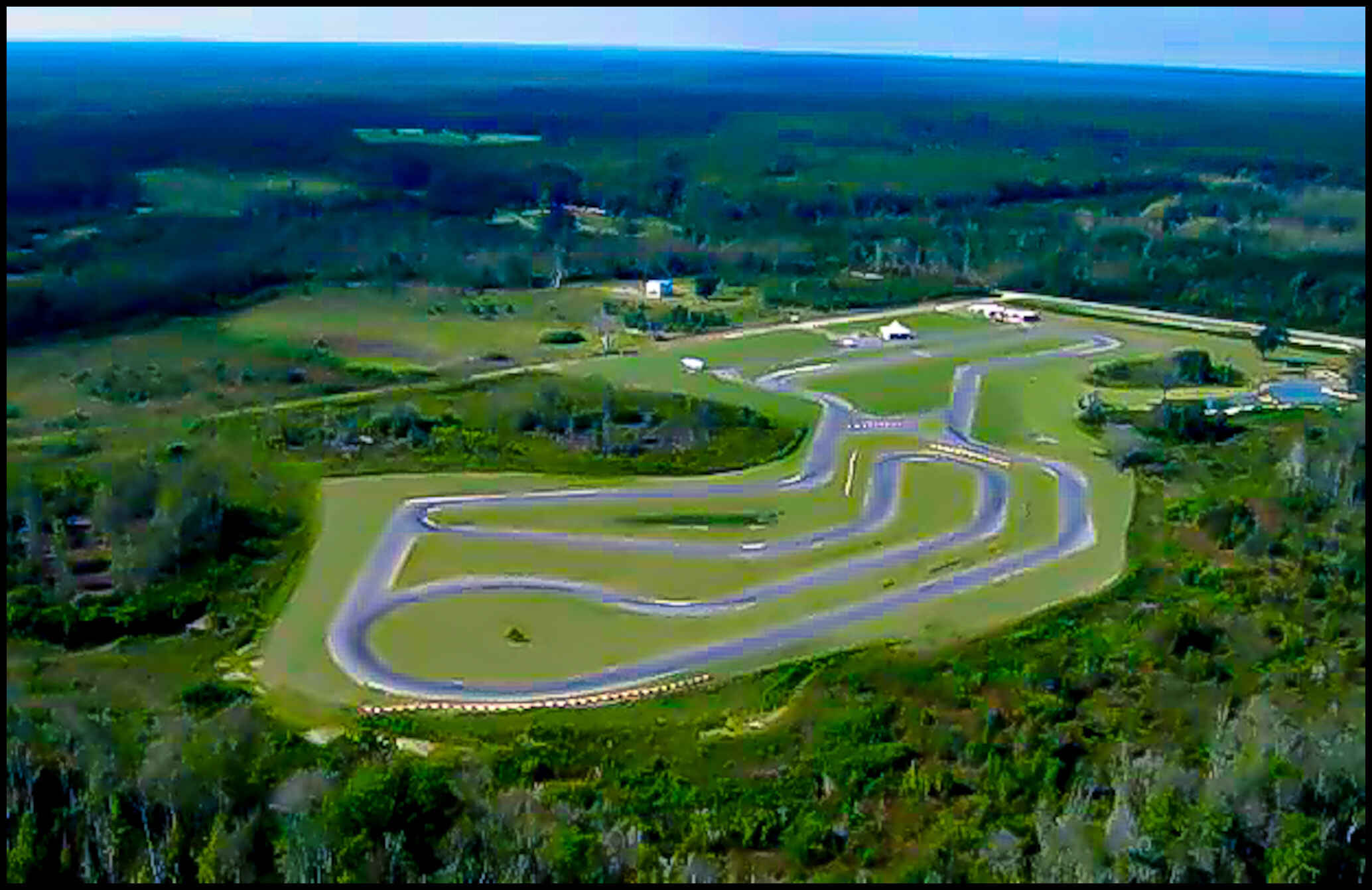

Ryan posted this lovely flowing layout in Fl. He neglected to identify the facility however… is it private?
Anyone been? Might be a bit long for my beloved gx270’s.
That looks like the Monticello Kart Track up in the FL Panhandle area near Tallahassee.
Aha! Thank you.
Sadly… “Due to changes in regulation regarding Kart tracks in the State of Florida by the Department of Agriculture, MKMC us NOT offering rental karts at this time”
