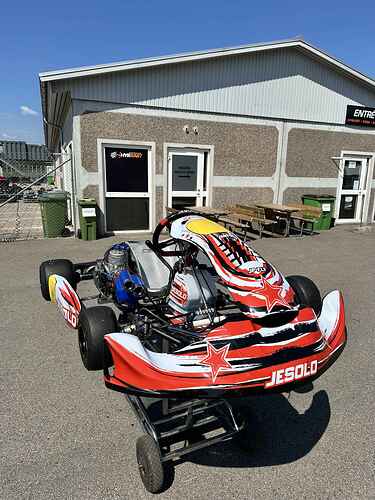

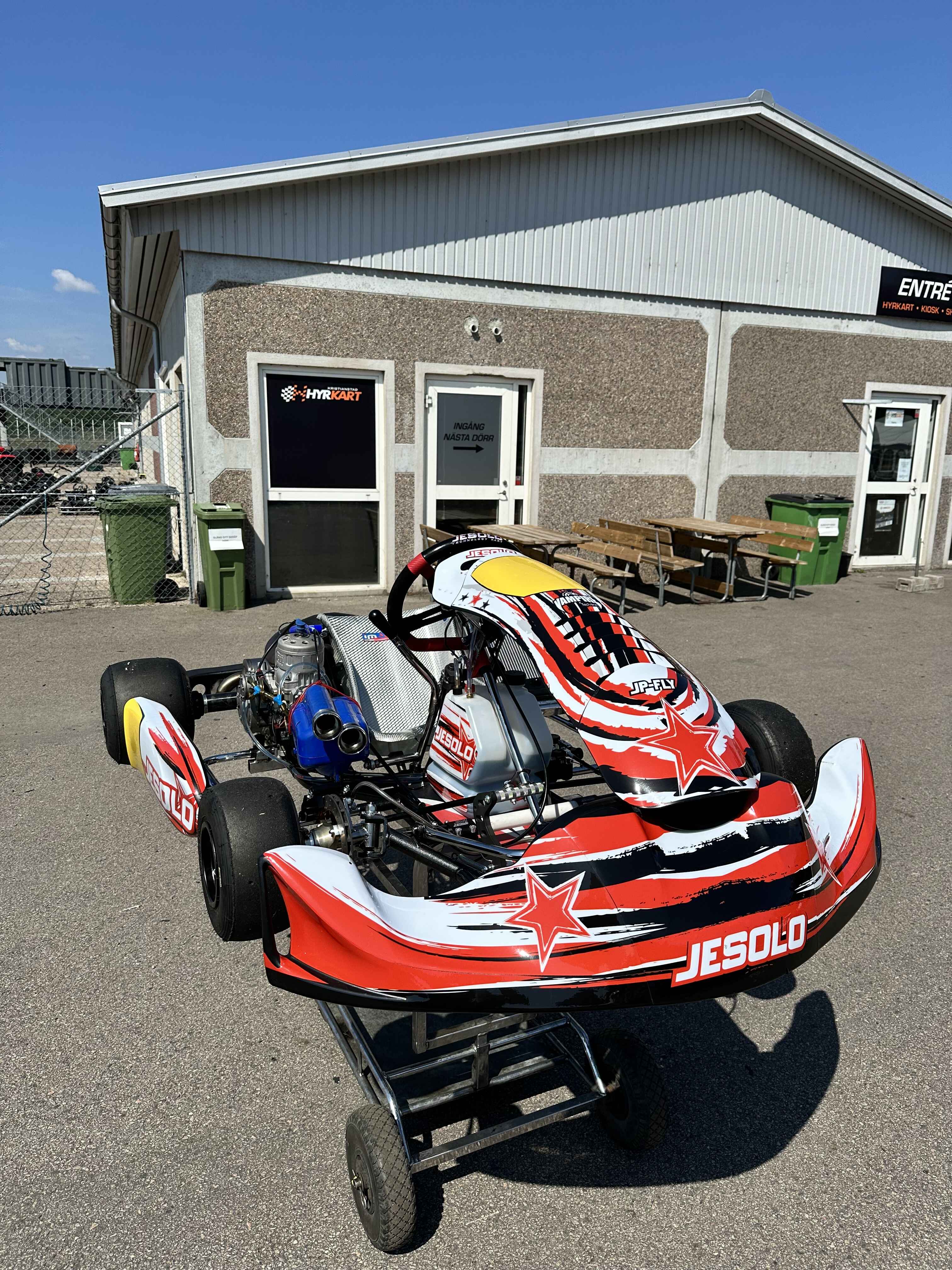

I was 1 of 3 lucky winners of a full day of testing a Jesolo kart. It actually felt really good and balanced, the brakes were amazing. Very easy to modulate!
My best time of the day was 50.6, that would put me in 53rd place of 91 in 2021 world champ quali here in Kristianstad. Not to shabby considering I ran a good ol TM KZ10B
Enjoy
Nice! Kart looks planted and easy to drive. I’m sure much of that is your prowess.
Surprisingly easy actually, I’ve driven basically every brand. But this one did stand out, it kept giving all day!
The smoother I was the more I was rewarded

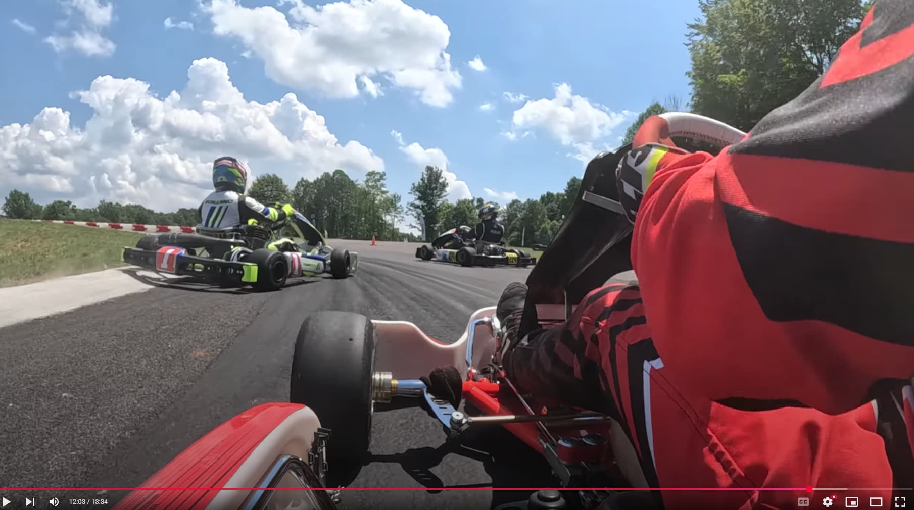

My first big hit after 8 years of karting. I’m #07.
Frame was bent 22mm up on the right side. Was able to get it fixed and race the next day though.
BTW Quaker City is a fantastic track.
How on Earth did that bend it up 22mm? Looks like you barely tapped him.
I put it in the barriers at 60 mph in Vegas last year and the frame was straight as an arrow when we put it on the table. I had a head-on hit at New Castle this year that broke the tie-rod and bent every component on the front end, including a front stub, and it was bent 3mm. 22mm is almost the thickness of the tubing, that would be pretty hard to straighten.
Dude I have augered into tires, bales, berms, etc.. and had no damage, then I drop a wheel off the edge of the track on a straight and bend the frame so bad the kart won’t roll. It is weird sometimes.
I think it’s because the front right hit the other drivers rear right wheel straight on… All it could go is up. The guy who straightened it was like “this is a lot softer than an OTK” frames 28/30mm so that’s maybe why.

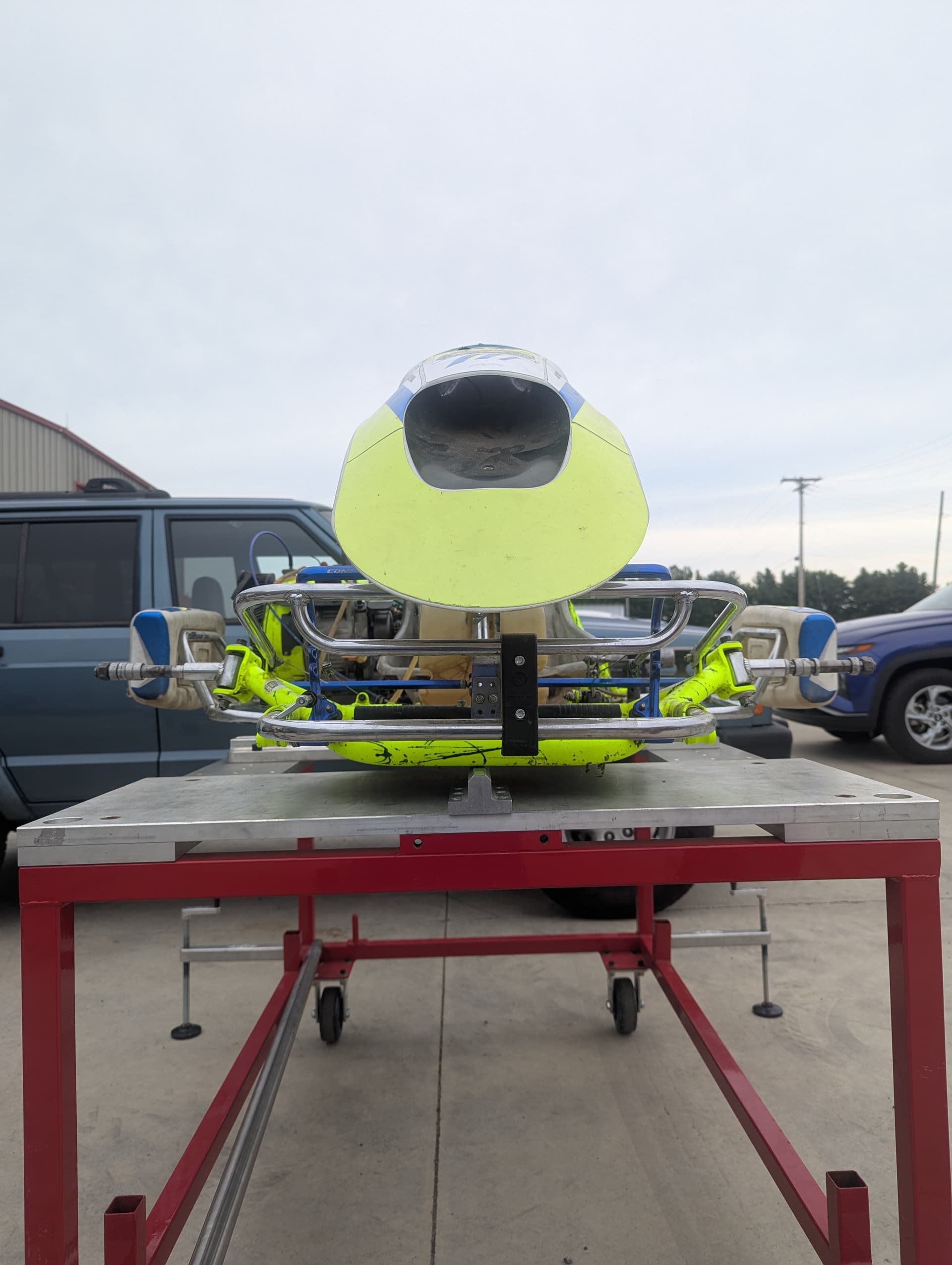

Lacking some mid-corner balance. The fronts are really powerful on new rubber. I think I’m over loading the rear as well. I pulled an engine side seat strut for the next session which helped and I think I’m going to chop the axle to 1040 for next week. Maybe a bump of negative camber. Our track is getting quite rough and a small pickup in wind or someone dropping a tire can really ruin the grip from lap to lap.
Also really playing around with lines and gear choice in the infield. I feel like I’m stuck between 3rd and 4th in most corners. Maybe on a proper gripped up day I could carry 4th easier, but it was tough to keep it at the bottom end of the rev range to pull of the corners. 3rd there was too much engine braking and getting on throttle would uspset the kart.
Ouuuffff that is one hell of an front sensitive boiiii
Seems like you have side bite to run much less caster than you currently have
Gearing seemed to be quite short as well. What are you running now?
