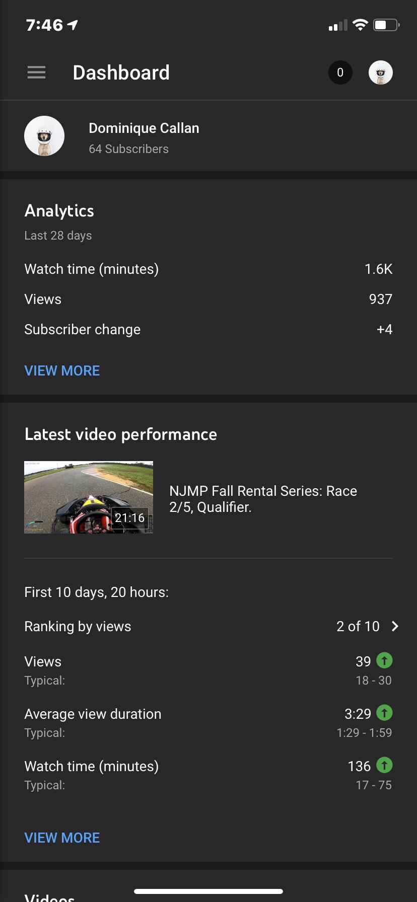

Final thought and I’ll let this go. Even a minor you tube karter like yours truly gets views. And most of the views aren’t you guys. My channel got 937 views in the past 28 days. And, my videos are boring race videos made for other racers enjoyment, not trying to tell a story.
I argue that if a shlub like me is getting views, people are interested in Karting and youtube is obviously relevant in Karting’s present and future.
