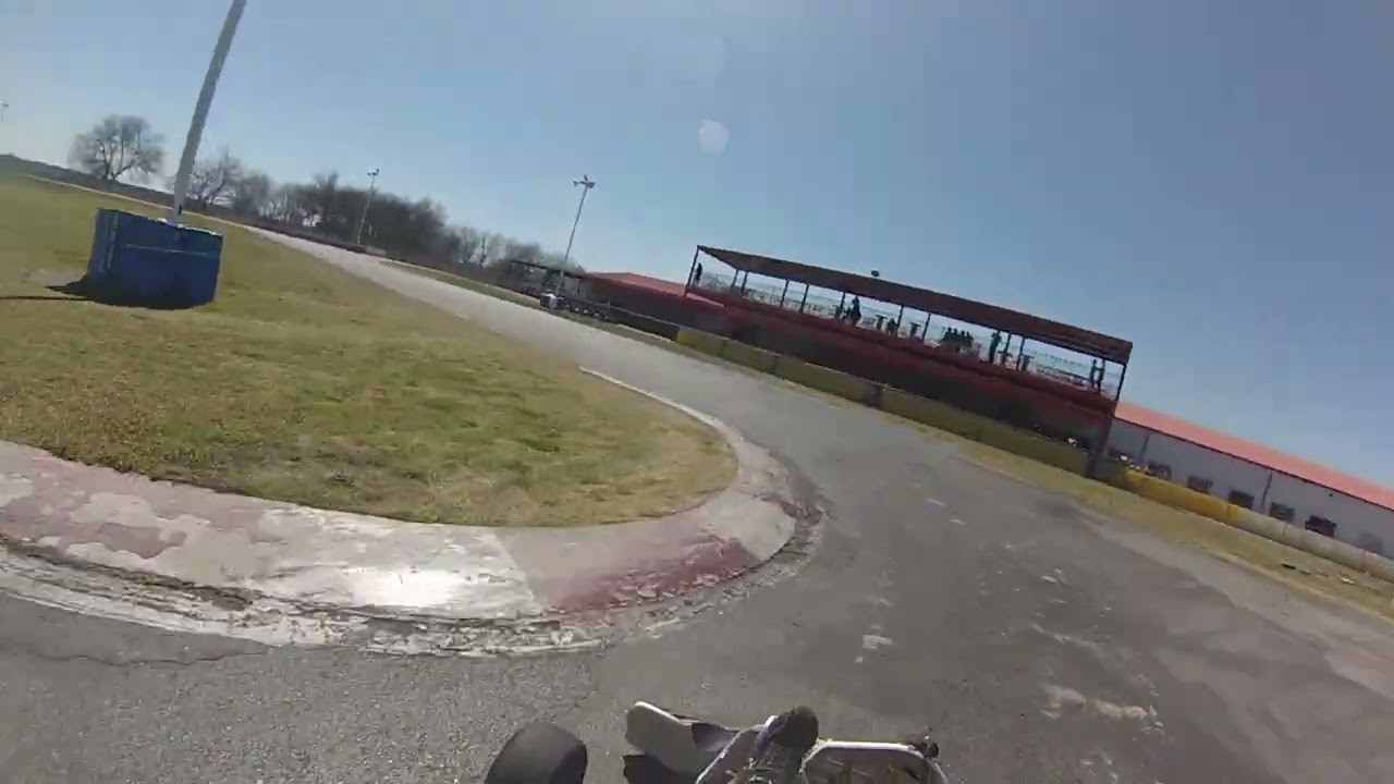

First Practice of the season. After so many months out of the kart, I found I had reverted to a beginner again. Half way through the session I realized I was not looking ahead and focusing on the corner I was in instead of the corner ahead. Started feeling much smoother after that. (BTW, I think the sound is out of sync because I see my foot hit the throttle before I hear the engine react.)
How did you feel about it? Also, that’s a different t layout than when I went. It looks like you got progressively more comfy. The one area that struck me as inconsistent was t1. It seemed you were playing around with it, looking for the line. Sometimes it seemed like you were a bit too late-apexy.
If felt like I was making progress once I realized what I was doing wrong. They are in the midst of building a second track, so the original has been shortened in the mean time. That was my third session. First one was short. Second one I dropped a wheel and popped the chain and bent a sprocket halfway into the session.
I was playing around with T1. Different braking points, turn ins, rolling points, throttle points, etc. T3 was the roughest part of the track in this configuration. The apex has a rough surface and if you don’t hit it right it will send you off track on the exit. That’s how I dropped the wheel.
Surprisingly I wasn’t as fatigued as usual. Not saying I am in full race shape, but it was a good day all in all.
Jeez Oliver, you are gonna be the go-to GoPro “pro”. You race there a lot!
its practically my home track even tho its 4 hours away
because i haven’t posted enough videos from gopro
I’ve got a final from Orlando I want to post. Need to see if I can figure out how to do that from my phone or if I need to grab my laptop for it. Do I need to upload the videos to YouTube first?
Nevermind, I figured out how to upload videos to YouTube from my phone.

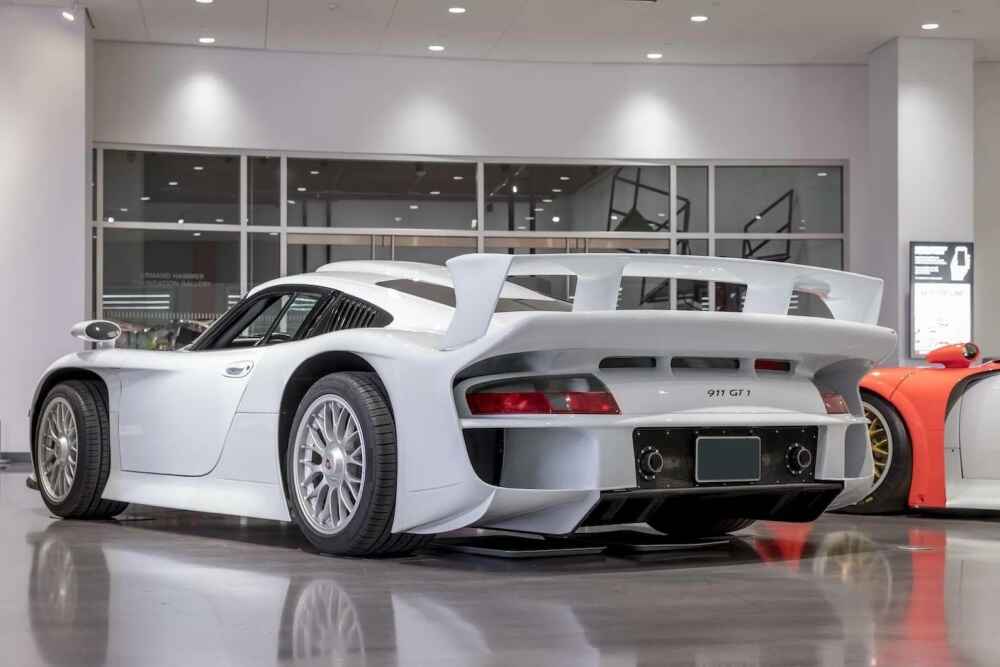

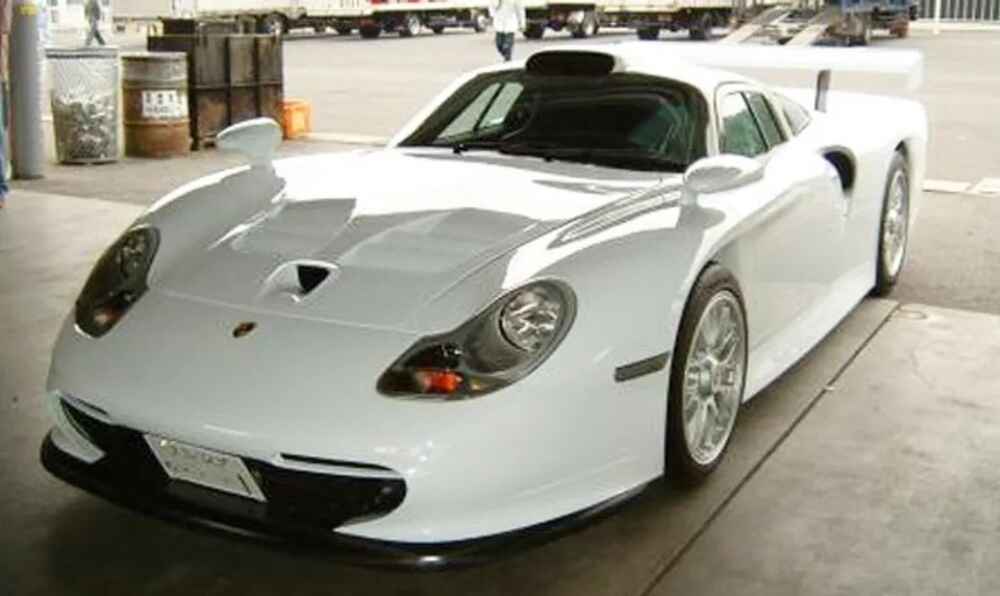

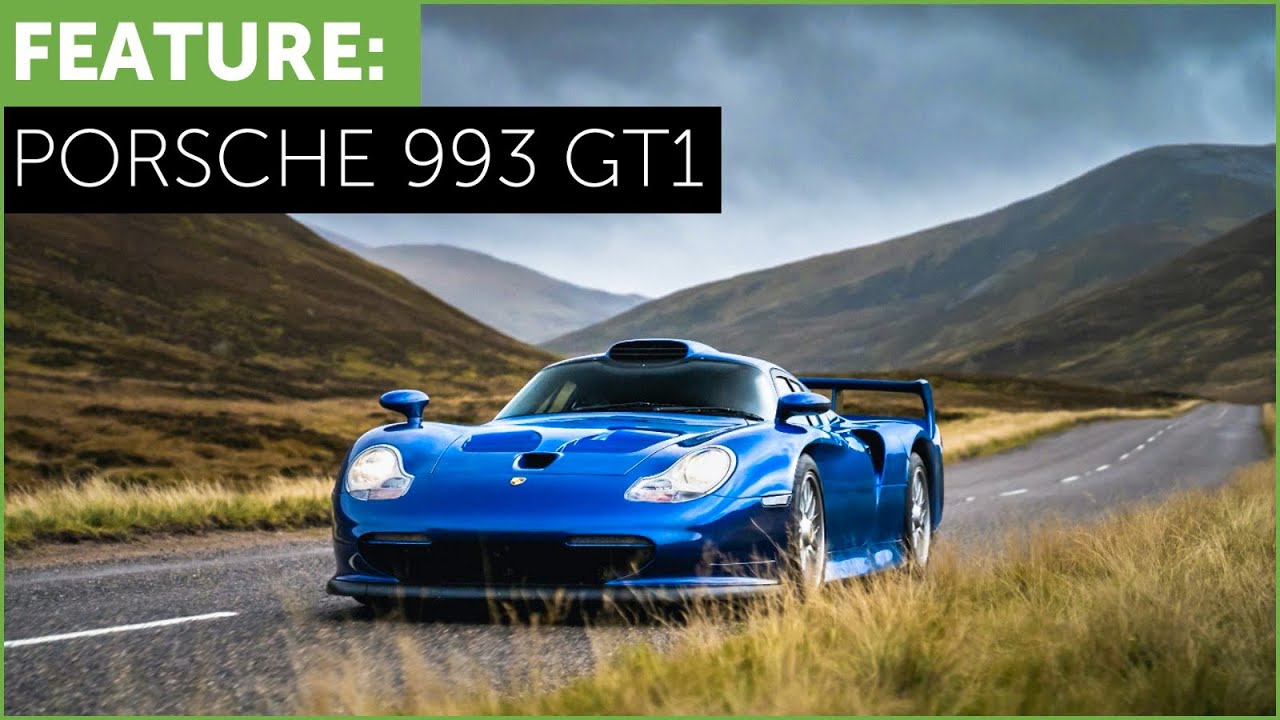

@E13 instead of spending g 10+mil of hard earned money on a race career, consider this alternative:
https://rennlist.com/articles/porsche-911-gt1-strassenversion-goes-up-for-sale-with-an-exorbitant-price-tag/
The fried egg headlights generation:
Nice tuckus, tho.
Bitcoin accepted. How quickly cars get dated, this isn’t any faster off the line than my 50th anni (GTS) but likely more lethal.
The Strassenversion is a race car for the road, that thing would be so awesome to drive. It weighs like 2500 lbs, I bet it rips corners like no one’s business. Only 20 made in the world, pretty special car.
They made a non-egg headlight version too.
I’ll dig up the Tiff Nedell vid
That thing is insane. Take my money! You think my college tuition is enough to pay for it?
