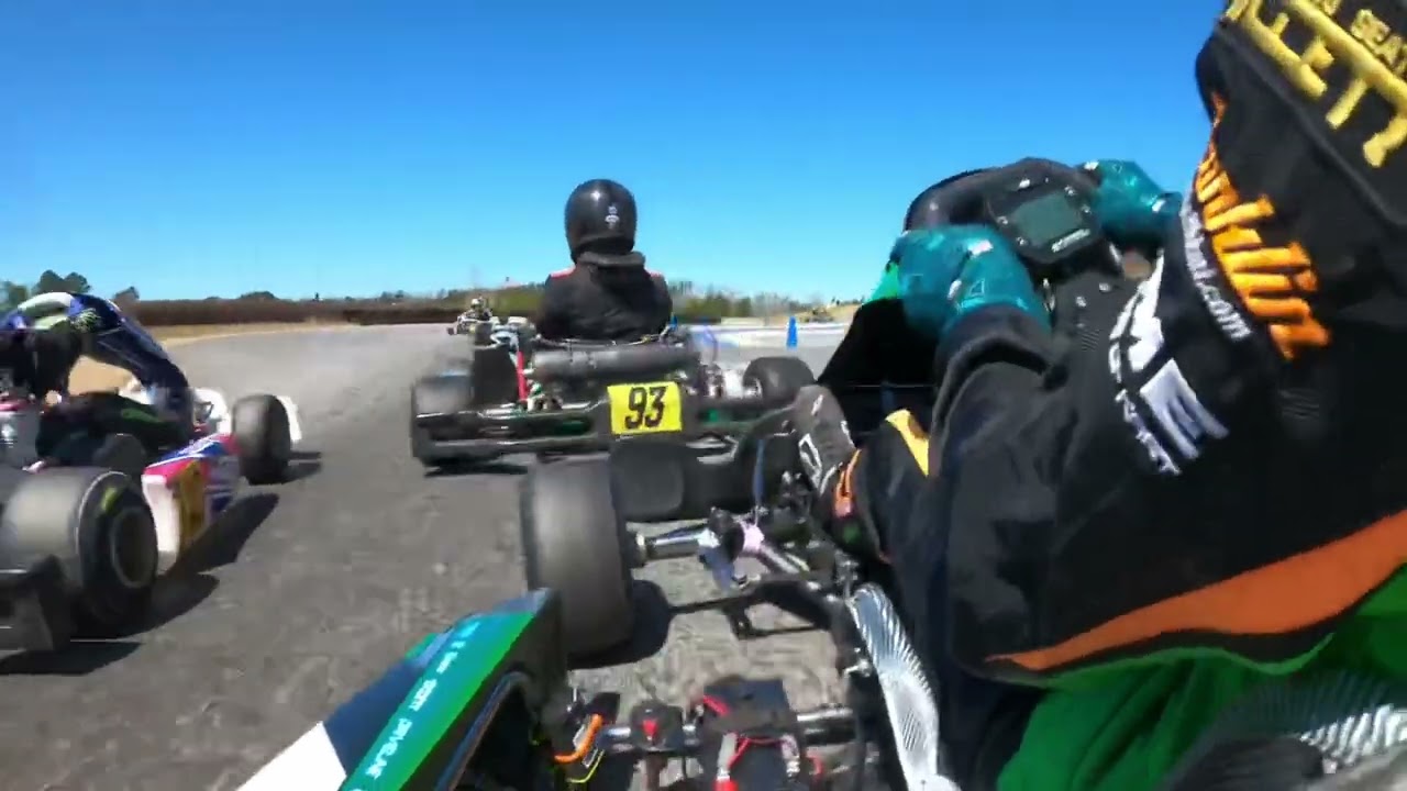

Here’s my first X30 senior prefinal race at AMP. Qualified 6th (they only gave us two laps and I ran into masters guys on each of them) and finished 4th despite being geared way too high. I wasn’t able to get footage of the final, but that was a less interesting race anyways, and scoring issues also meant the prefinal results ended up being official for the day.

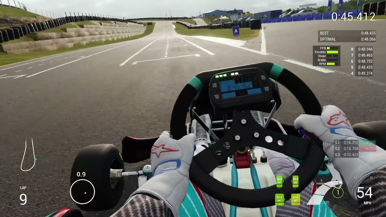

(In case you are curious, here’s what AMP x30 looks like in sim, not too different)
Hey I’m old enough to join them! No, I didn’t crash into anyone, just had to slow down a lot on both qualifying laps - for reference my best qualifying lap was over 2 seconds off of my best lap in the video. They didn’t do anything wrong either, it would just be nicer if the officials grouped us up by class on the grid for qualifying, rather than make it a free-for-all.
Thanks! It doesn’t sound that obvious in the video, but data showed that my RPM and speed was leveled out for about 200 ft on the main straight, and after we found we were about 2 teeth higher than most everyone else. I think just one tooth lower would’ve been fine for outright pace as the lower gears seem to really hurt your runs out of turn 2 and the double left after the main straight. But the passing opportunities there aren’t as good as the straights, so the lower gears seem to race better here.
I don’t think I’d do anything differently here. An opportunity came to follow the 340 through and I took it…unfortunately the 29 was able to just drive by me on the next straight. I might’ve been able to defend more down the straight, but it felt a little early to start doing that and I knew I could keep up and re-overtake.
The main thing that stands out regarding racecraft that I think I could’ve handled differently came around 4:15. I should’ve backed out a little bit earlier when I saw the 340 following the 93 through. Instead I tried to hold it just a little too long and had to back out late at the exit which really hurt my run going up the hill. The other things that stand out to me as areas of improvement are just consistency (was a little wide at some apexes at various points) and using more of the track on entry in the fast, blind right-hander before the last corner (had to catch slides and lift here more than I would’ve liked).
Not allowed. There was an official there all day monitoring track limits.
X30 obviously is way faster with a ton more grip, but I don’t think the line is all that different between the two. X30 you probably run a little wider in a few places to carry more speed (T4 left by the building, the esses after the double lefts, the fast blind right-hander). The group running X30 at AMP was also a lot of run to race with - everyone was very nice and I thought we all raced well together. Should make for a fun year.
