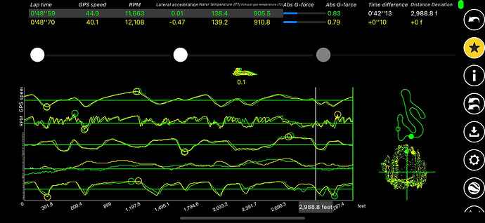

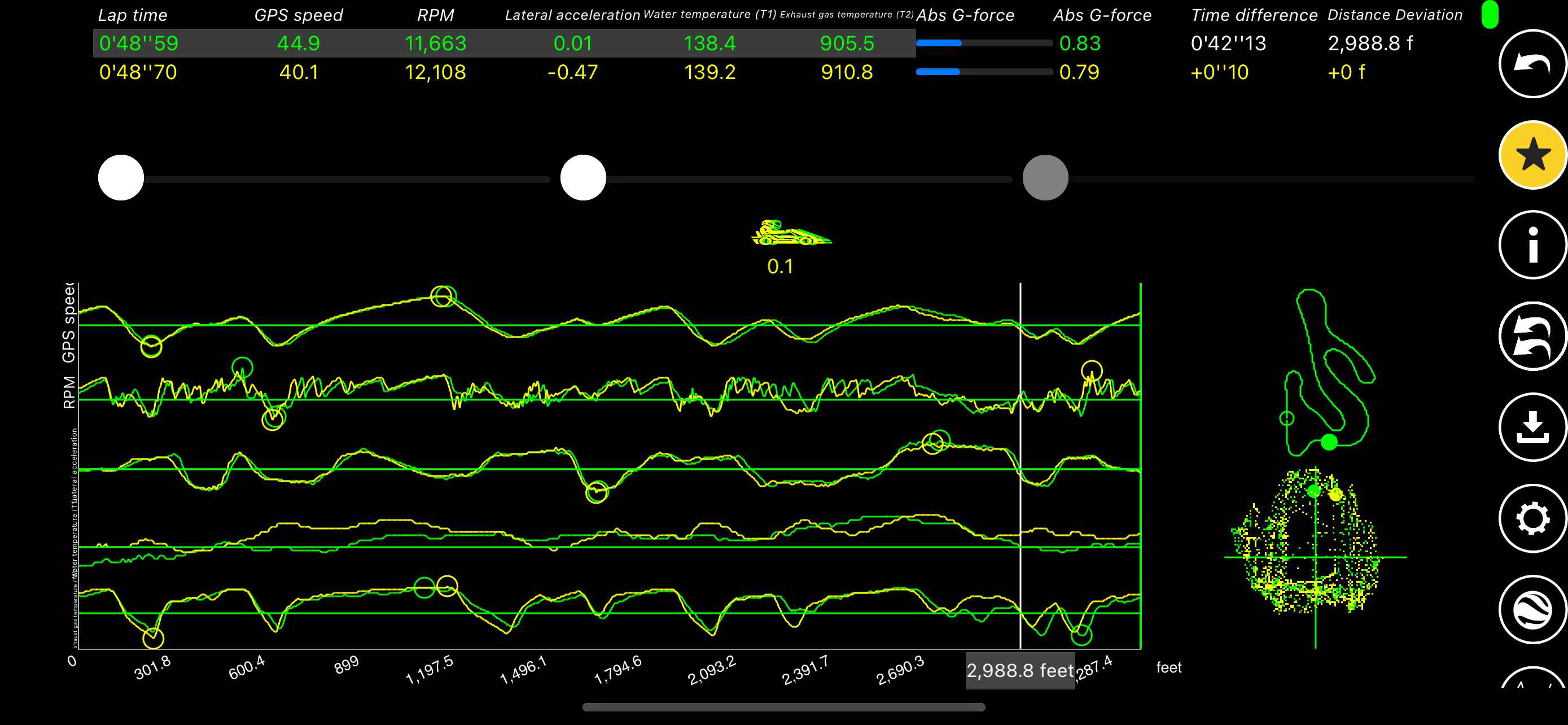

Braking (I see a pattern forming already). I am working on braking later and harder in the kz, and getting it rotated around the apex with that last bit of momentum.
These are laps from two practice sessions.
The green lap is a touch quicker and was with 2 sessions more tire wear. You can see I was going deeper on the brakes basically everywhere. I drove the tillotson for a year or so, and I am having to undo some of that style to get back in the “pocket” in the shifter.
