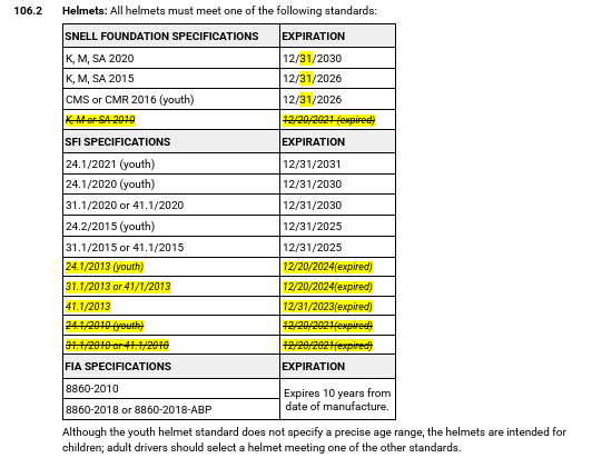

Thanks. I am looking at protective gear as I type this. I have a lot of gear from off-road racing. 'Not sure any of it is transferrable. I have a carbon fiber Alpine Stars neck brace that might work, and a couple chest protectors that have rib protection. Not sure the chest protectors will translate. Several very expensive high tech helmets, and none of them are snell rated.

As for the helmet, most clubs will accept anything that meets SKUSA/USPKS rules. Below is current listing of acceptable certifications:
