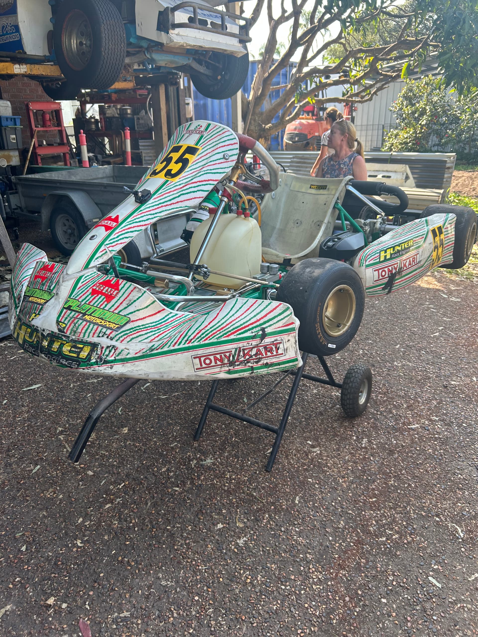

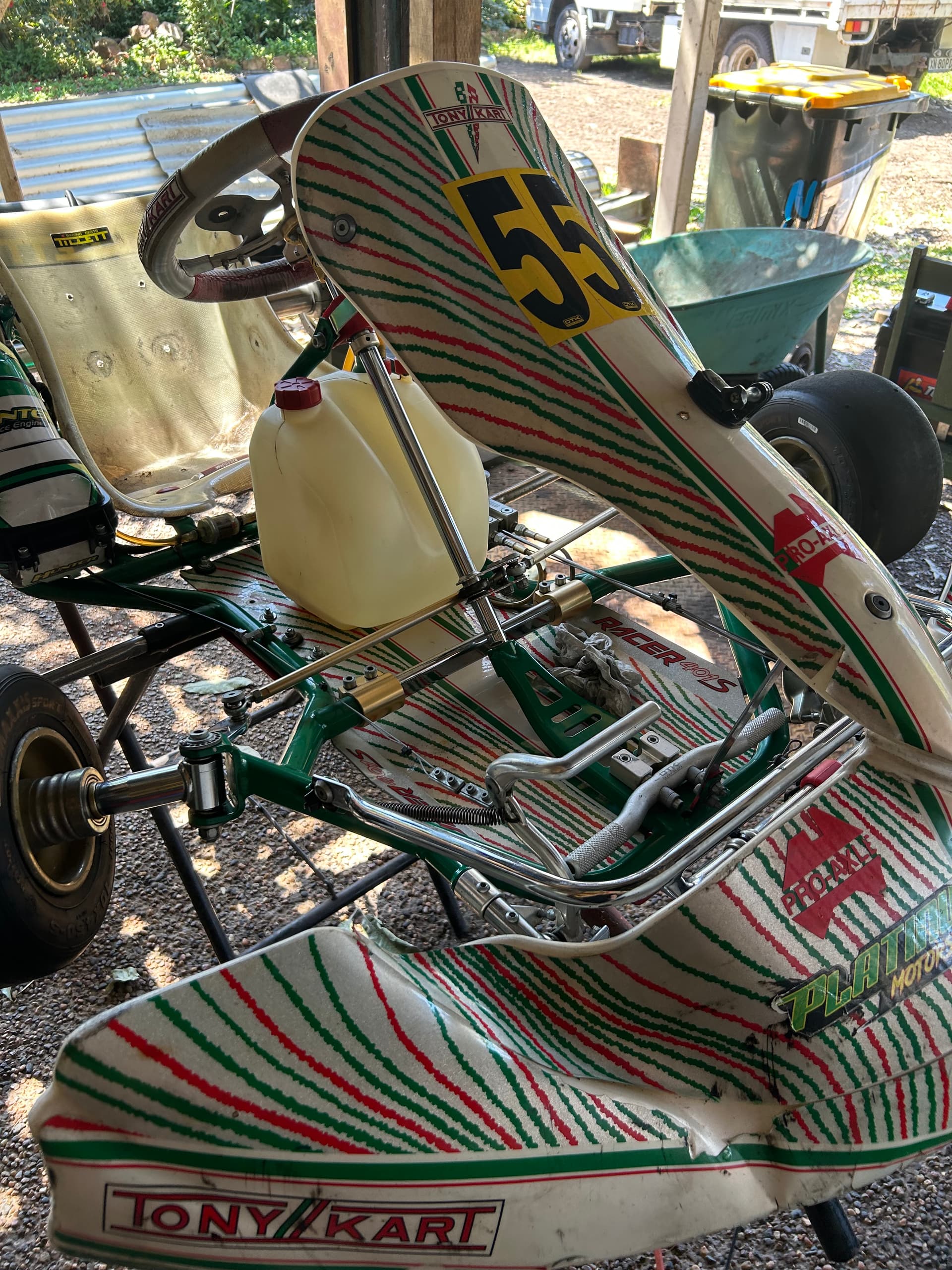

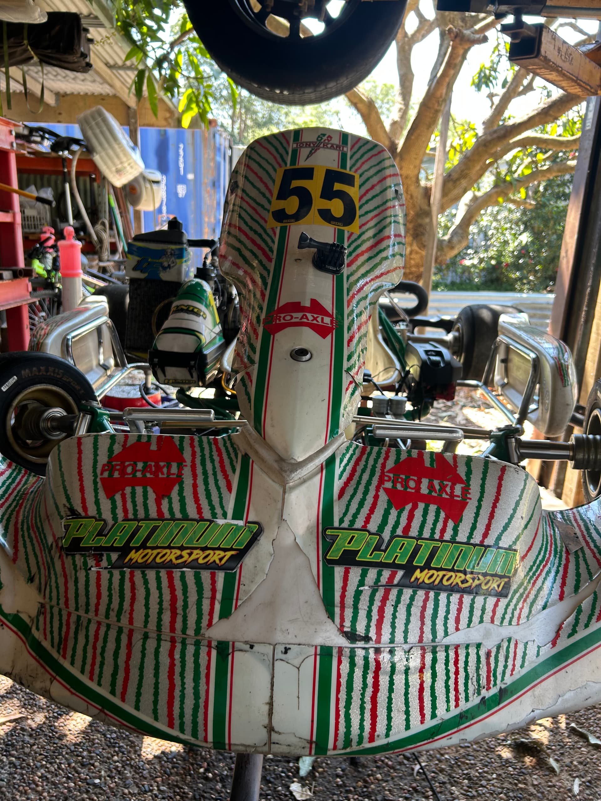

I’m interested in buying this kart, but the owner doesn’t have much details on it. I would like to know the year model, because my club needs to log your kart before you begin practice, and it is a mandatory section to add the year model. I found these words engraved into the chassis:
RACER
CIK-FIA 56/CH/14
CY22276
Im not sure if that answers my question or not, but that’s what was said on the chassis. And is CIK-FIA 56/CH/14 the model or is CY22276 the model, I also have to know that.
Thanks everyone.
Here’s what I found:

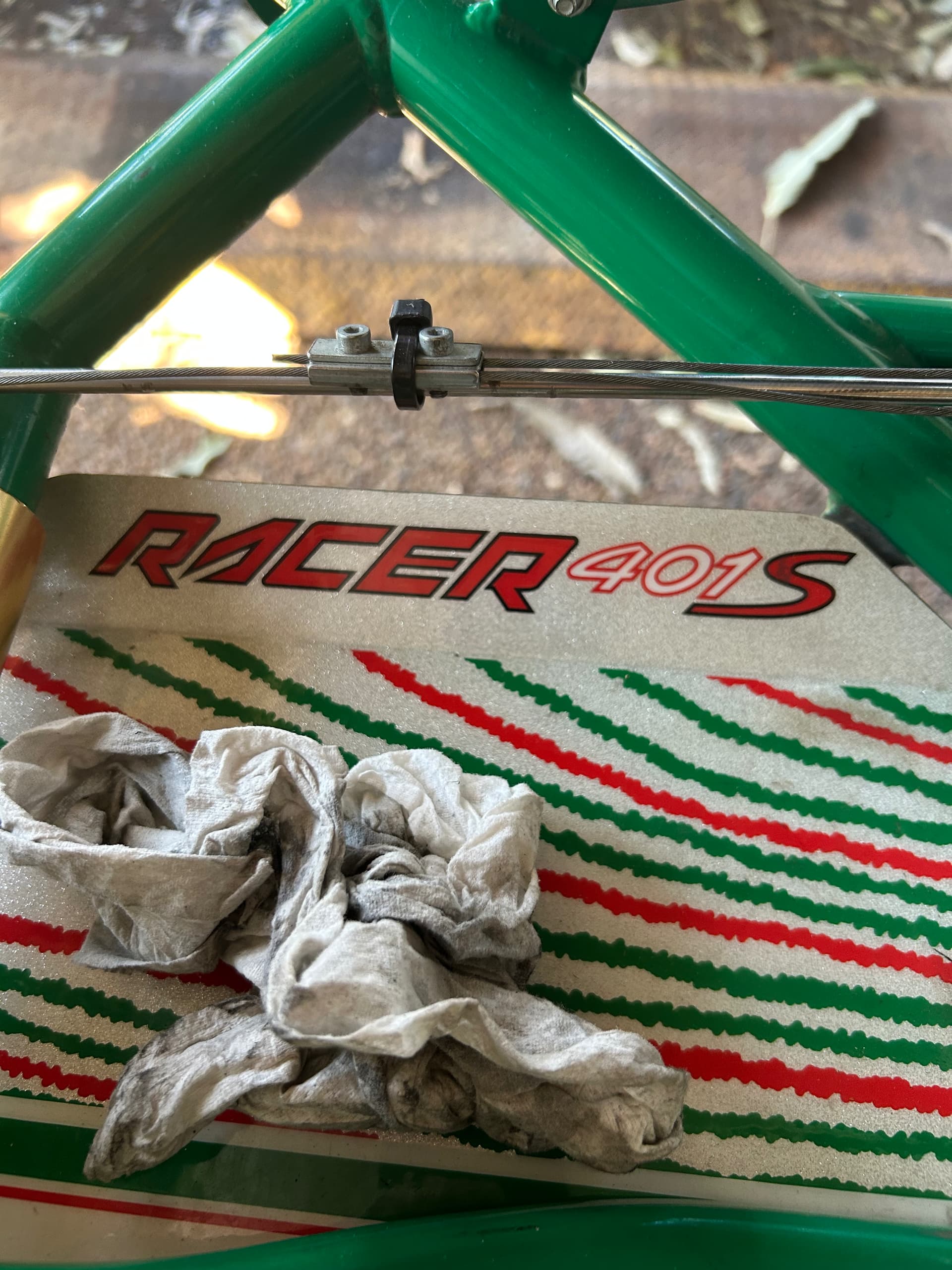

This is a Tony Kart Racer 401S - OK. The badge describes the homologation, “CIK-FIA 56/CH/14.” The 14 at the end means that the homologation was renewed in 2014, and lasted until 2020 (as per this article).
I can’t pin the exact year, however this article says they had a refresh in 2017, so keep an eye out for the changes, if it has them its 2017+, if it doesn’t its somewhere in the range of 2008-2017 from what I can tell.
CY22276 should be the model (I could be wrong on that, but there would have to be some other similar text somewhere on the frame). Here is the official Tony Kart page on the kart.
It’s a 401S so 2017-2018, plastics match the same period.
