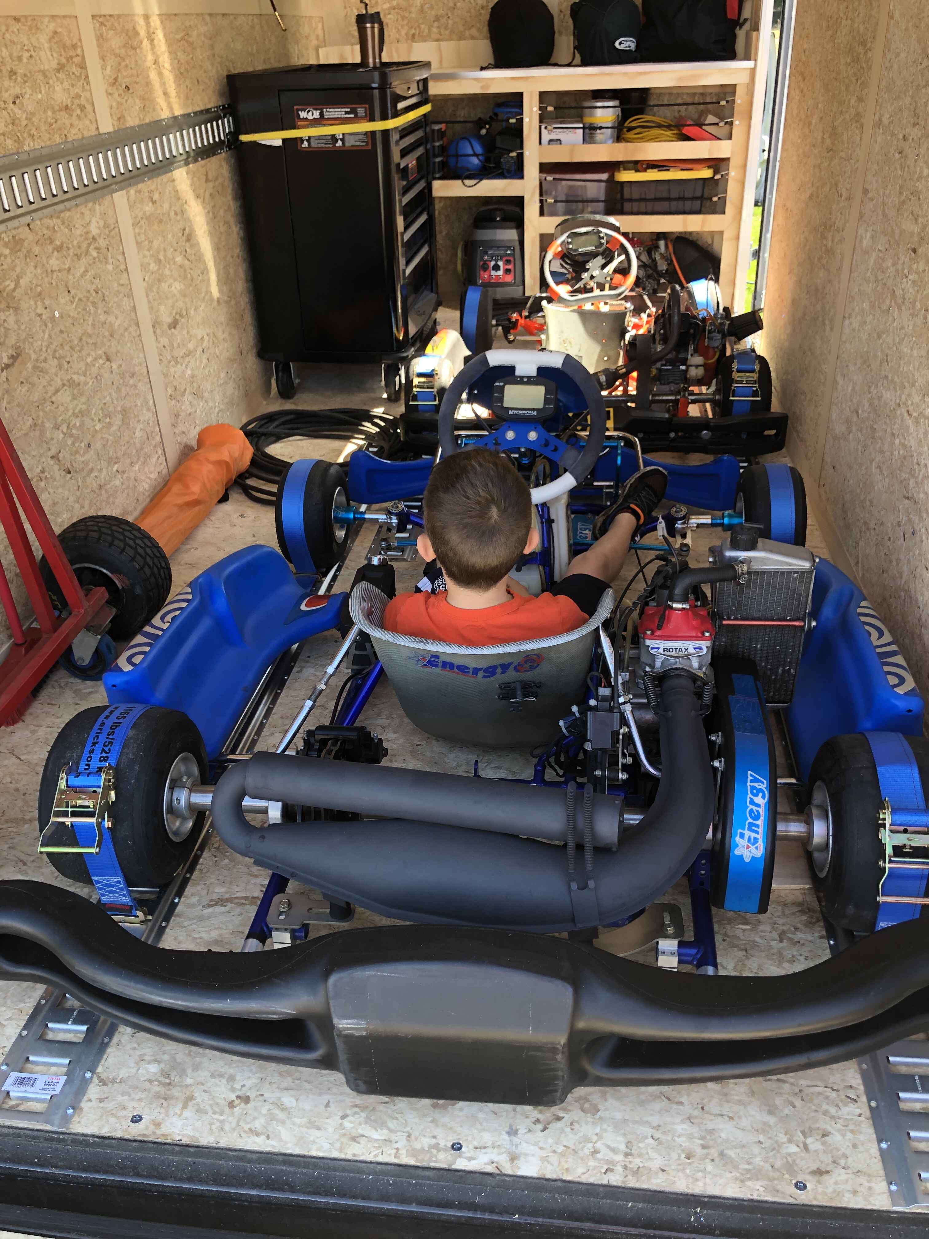

Im reviewing how i organize my trailer and am wondering if there is a better way to strap down the kart. Currently i set it on E track on the floor and run straps over the pairs of wheels on each side. Is this going to put excess stress on the tie rods, spindles, steering column etc?
I do the same, but with one strap on each tire. Never had an issue. I have also strapped to the frame itself, but it always weirds me out a bit when I see it flex as I tighten it down. It should be fine either way; I’m sure it seems more load on the track, but over the tires feels like the best route in my opinion if you’re strapping to the floor.

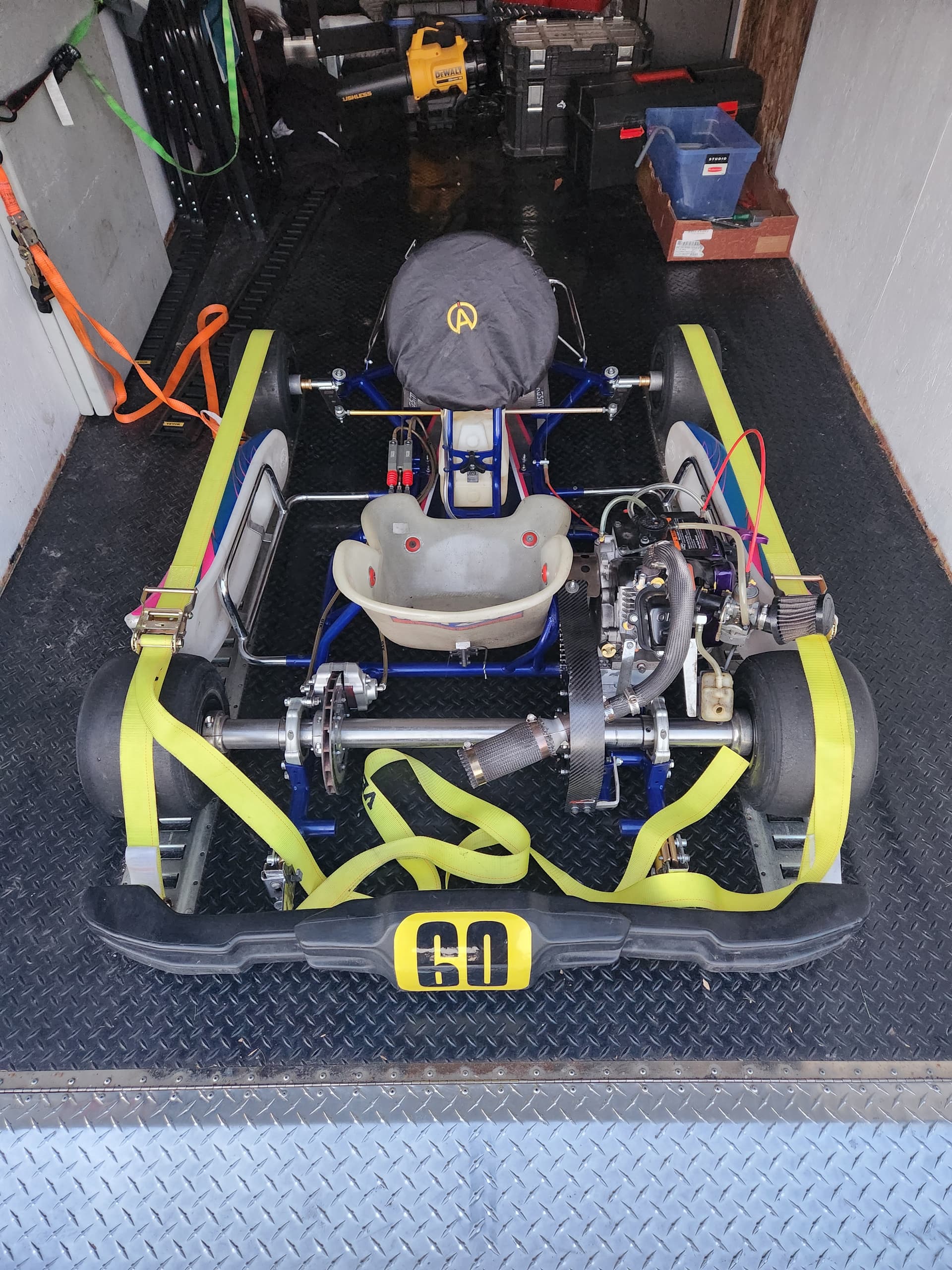

I use a single strap on each side. It pulls both tires down and holds them immobile. No pressure on the tie-rods.
This makes more sense to me. I’ll have to pick up some shorter straps.
Its not twisting the chassis, but when you tighten one side, it pulls that front tire back, then the other one when you tighten the other side. Its 100% pushing the tie rods against each other.

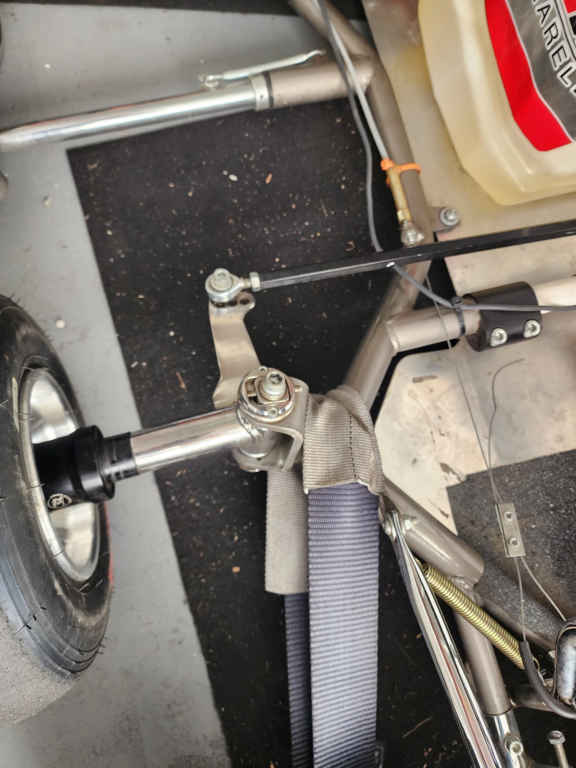

I put an axle strap around the actual chassis in the front and back and then put the straps to those. It’s on the actual chassis and just tight enough to keep it from moving. There is no stress on the tie rods.

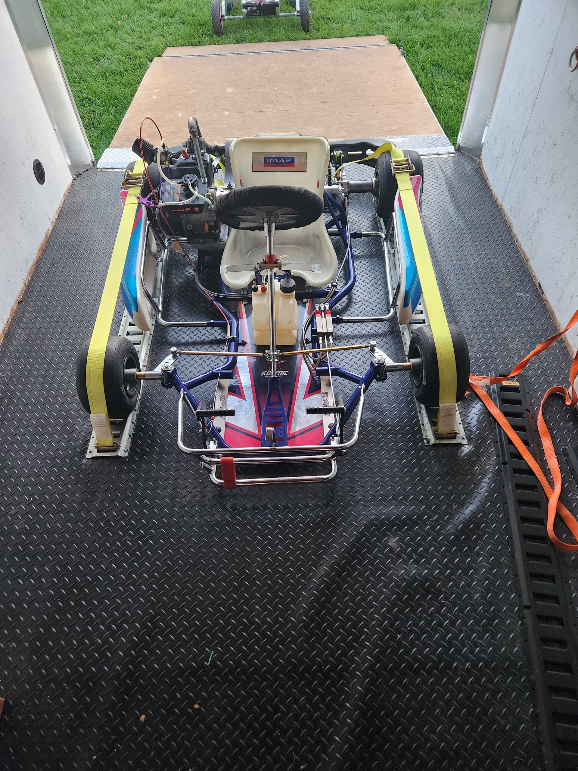

Yeah i posted 2 photos, straps over the tires.
