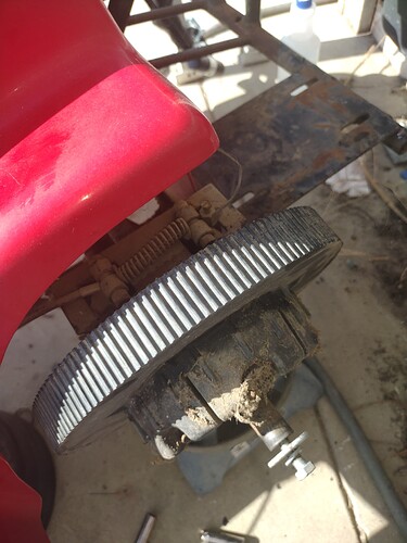

I just picked up a pretty cool Indy go cart. The original engine is toast. I want to run two engines on the back. I want to be able to start them via a button on the steering wheel. I’m thinking I’ll start by getting two (of the same) engines. Then fab up the frame to hold two engines. Then maybe sorce a steering wheel? Is there a good place online where I can find parts? I want to use a butterfly (detachable) steering wheel and a line lock to lock the front tires (also a button on the steering wheel). Any other builds like that out there? Which motor should I use? Exhaust options?

What is your goal? Just a fun toy for the yard?
What you’ve got isn’t a racing kart, so your options are pretty much open-ended since you don’t have to conform to any rules or anything. Whatever you can dream up you can do, assuming you’ve got the skills.
Just keep in mind that this thing was probably designed to go about 7 mph, so mechanical strain on the frame, brakes, tires, wheels etc. are going to be a concern if you start throwing a lot of power at it without upgrading things. I have no idea where you would source parts, but I would bet some actual racing kart parts could be made to fit on here. However, once you start upgrading all that stuff you probably would be better off just buying an actual kart.
Thank you. So I’ll reinforce the frame? I was gonna run a disc brake on the axle. Maybe an internal roll bar/cage. I was planning on changing the wheels and tires anyway.
Be careful with roll cage. If you think there is any chance getting upside down then assure belts will hold you below roll cage even when stretched. Other wise roll bar can place localized pressure and result in injury
To add onto what TJ said, if you want to go fast (2 engines), I would NOT do it with this kart. If you’re able to fab something up, you’ll be spending a lot of time fixing it when it breaks. Additionally, you’re likely risking injury to yourself or whomever else drives it.

How would I go about rebuilding these brakes?
I’m guessing these wires went to a starter solenoid (the run from a switch on the steering wheel and back to the engine.

Is this throttle linkage replaceable or can I order a new set up?
The throttle and brake are operated via hand levers (like bike brakes) on the steering wheel.
I ordered new cables and levers, now I need to figure out what to do with these brakes and throttle cables.
