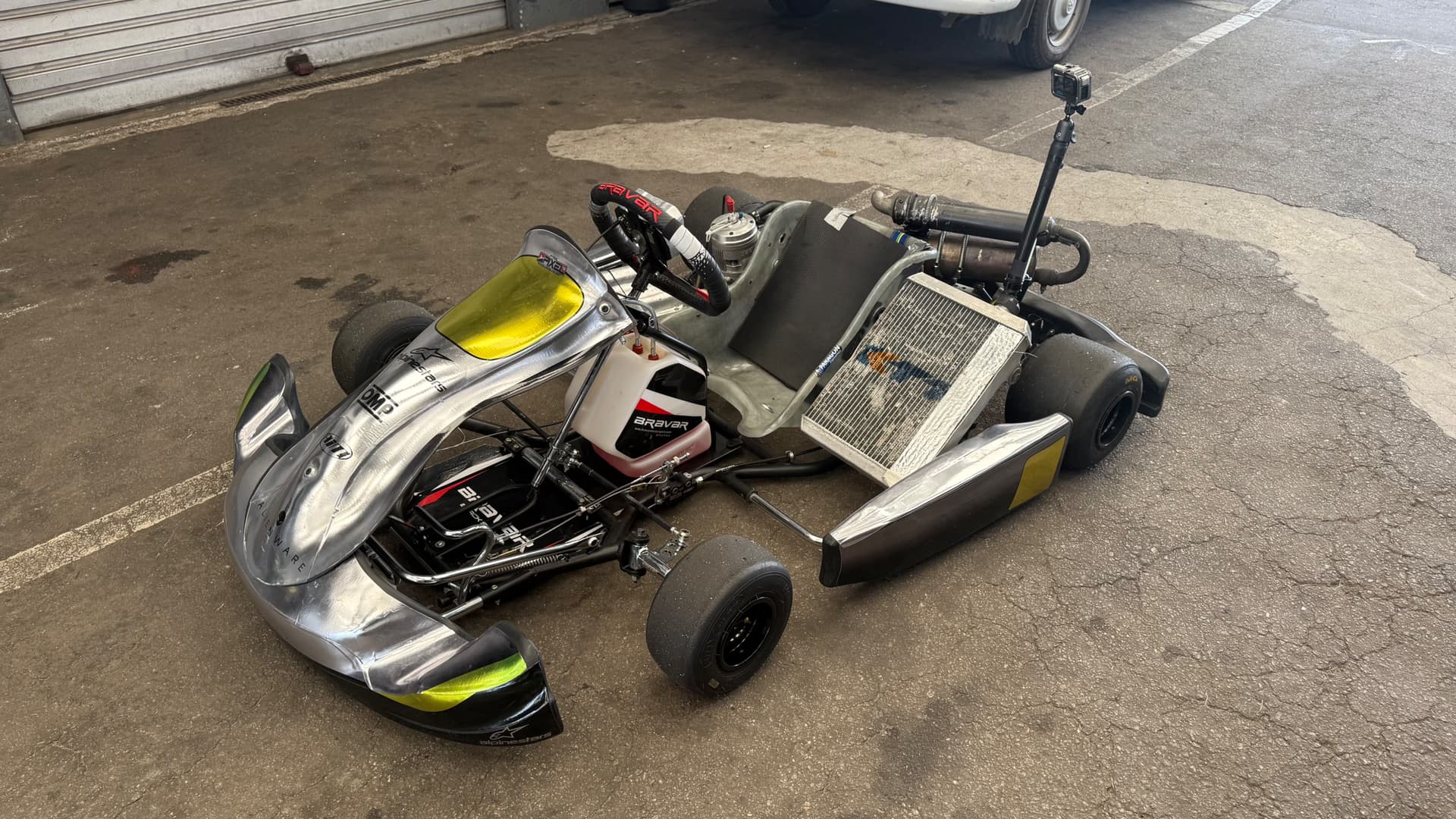

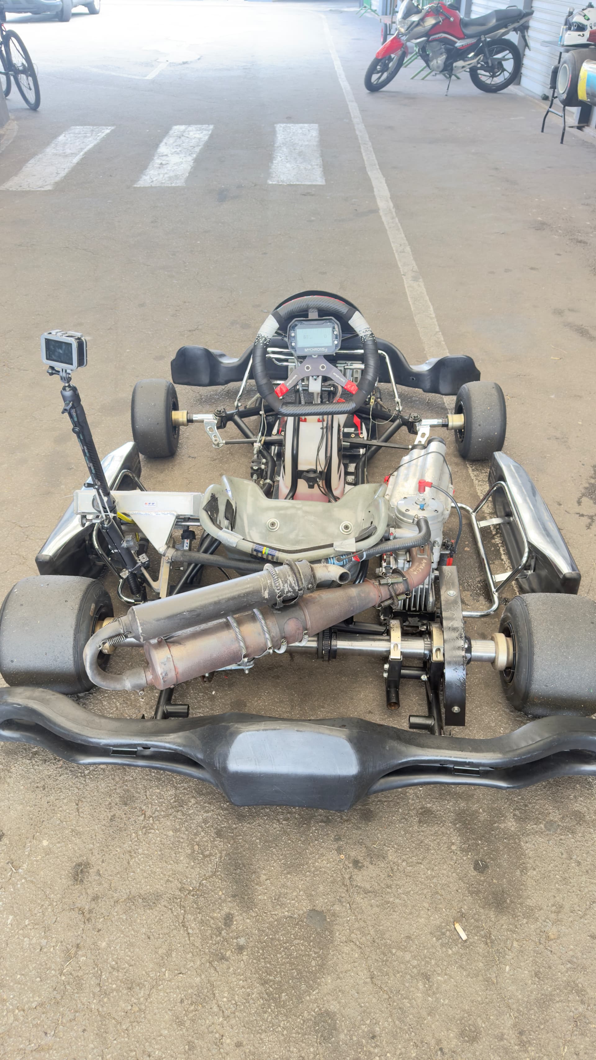

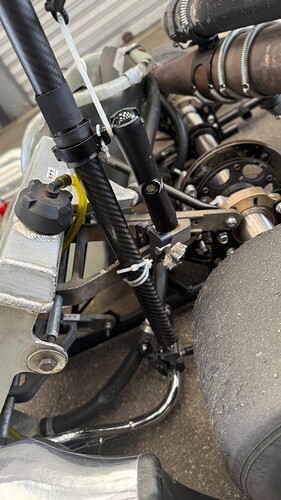

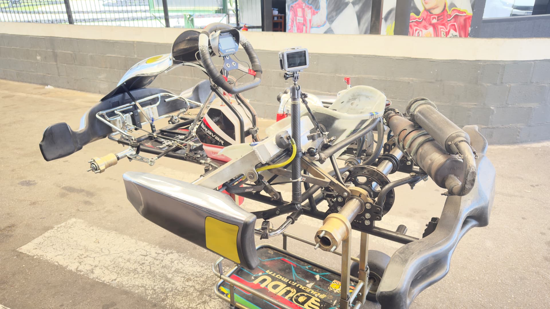

I use two cameras …InstaGo 3s inside the helmet and GoPro Hero11 on a carbonfiber side mount. For overlay , I use telemetry overlay, and VSDC to process the videos…results are quite good! I’ll share some links and pics!
Lap comparison
Is this CF mount something readily available?
I assembled mine using Fanaue parts bought through AliExpress (I live in Brasil)…but I found a CNC brand today called Bgning…they have it pretty much pre-made. You’ll just need to buy the clamp with 1/4’ inserts for 1” ball head …I have another post somewhere describing all the parts that I use…
