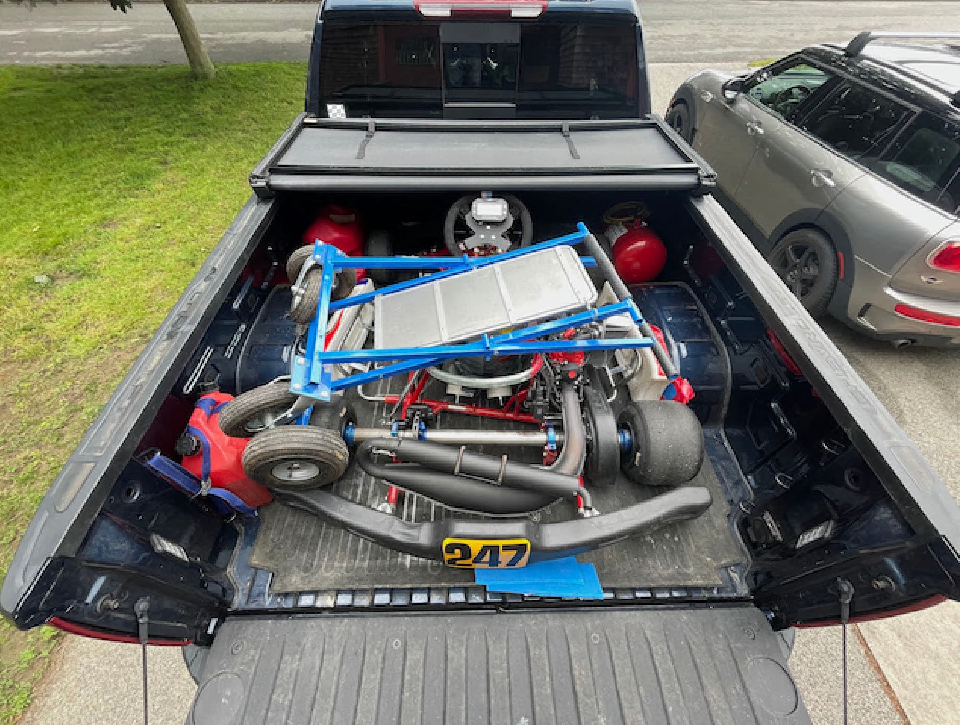

Not a F150 but a 2020 Silverado Extended Cab (not a crew cab) with standard bed – Birel RY30 fits perfectly – approx 1/4" clear at back of sidepods between bed wheelwells (I slip some foam between pod and wheelwell so the kart numbers don’t rub off) and the length is about 3/4" to spare to shut tailgate – the 2 pieces of blue foam at the rear bumper get placed between bumper and tailgate to keep the kart from bouncing back and forth – 4 big tupperware bins in rear passenger compartment for tires and gear
