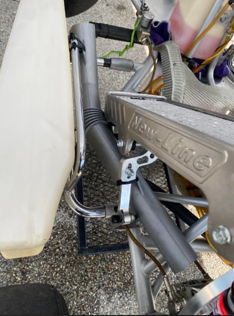

Kart is a cadet size with 65cc shifter, rear brake only. At a track that he was doing a 60s in a mini, he was able to pull of a 57.5s with the braking issue in the shifter. This was after adding the OTK brake duct, which doesn’t fit well and he still complained of the issue. Earlier in the day I rebuilt the master cylinder because the pad was not returning off the rotor - that seemed to fix the pad problem.
Any other ideas to explore before simply saying the motor is too big for the brakes?

The issue from my standpoint is the heat. The issue for the driver is extended braking distance in 2 corners. He stated that he needed to brake MUCH earlier than usual to make those corners (6 and 11).
How does the rotor look? Is it discolored from heat? This seems like more of a mechanical issue besides the rotor being too thin.

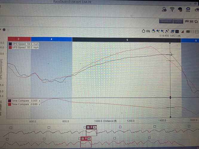

Can you see this lack of braking performance in the data trace?

I will try to get a look at data in the next few days. I do not have any pedal sensors, and I am not used to looking at shifter data, so it may take some thinking.
You’ll just need to see if the slope of the lines are the same from an early lap to later lap when he has the braking issue.
If the brakes are actually giving up the line should be less steep showing he can’t brake as hard.
What is the condition of the other parts of the braking system? Is there any spongy feeling in the brake pedal, has the brake fluid been replaced with the correct type, how worn are the pads, is the rotor cleaned before each session, and has different positions of the brake rod been tried ?

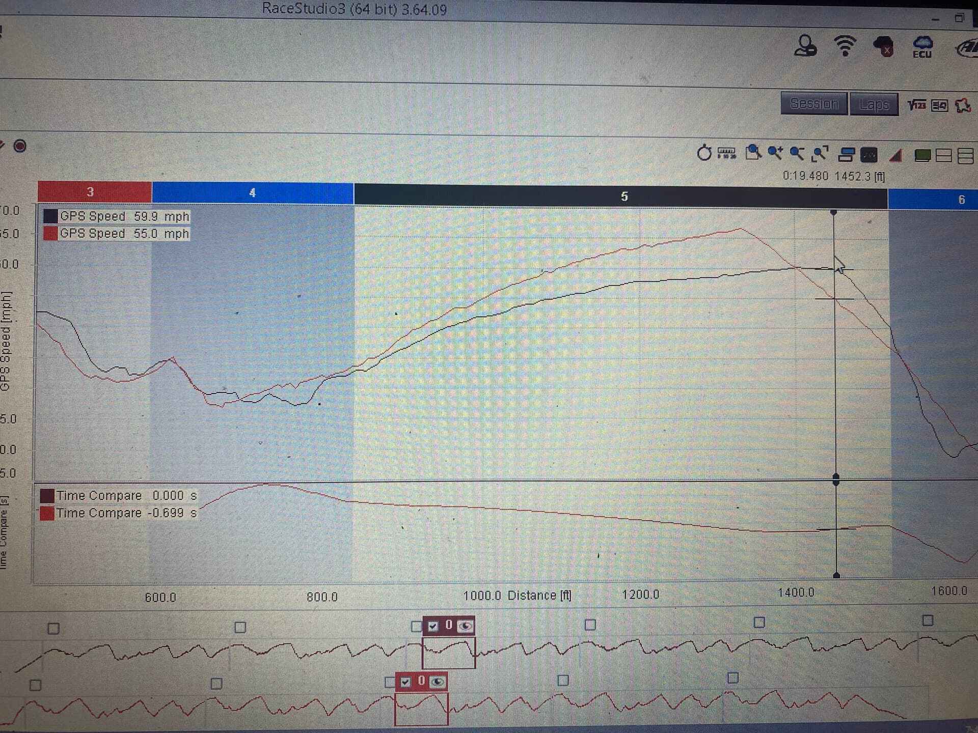

This is a comparison of the shifter in red to the mini in black. Unfortunately I don’t have a good lap in the shifter because he was complaining of this instantly. On the brakes almost 100ft earlier, which close to twice the normal distance. Is this brake fade? Is this something new to shifter drivers face with braking and down shifting?
Is this something to do with engine differences? Not used to the shifter engine braking feel vs a clutched engine?

I will double check everything - but I usually leave the brake rod on the top hole of the pedal. This is how he was always driven a kart and he can lock the brakes no problem. During the morning of the session I rebuilt the master cylinder with all new seals and bled with fresh fluid based on his complaints. There was no sponginess, and when he applied the brake, the pedal was stiff. There are no leaks at the cylinder or caliper. I switched to a second set of pads, which were a little less used, same problem.
The only thing I did not switch was the rotor and I can tell it is worn. So no matter what, I will be doing this for the next time out. Just curious if there are any other ideas.

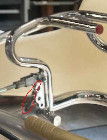

It isn’t something silly like the pedal stop backing out and limiting brake travel? Pretty common little annoyance when you build up a kart.
100 ft. difference in brake point seems very extreme, so I would say something is up mechanically. I don’t think you can put that down to weight or a different braking style for shifter.
I haven’t scaled it, but I think slightly. It doesn’t feel much different from his mini when lifting to the kart stand other than the right side bias. When he picked it up in the front he didn’t think it was any heavier. My guess is 5 to 10lb more at most?
Do you mean that little guy? I will look again, but when I was bleeding them, it felt normal, like there was no mechanical getting in the way. I can always get them pretty stiff and then get like one tiny little micro crick out of them if I press harder.
Mechanically, I keep thinking it is the rotor since it has worn. And the cylinder has been rebuilt. I don’t see a need to rebuild caliper seals and all 4 pistons are popping out. Only thing left is rotor or the fact that they could be overpowered. Or the rod location.

Just bumping this for the resolution. I replaced the pads and swapped to the floating style rotor hub with a brand new rotor. I also added/repositioned the brake duct to help with cooling. This seemed to do the job! Braking was much closer to the mini location than the prior outing.
