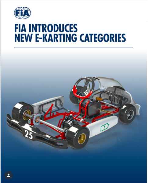

Would it be possible to discuss this like grownups? :-)
https://www.instagram.com/p/DP4LIfmjalp/?utm_source=ig_web_copy_link

I’ve yet to find much information other that the very undetailed image and some post text… Is there more info I’m missing. Like, what was even approved?
As manufacturer, we have nothing on this. But the idea is not bad as beside chassis , engines (or as you want to call them) are supposed to be fixed and that is consistent with cost reduction..
YEAAAAAAA !!! They have finally accepted us who love EKARTS !!! Be glad to just excited !!!

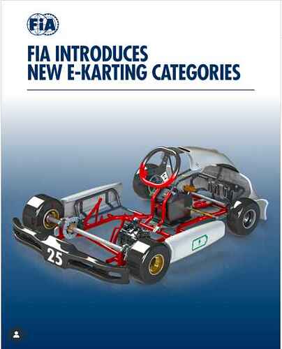

Heres more all I can find for now

I’ve driven the Blue Shock package and it was a blast. I’ve worked on lithium ion battery system design in the ground-based EV and aerospace world for 10 years, and the biggest issues I see with the FIA regs as I see them presented here:
>Mandating the battery volume as being effectively just the existing fuel tank volume: I can understand not wanting batteries out on the chassis sides, in the region where the side pods normally crumple in large collisions, but there’s simply not enough physical volume in the fuel tank area to fit a pack that can output 28kW (38 HP) for full length races without doing a pretty deep depth of discharge (effectively using most of the pack energy in a single session). If you look at what Blue Shock or the F.A.T. league uses, they’re putting packs on both sides of the driver (because they need the volume) and they only partially discharge in a single session. (I think I was burning like 20% of a charge in a 5 min warmup session. Smaller pack means less energy, which means using most of the pack every session, which is harder on the long-term performance of the cells.
>Limiting the pack voltage to 60V: I know there are safety guidelines that consider anything over 60V as hazardous and thus worthy of extra safety, but such a limited voltage for something that’s going to be pushing 28kW seems a little mis-sized. Even at top voltage that means a 466A current draw at full power, and definitely 500A and more as the voltage sags. That’s a LOT of current, and will require some hefty HV cabling, and more robust and expensive contactors, current sensors, speed controllers, etc. and generate a lot of waste heat. Even just doubling the voltage to a modest 120V would keep the current draw under 300A and reduce the heat load by 4x.
I’m excited to see what people come up with for this, but I’d really like to see the full technical regulations first because there’s definitely some engineering challenges with these restrictions to make a system that isn’t prohibitively expensive.
