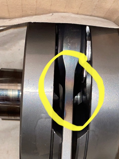

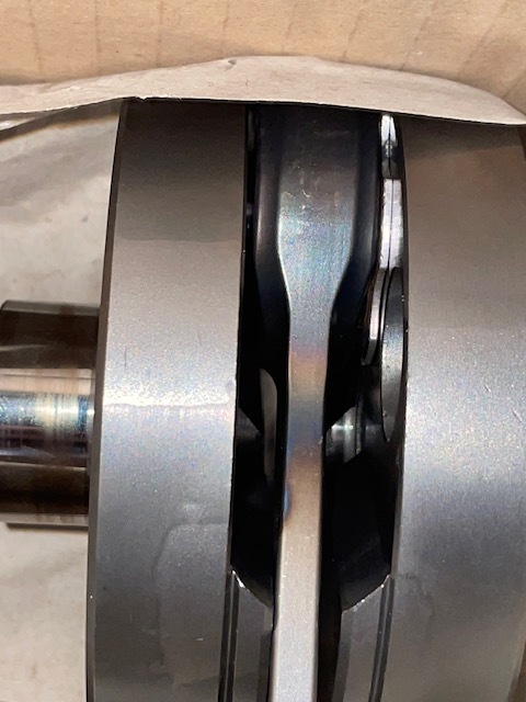

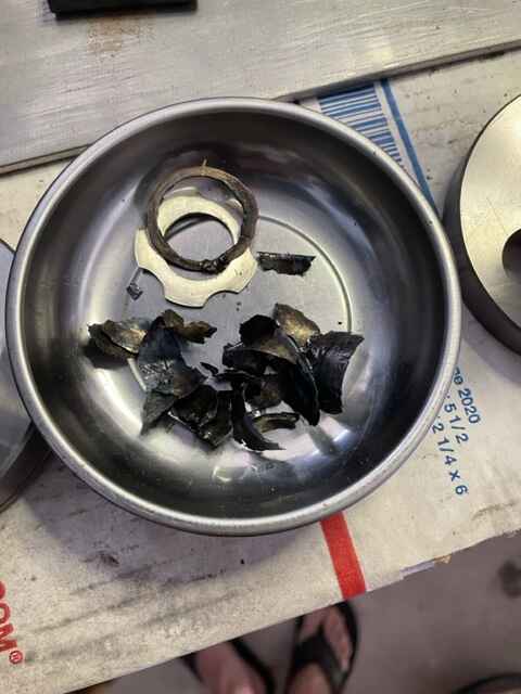

bellow are pictures of the last failure. One of the thrust washers is gone, but I feel likely that happen after the roller bearing failed

Jorge can you confirm the oil and ratio you are using? It’s interesting in that I can’t see much in the way of heat buildup in what’s in the pics.
He said he was running 6.4oz of redline per gallon of fuel
@KartingIsLife is this what too much heat does? Metal seems discolored in a certain area.
hi, yes. 6.4oz per gallon, so 20 to 1 ratio.
all the failures showed the same discoloration on the connecting rod and as Andy stated, to me it indicates how hot it got. i attached another picture. this one of one of the previous failure. its what was left of the bearing.
