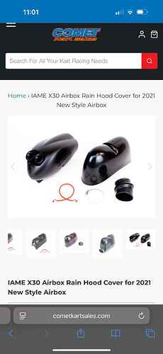

This is the exact kit I purchased from Comet, I have it strapped as well as zip ties to the Airbox (without the filter, as it came)

  3. Taped the Airbox rain hood all around

Didn’t run a filter
