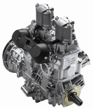

It might be a feasible in one of the commercial classes (Rotax, X30, Vortex) but out of those only Rotax has the industrial might to make it affordable out of the box, and they have a division that does it for outboard boats and skidoos. They’ve still chosen not to do it, yet. I think its more likely karting will skip EFI (or other such enhancements) and go straight to electric, which is what rotax have/are doing.
The interesting thing (for me) about the skidoo engine is the top end bares a remarkable resemblance to the rotax max, I wonder if it you could just machine a head to fit the injector.
It would be all calibrated wrong but interesting.
