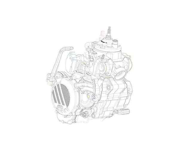

The Austrian manufacturer is well-known for its revolutionary advancements in technology and now the game-changer is finally here with 2-stroke fuel injection Enduro models being launched as part of the 2018 EXC range. With KTM’s unwavering commitment to being at the very forefront of offroad motorcycle sport, in which the orange brand has achieved many championship wins over the years, the latest, exciting development in technology has come to fruition.
It has been no secret that KTM’s Research and Development department in Mattighofen, Austria has been developing this technology, which offers considerable benefits over carbureted models including drastically reduced fuel consumption while also no-longer having the need to pre-mix fuel or alter the machines’ jetting. Not only that, the new 2-stroke TPI models offer a completely new experience in terms of power delivery and rideability, which once again demonstrates KTM’s commitment to its off-road roots, continuing on from the all-new generation of Enduro machines released last year. As market leaders in this segment, KTM believes the new 2-stroke fuel injection technology, known as TPI (Transfer Port Injection), is revolutionary. More information will be available during the international media launch, which begins on May 15, 2017.
Joachim Sauer, KTM Product Marketing Manager: "This is an incredibly exciting development for KTM. We have been developing 2-stroke fuel injection for some time and our goal was to create competitive motorcycles with all the benefits of fuel injection, while fitting into our READY TO RACE mantra. There has been extensive testing and considerations for our Research and Development team to take into account during this process, so we are very motivated by this next step and world-first in technology, as we take a major step forward in this segment. We are certainly looking forward to unveiling the new 2018 KTM 250 EXC TPI and KTM 300 EXC TPI machines in May. In Europe the bikes will arrive at the dealer floors in early summer, and in the U.S. and Canada, the new 2018 250 XC-W TPI will be available in very limited quantities in late fall.”

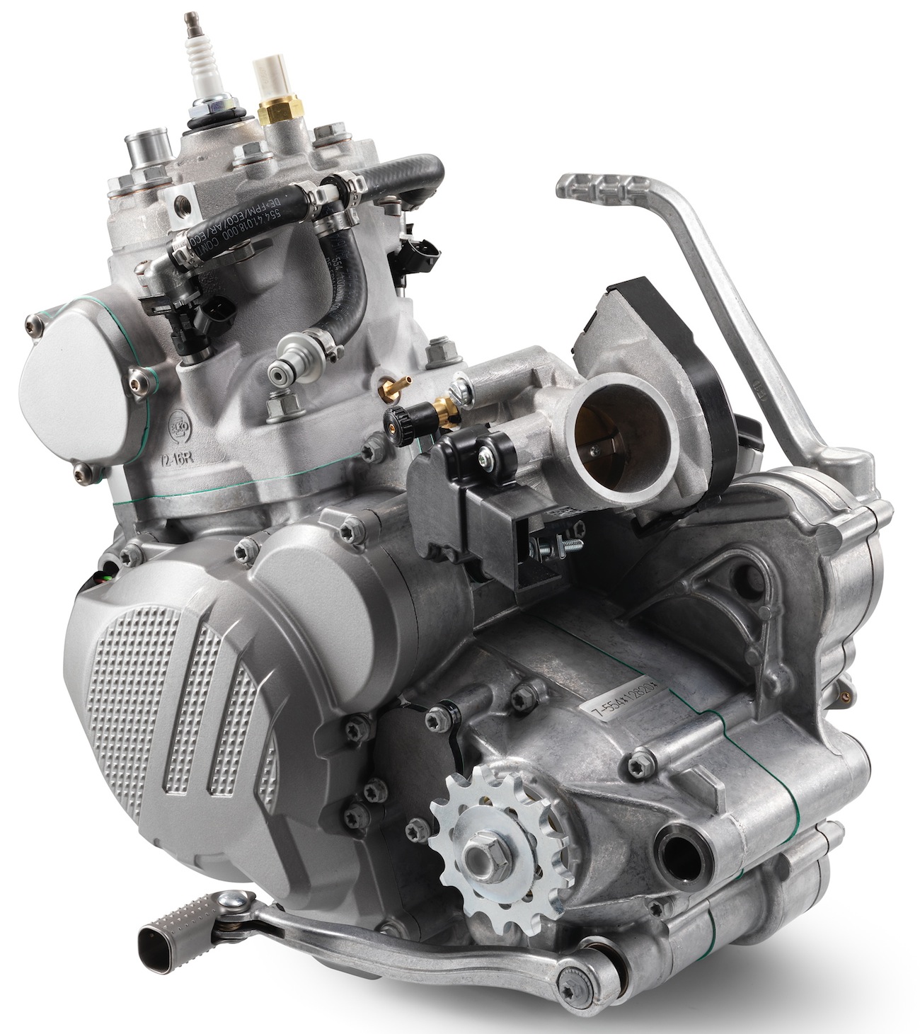

Some details:
  • 250cc, reed valve induction.
  • Six speed transmission.
  • Electric Start.
  • Balance Shaft.
  • “Synerjet” ECU controls everything on the engine via five sensors—intake air pressure, oil temperature, barometric pressure, throttle position and water temperature.
  • EFI with electronic power valve, no premix required.
  • 2x Fuel injectors.

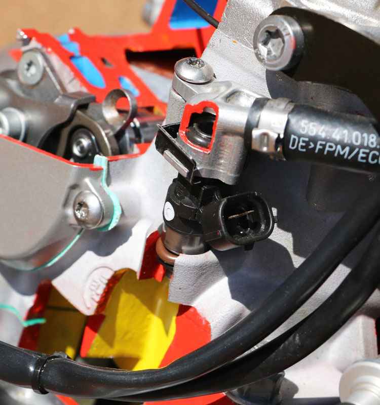

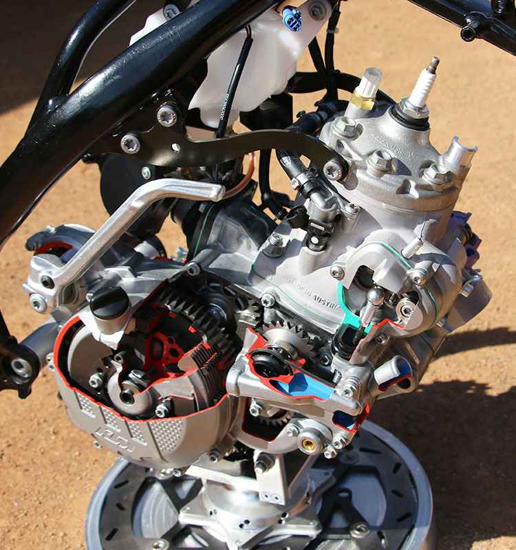

Maybe I’m not looking at the picture right, are the injectors going into the side of the cylinder?
So its not direct injection, its port injected into the intake ports of the cylinder?
Coool.
Spot on. Fuel is injected into the transfer ports. Not sure where oil is admitted though.
I would assume the oil just sits in there like a 4 stroke would. I guess there must be a direct link from the carb to the intake ports rather then swishing around the oil filled crankcase.
No it’s fed oil separately. Just not sure from where. Maybe the little spigot at the back of the jug. That mightn’t do much for main bearings though.
It looks like it has a little oil fill hole (with a plastic screw in it) just to the left of the gear change mechanism?
