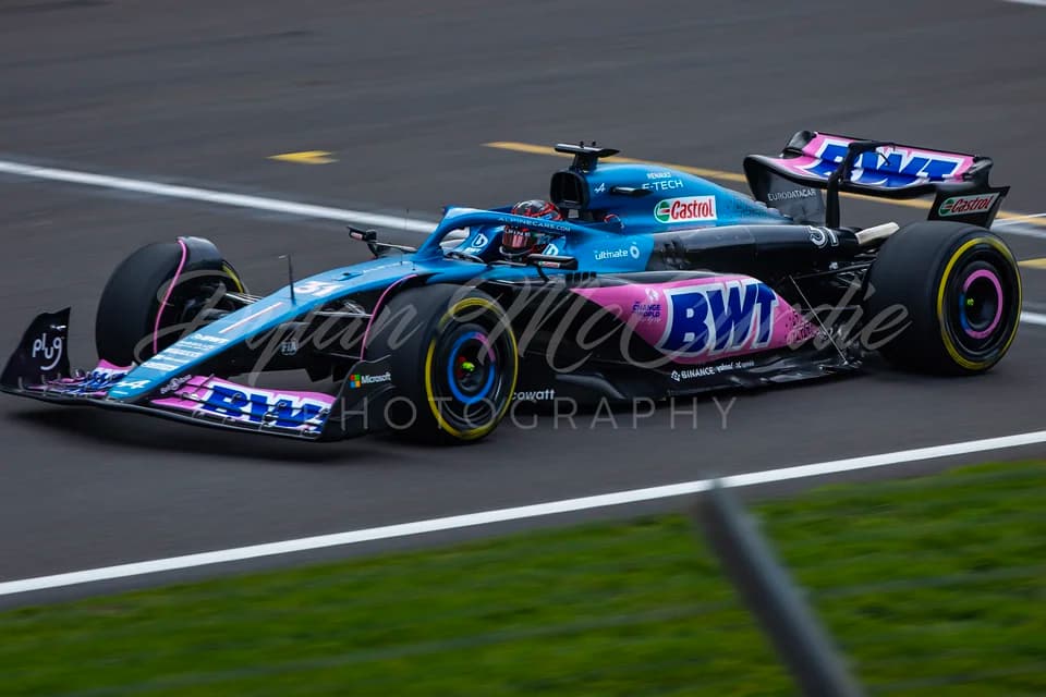

Spy shot of the Alpine A523.
The bulge on the engine cover looks like an old F3 car:

Also just saw this big honkin’ bulge on the Merc engine cover too, similar to Alpine:

The Upper Pod/2nd Pod/Shelve between merc and alpine is very similar. Infact the entire roll hoop back looks that way.
