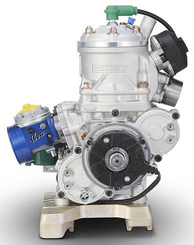

Any idea which carb option will be adopted in the US?
I would guess each manufacturer would have their preferred carb to match the engine. Looking at Vortex’s page their OK engine comes with an Ibea carb.
The OK has to run homologated butterfly carbs.
I think it’s referring to the FIA stating it’s up tot he ASNs to decide whether to go with float carbs or butterfly. I suspect and hope the latter will be the preferred choice. Why the FIA have this option is beyond my comprehension.

As i had hinted at some point throughout the thread, it is impossible to give a firm purchase value for the platform at the moment, until the engines actually go on sale. It is highly probable that manufacturers will offer Engine/carb/exhaust packages along with naked engines as well. Nevertheless, i would expect the cost to be around the OK-J mark, for all of them.
Moreover, we did (by homologation regulations) fix the cost for the homologated OK-N carbs, at 200 EUR (exc VAT). This was done to counter (albeit incredible in design, performance and construction) the forged OK and OK/J carbs used today, which cost a big chunk of money. There will be two homologated butterfly carbs, and one float chamber. It is up to the ASN to decide which type to choose.
Regarding the 2024 OK-N World Cup, the idea is to tech one engine, one chassis and to be given 1 and half set of tire from qualy to the final, to reduce cost, along with starting on track running on Friday only. Engine make obviously open to your choice.
To help launch the class, all things relative to the OK-N have been made free to homologate by the CIK.
The caveat being that the OK-N is born from the same platform as its OK big brother, which has an associated homologation cost. This means that the OK-N cannot theoretically exist without its OK derived homologation. (OK engines will be marked as 032-ES-XX while the OK-N will be marked 032-EN-XX. The “XX” value, which is the randomly generated number attributed to all homologation, will be the same between the OK and its OK-N)
OK-N carbs and ignitions’ homologations are also free.
