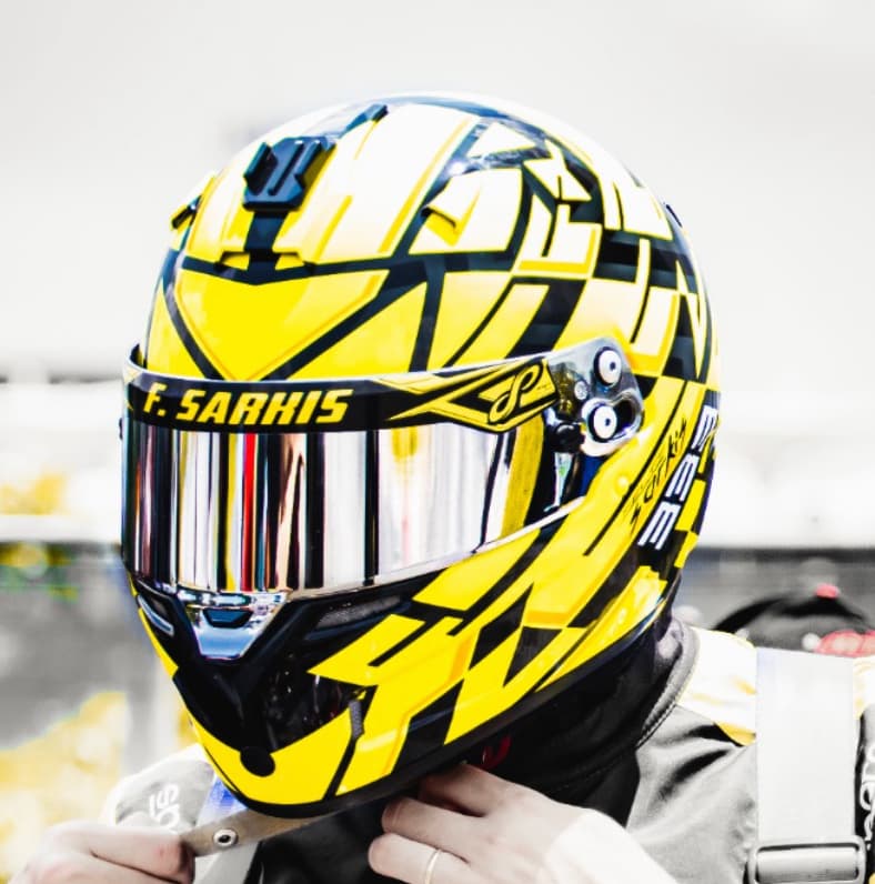

Any tips regarding inputs or something else?
It’s not rotating in my head. This only happens when I’m filming with this heavier case (water and wind proof) and I guess the mount is located in a place that unbalance the helmet I guess. Look at these pictures

oh ok cuz on my old zamp i had the same issue

Only time ive had mine move is at speeds over 70mph. other than that it should never move.
@FSarkis see if your helmet has replaceable pads of different sizes
