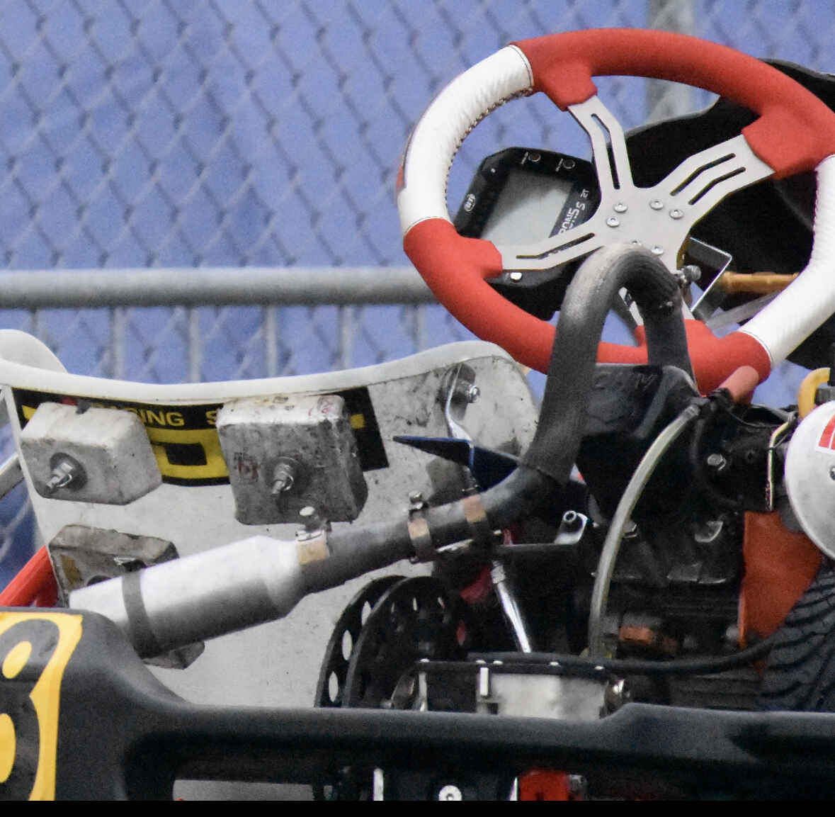

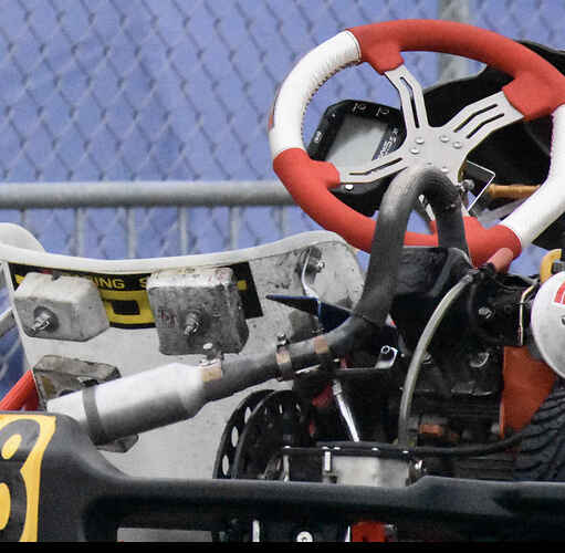

I actually first tried a sprocket guard, and that was a horrible step back. I must run lower ride height in the rear than most or something, but it would catch on the curbing and bend. It caused more problems than not having anything and even bent my sprocket. That carrier is now a permanent part of that axle, too.
I am still entertaining the idea of running a guide instead of a guard, but I have not had a need since getting the Odenthal dialed in.
Interesting I run the generic plastic one, have also ran chassis lowest setting in the rear without issues. I also don’t hit the curbs much for 206 at my track
Maybe just bigger curbs where you race but that seems like your pretty far on the curb if the sprocket guard is hitting it
