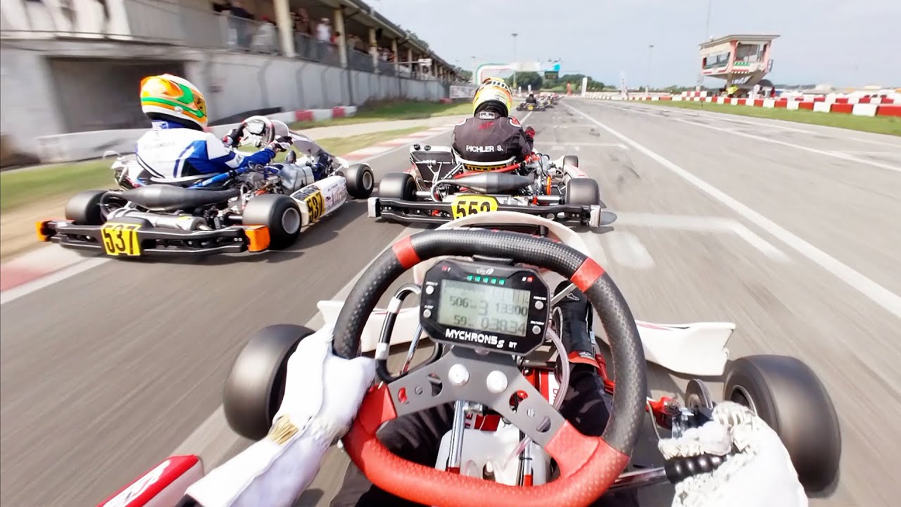

Hi what camera would be best for kz to get full pov and where to mount? Any suggestions and experiences appreciated
Example of a great view
That appears to be a chin mount and some sort of gopro on the wide setting.
Looks to me like there’s some color grading in post production.
@nikspeeds think there’s ND in use here?
I personally am a fan of the max lens mod which increases field of view to about 120 degrees. I have not tried it with a chin mount.
The issue is that many series mandate where the camera has to be mounted. I think in the states pro type racing it has to be mounted on kart using a bracket in a specific place.

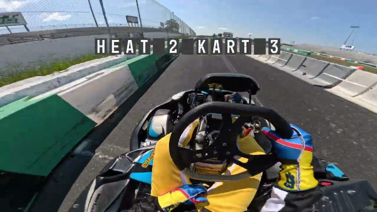

Hero 12 with max lens mod helmet mounted. Not chin.
@nikspeeds
Hero 11 chin mounted normal lens:
It does look like a chin mount as our neck nuggets are good at damping vibration. Make sure you can run a helmet\chin mount as not all organizers allow this.
For the camera itself, I guess it’s hard to know for sure. Maybe see if you can contact the creator?
Looks like some post processing but I don’t think ND filter, just because there’s almost no blur in the edges of the frames if you pause the video at various points at 60fps.
