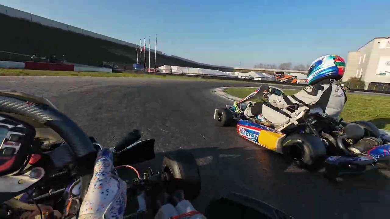

The difference between newer GoPro built in video stabilization and old is pretty remarkable. Two videos I recorded this year on different models:
Hero 10:
Hero 5:
I’ve time-stamped the exact spot that I want you to see.

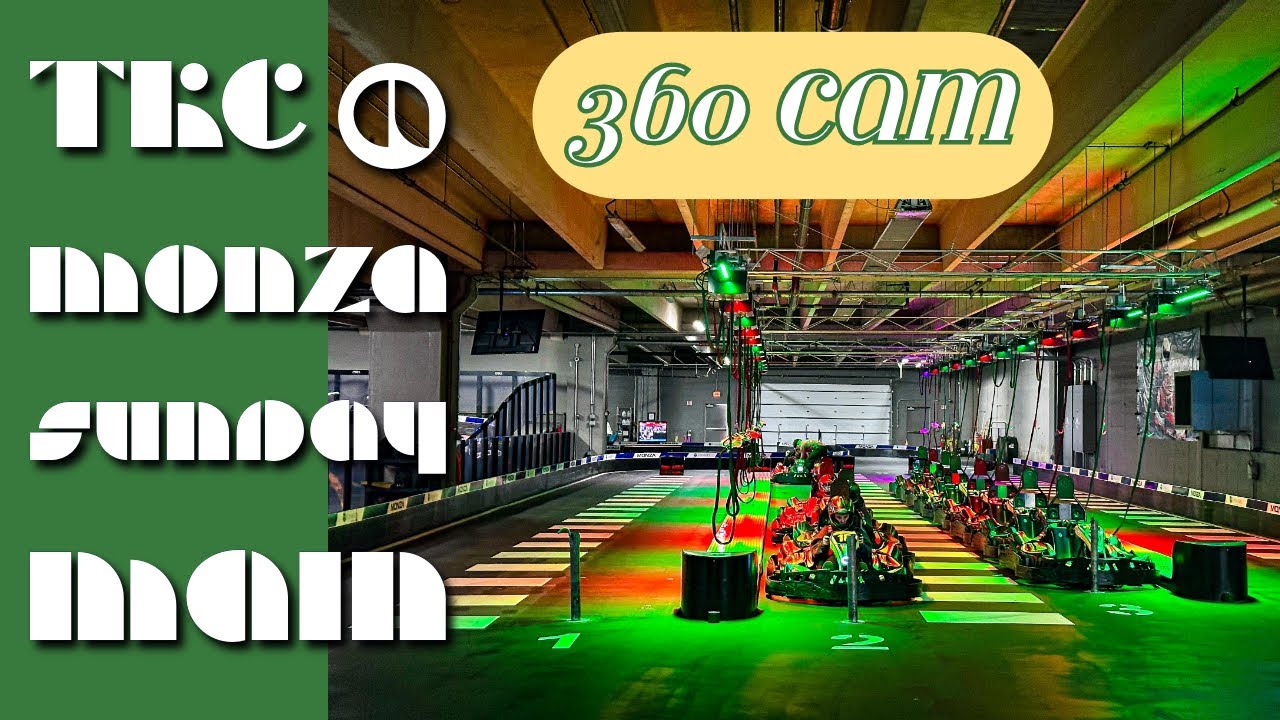

It’s nice being able to show what’s going on in the race around you. Here’s a good example of a busy race with packed action where being able to see behind and to sides makes sense.
But that’s really more about entertaining my fellow racers than providing me with a training tool.

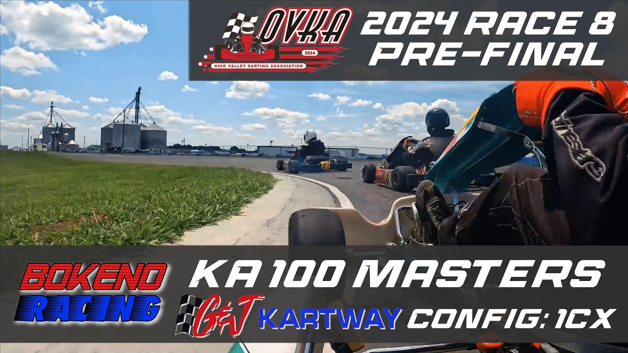

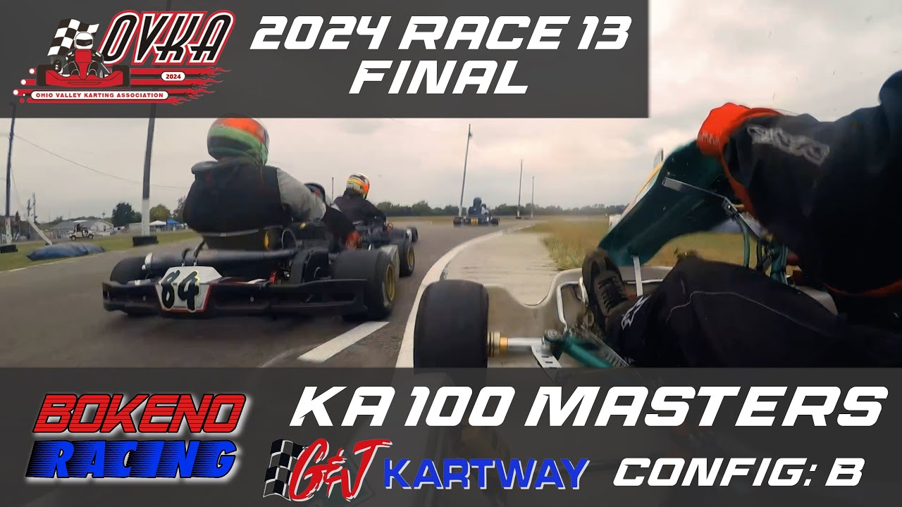

The normal footage, which doesn’t require me to spend additional time staging the footage looks like this:
The regular cam is probably the way to go unless you are hoping to get views and stuff and want to make ā€œcoolā€ footage.

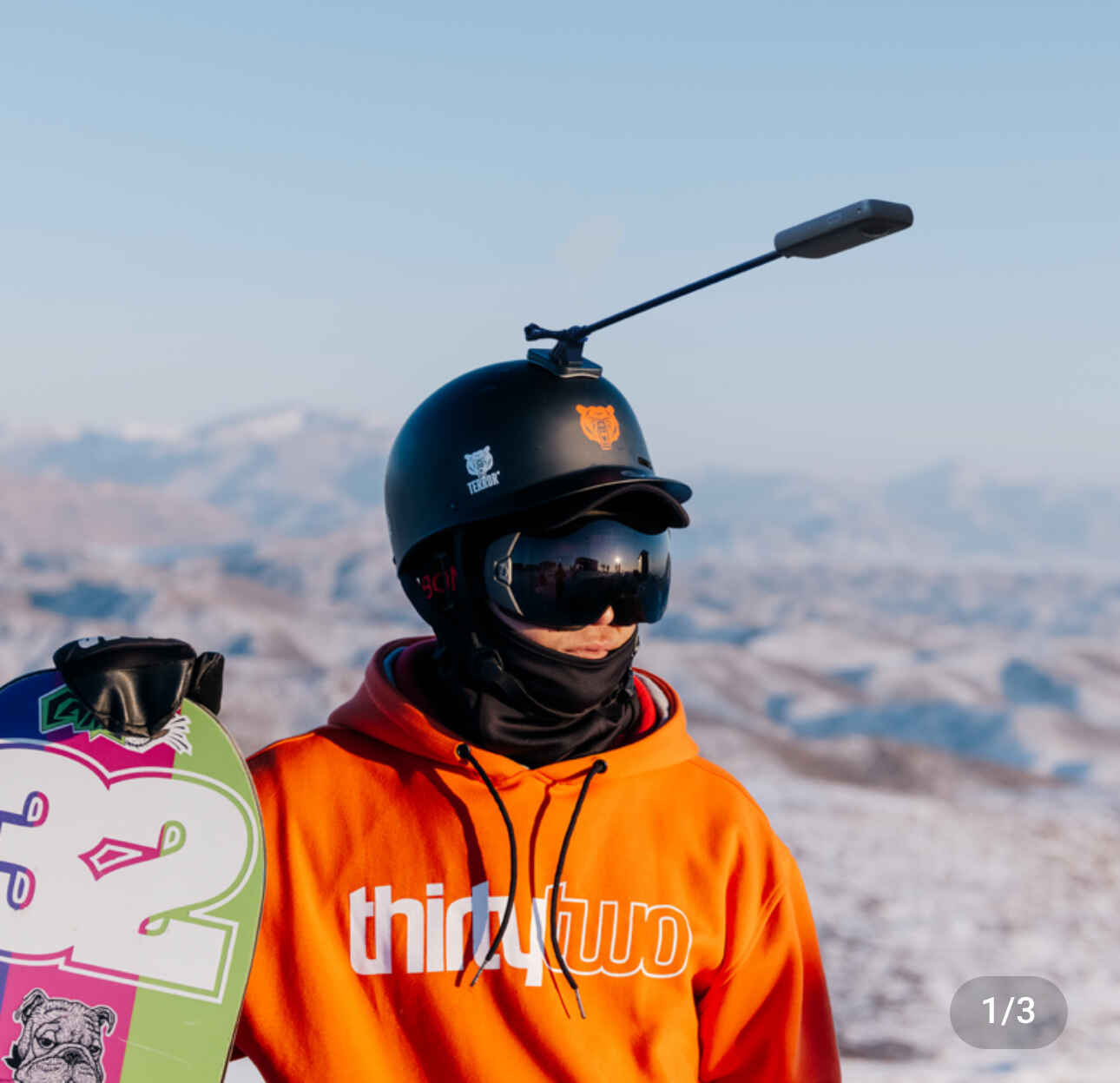

Another thought… to use a 360 effectively, you will need a ā€œunicornā€ mount which elevates the camera and the post supporting it is in the blind spot. Otherwise, half your footage is helmet.
Its goofy and you will be noticed so if you are achingly shy and introverted, expect ā€œhey what’s that?ā€

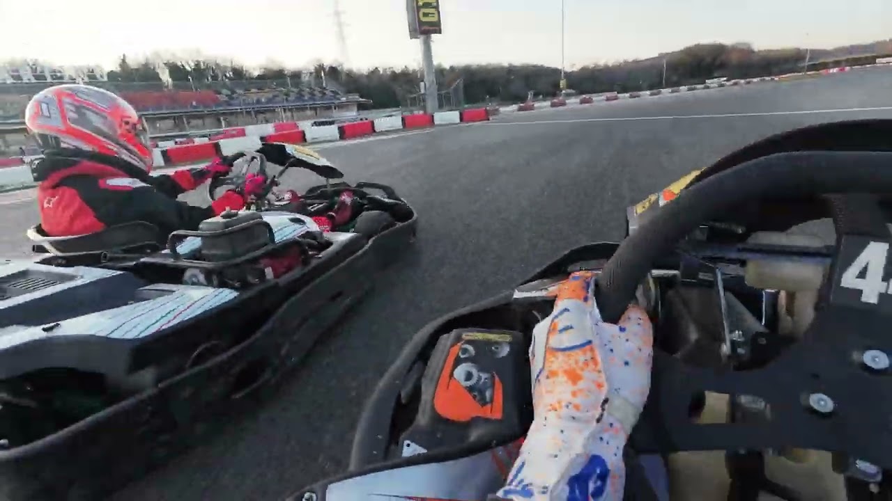

Here are a few videos with the Djo Osmo Action 4
Yea I think 95% of the use I won’t need ā€œcoolā€ footage. I definitely don’t need additional work to load up videos to go back and watch them. I think for now I probably should just stick with a regular cam. I’ll research a bit more but right now I am kind of leaning towards the DJI Osmo 5.
