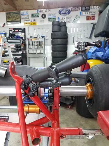

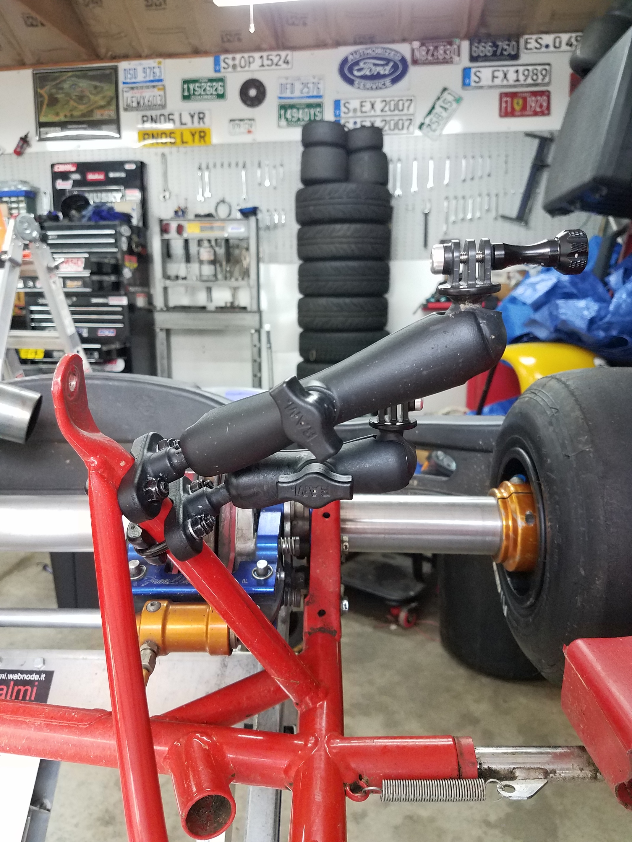

Here’s my solution, no major issues with vibration although maybe I should have done a mount with a longer reach (9inch instead of the 6) my arm takes up a lot of the Gopro view but it’s not terrible.
Here is video from it (the front and rear facing views):
https://www.instagram.com/p/Bj75Ag8BuEy
Start with this and mix and match 1 inch ball socket arms, etc!
https://www.amazon.com/gp/product/B0012TWRAO
