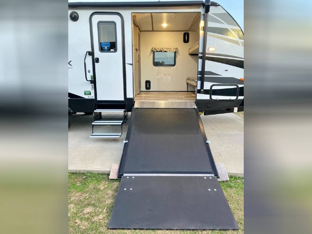

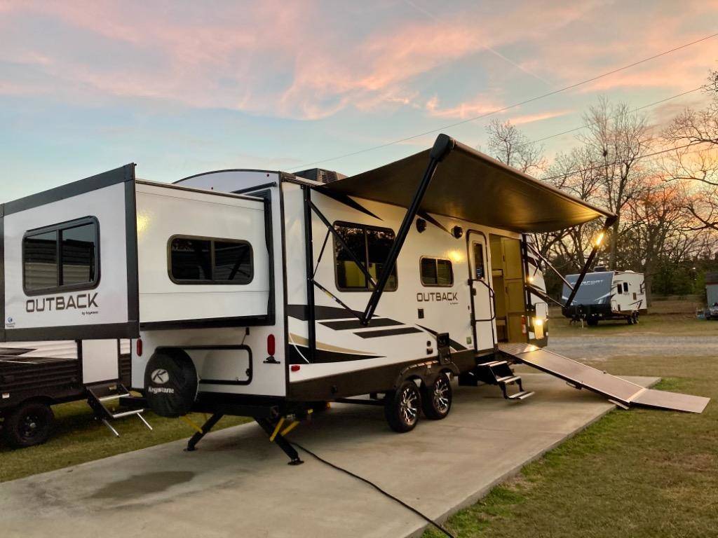

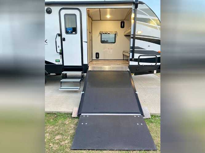

Here is one I’m considering, as it has the side entry which seems perfect size for a couple of karts. Bunk beds for the kids, separation fron the kids/ sleeping quarters. Plus it has the flat outside panels (no ribs) which is huge for Florida as moss loves to grow out here in crevices.

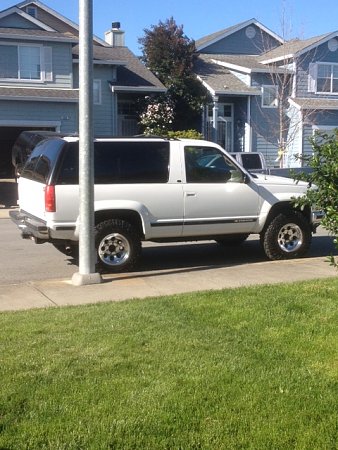

My only concern, I think its too heavy for a 1/2 ton truck? (1998 Chevy Tahoe)
https://www.rvtrader.com/listing/2021-Keystone-OUTBACK+240URS-5014943593
Any concerns with lingering fumes/odor from the karts? Specifically 2 strokes. I could bath in 110 but wife and kids not so much.
5400lbs empty. No way you can keep it under 6000 lbs when loaded (a tank of fresh water is 300+ lbs).
Unfortunately, you may need to upgrade trucks as it is very tough to keep toy haulers that light.

Isn’t the Tahoe more like 5000 pounds than 1/2. Ton towing capacity?

Though I will say, I would stay away from any toyhauler with a side ramp. Pits can be tight. You will always have to buy 2 spots if your ramp is on the side. Just my .02

You may be right. My Tahoe is the 2 door version with the even shorter wheelbase, so towing capacity is probably less than a normal one? Never owned any form of a trailer before, so I’m pretty new to all of this.
A part of me wants to upgrade my truck, but I’be had this rig for 20 years and it runs like a top. So I’d hate to part ways with it if I can find a light enough toy hauler to make it work. It old, but its paid for, and I still enjoy driving it. Plus I dropped in a new GM crate motor into it in 2017, but the trans is orginal and never been touched. Its lived a pretty easy life, never towed much, never off roaded. Its more or less a concrete cowboy.

As for that one with the side ramp, i immediately thought the same thing, with the way our pit stalls are setup, I’d never get the kart out the side.

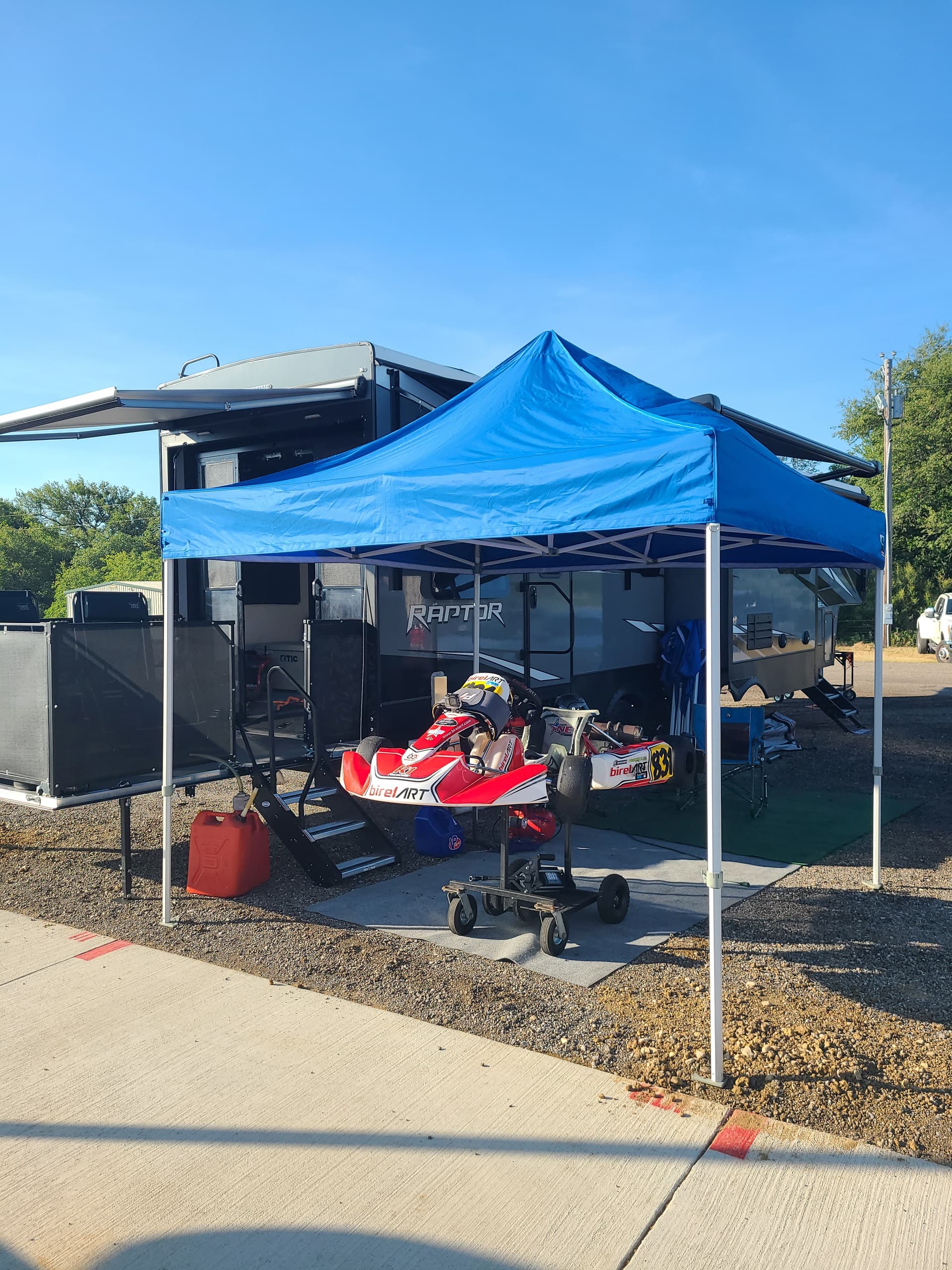

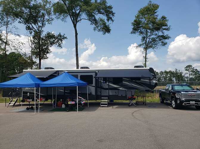

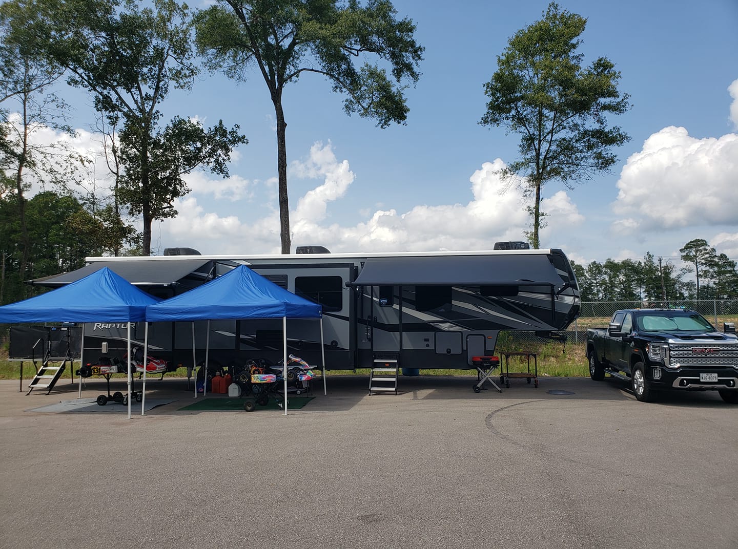

I have a 5th wheel toy hauler, and one of my requirements was that I had a separate garage in back so I didn’t have to worry about sharing space with the dining room. Being able to camp at the track has been wonderful, no need to pack quickly to get to the hotel, time to work on the kart, and I can get up and start working while I let the others sleep in some.

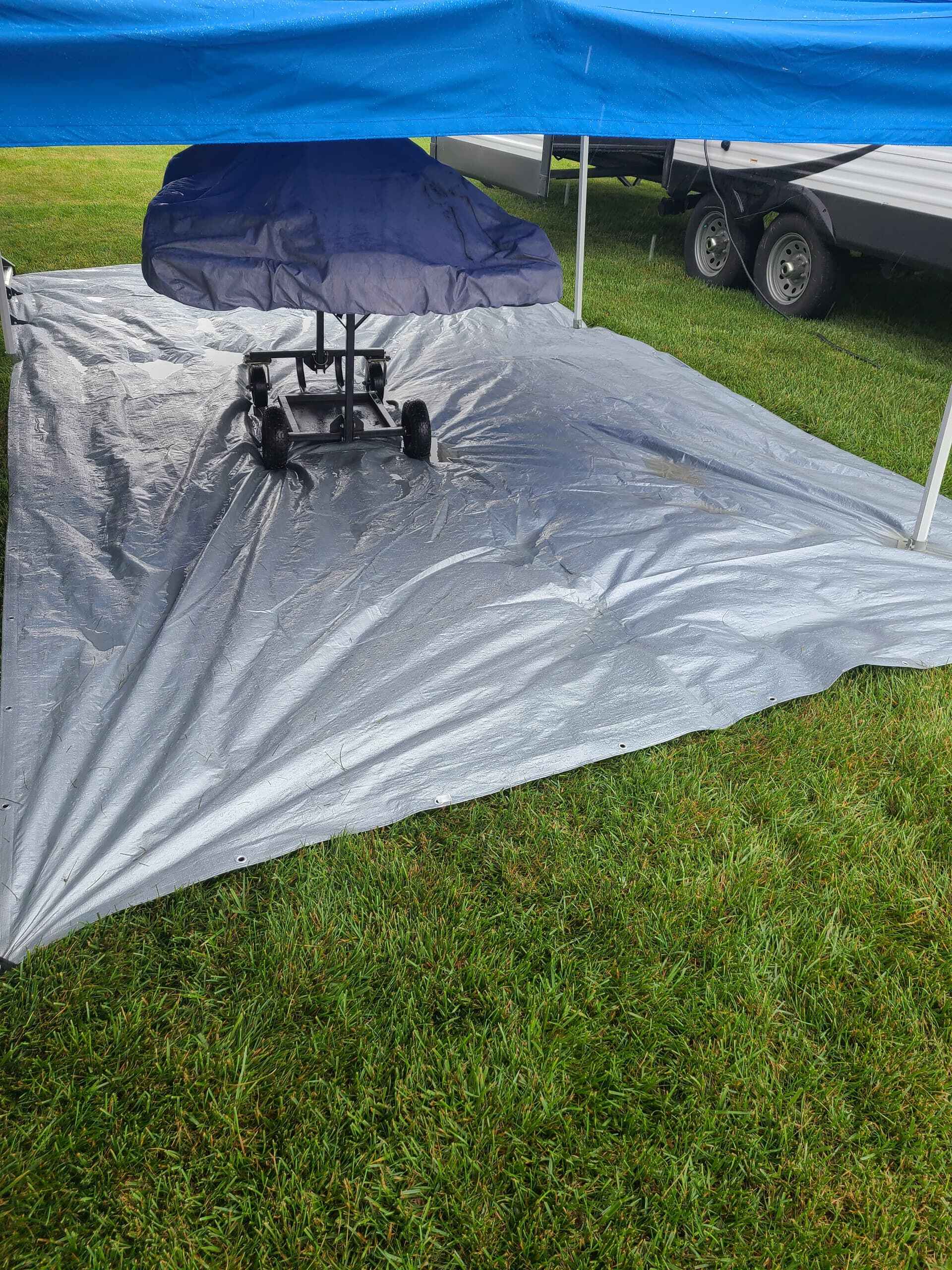

I typically setup my ezup outside and leave the karts under the canopy overnight. I do drop the canopy all the way down and cover the kart, and I have not had an issue with that. When it does rain, I push stuff inside the garage and leave it there if it’s not on a race day when we are going on track.
The only thing that has changed with having it versus the cargo trailer I had, is that I need to arrive at the track early so I can make sure I can get in and park in my space. I also need to take up 2 or more spaces depending on the size of them.
Here are some pictures of how I setup.
That’s a really slick setup, awesome.
