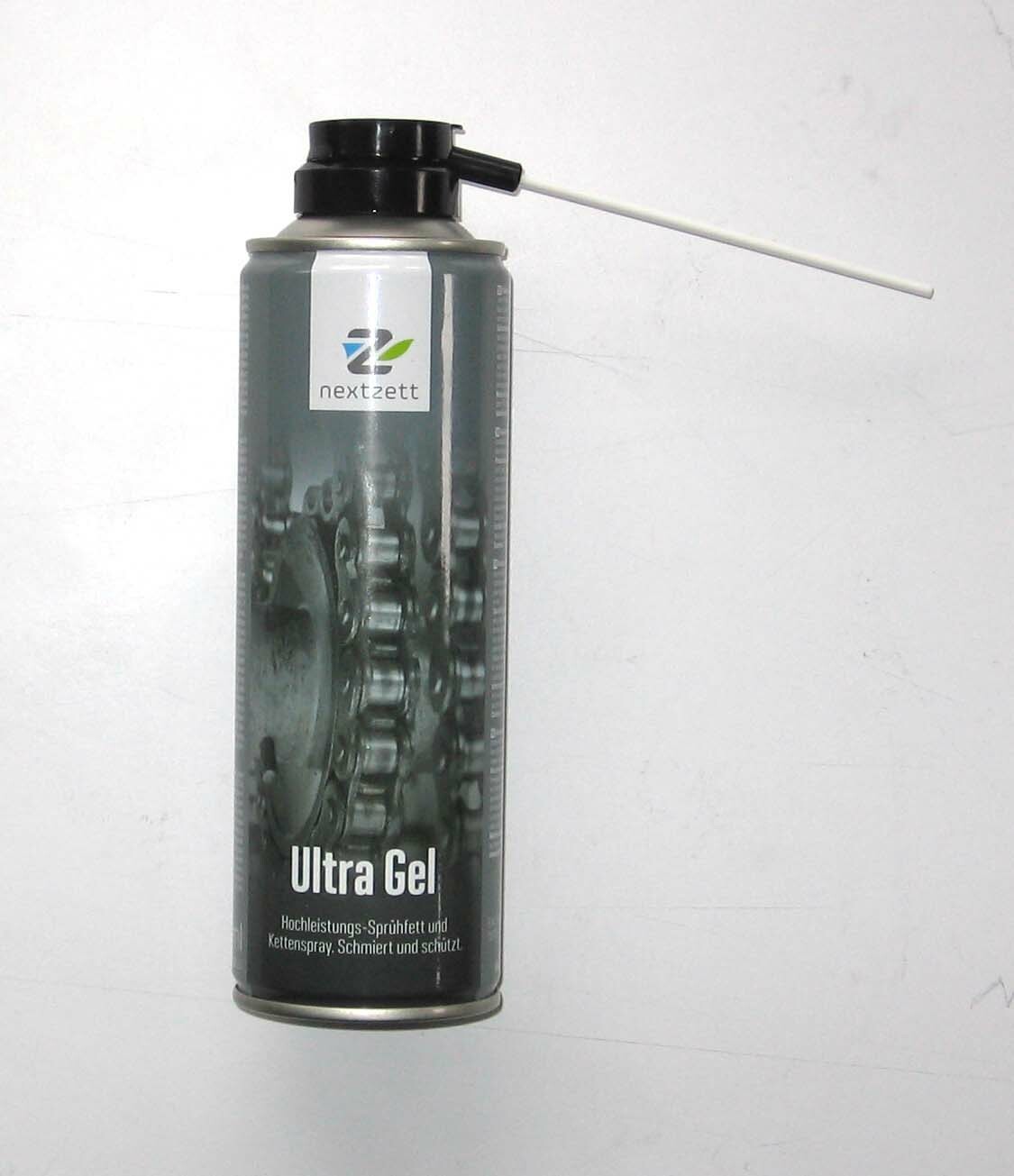

I started using Nextzett Ultra Gel this year and have found it to be fantastic!
