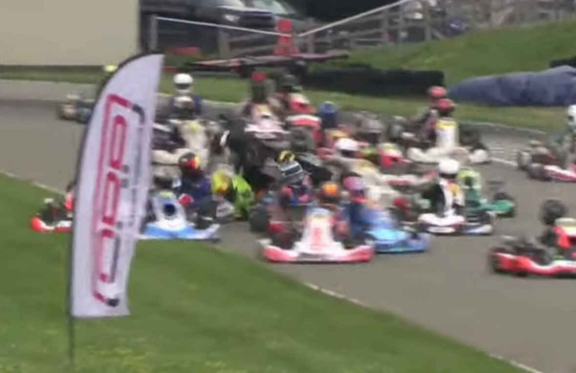

A third of the grid was on wets since it rained 20 mins before but it dried out very fast, there was also a huge pileup at t1.
